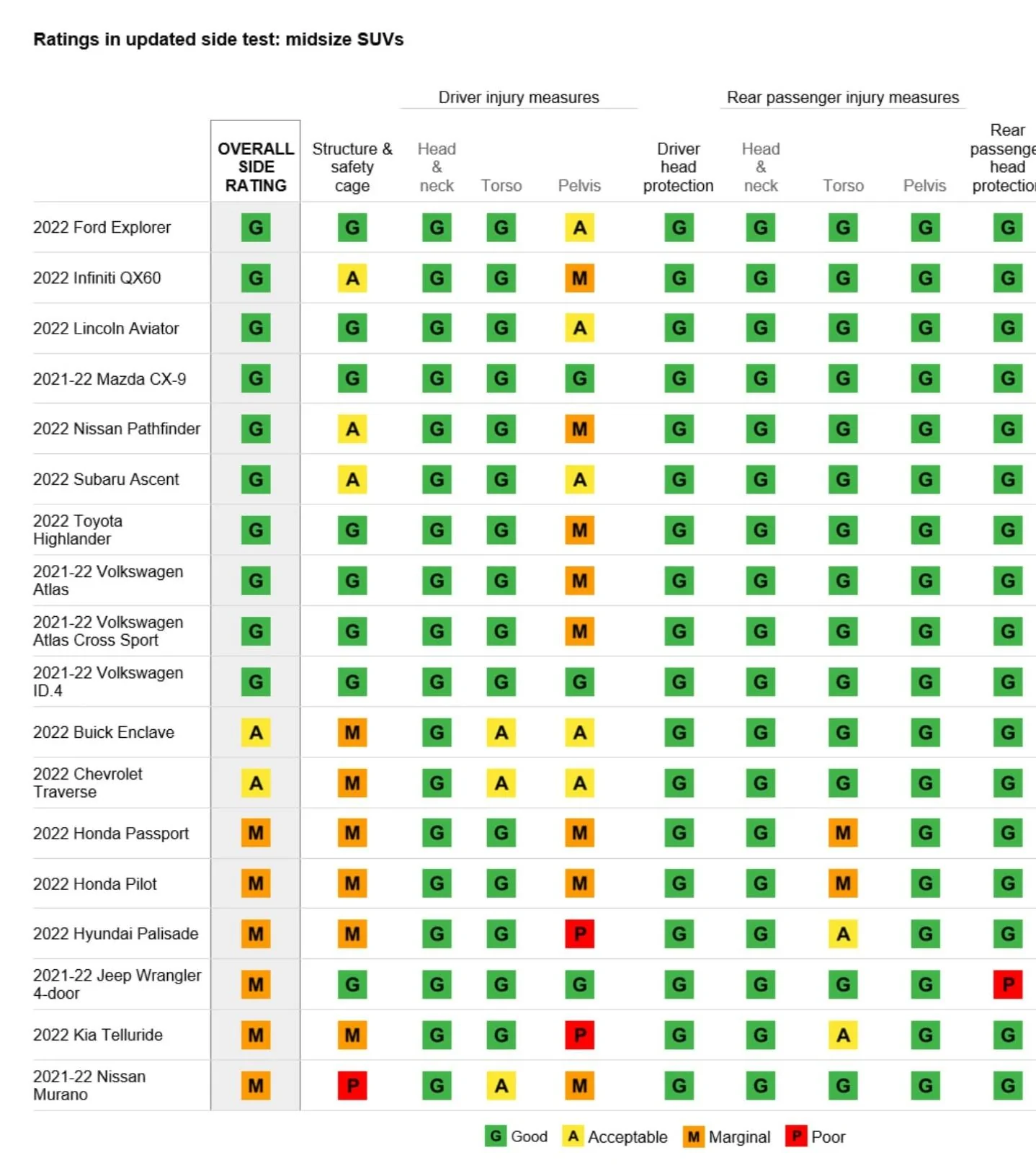

Are we all missing the part where head/neck injuries is rated "good" for front and rear? The video looks wicked for sure, but our marginal rating is due solely to the lack of the airbag, not the lack of safety. Given that we got a good rating in head/neck injuries, and in every single injury category, I think this is a less of a big deal than it seems. To get the good rating the others got for injuries, their videos must not be any better.
We simply automatically get poor for protection, because there's no airbag there. We received the same "good" rating for injuries as all the others in the class in rear passenger head/neck.
Look at all the others, with marginal safety structures/cages, pelvis injuries, and torso injuries. The fact that the Jeep earned good across the board is great in my opinion.
Digging in to it more:
Driver with side protection
Jeep Gladiator Wicked rear passenger head impact!! Updated JL crash test. Where is the rear side curtain? 1653334430158
Passenger no side protection:
Jeep Gladiator Wicked rear passenger head impact!! Updated JL crash test. Where is the rear side curtain? 1653334474442
Good rating not withstanding (all midsize suvs got a good rating in head and neck), the wrangler performed dead last in terms of head protection for the passenger but first in terms of head protection from the driver. Even the tin can kia and hyundai had lower rear head injury scores (300) than the jeep.

I took the time to crawl through the small suv's ratings as well (which can be directly compared as the test parameters dont change) and 14 of the 20 small suv's also protected the rear passengers head better including the honda HRV and Mitsubishi which received Poor overall ratings.
The jeep isnt a death trap by any measure, if it wasnt i wouldnt have bought it. But objectively, the rear head protection is worse compared to most other vehicles in the class and even outside the class. Given the availability of the simple proven techonology of an airbag, there is no reason other than laziness or cost that we dont have rear airbags.
