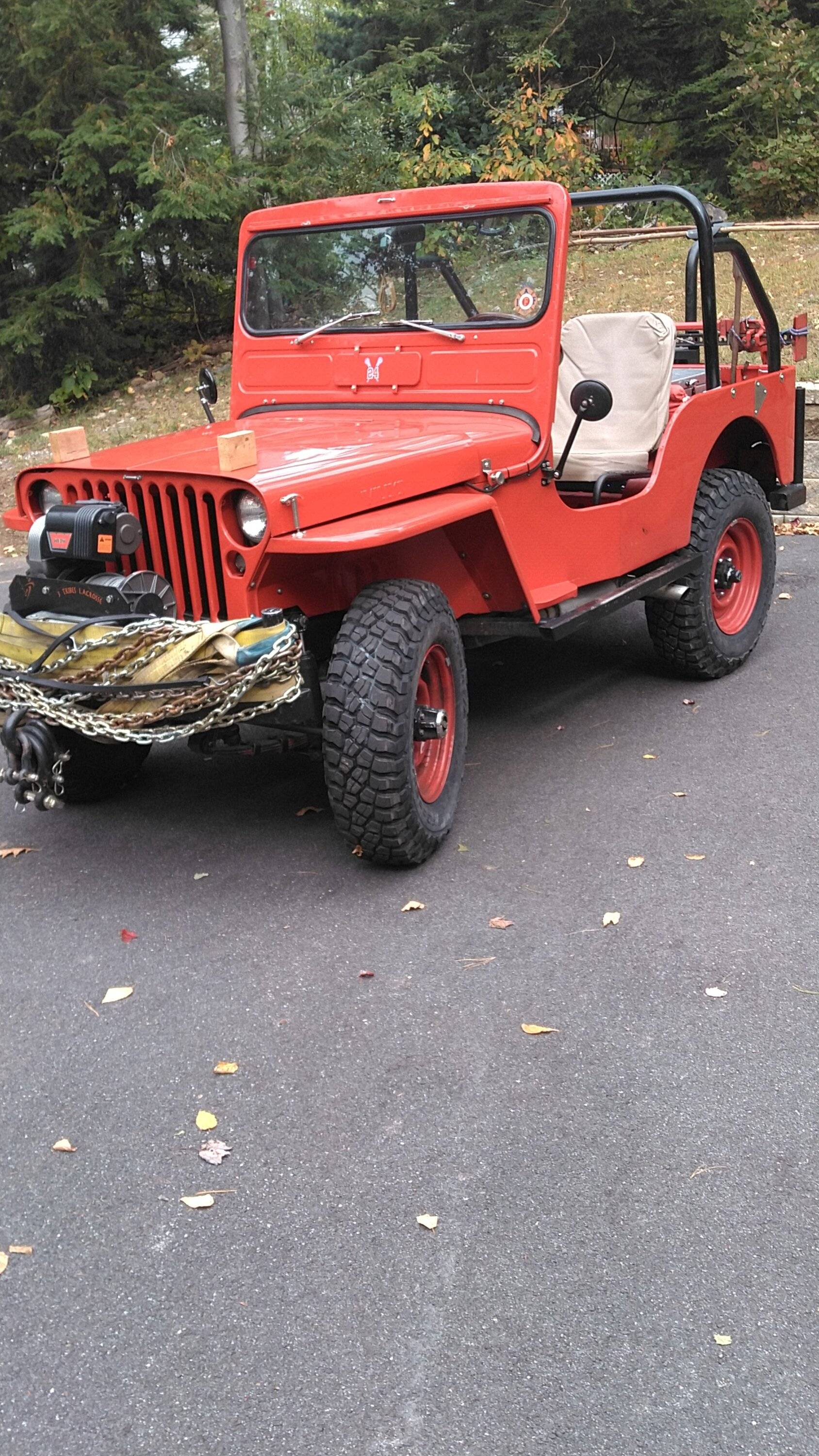

Skinny worked pretty good back then and still work pretty well today. The beautiful thing is those skinny-tired jeeps that helped win the big war ensured our freedoms to even have ALL the tire choices one could ever dream of to suit your wants & needs. Go skinny, go fat, go in between. ā€˜Merica!

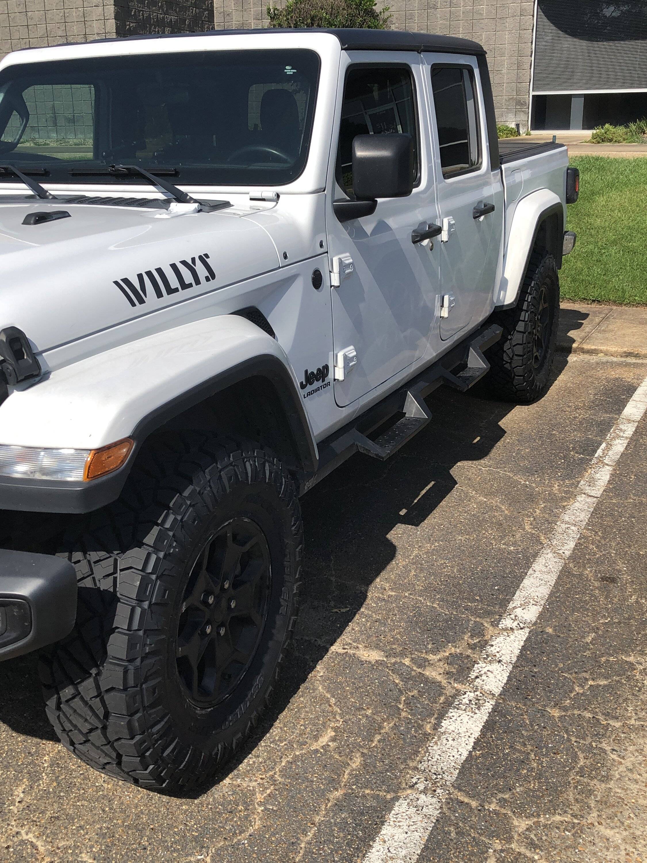

I'm a fan of stuff staying under the fender, which is why I went with the 35 x 11.5 Nitto Ridge Grapplers on the stock wheels. I use the JT for work and play, so I went with the less aggressive tire. I will say they make almost no road noise.
