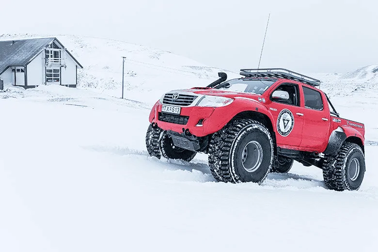

Which is why skinny tires work better in snow- they cut through the crud to the pavement.
Better for light snow. Heavy snow where you won't get through to the pavement you want a wide tire that will load up with snow.
Right, our "heavy" storms in the Mid Atlantic are over 6" so my frame of reference may be a bit... off. And it's more slushy than not.

Yeah, MTs really need to have sypes added to be the most effective in snow. I've had good luck with that in the Rockies, but will take an aggressive AT with great syping for better snow on snow grip (as you said) any day.

The side effect is being better in snow. It's why I don't go wider than I did.
