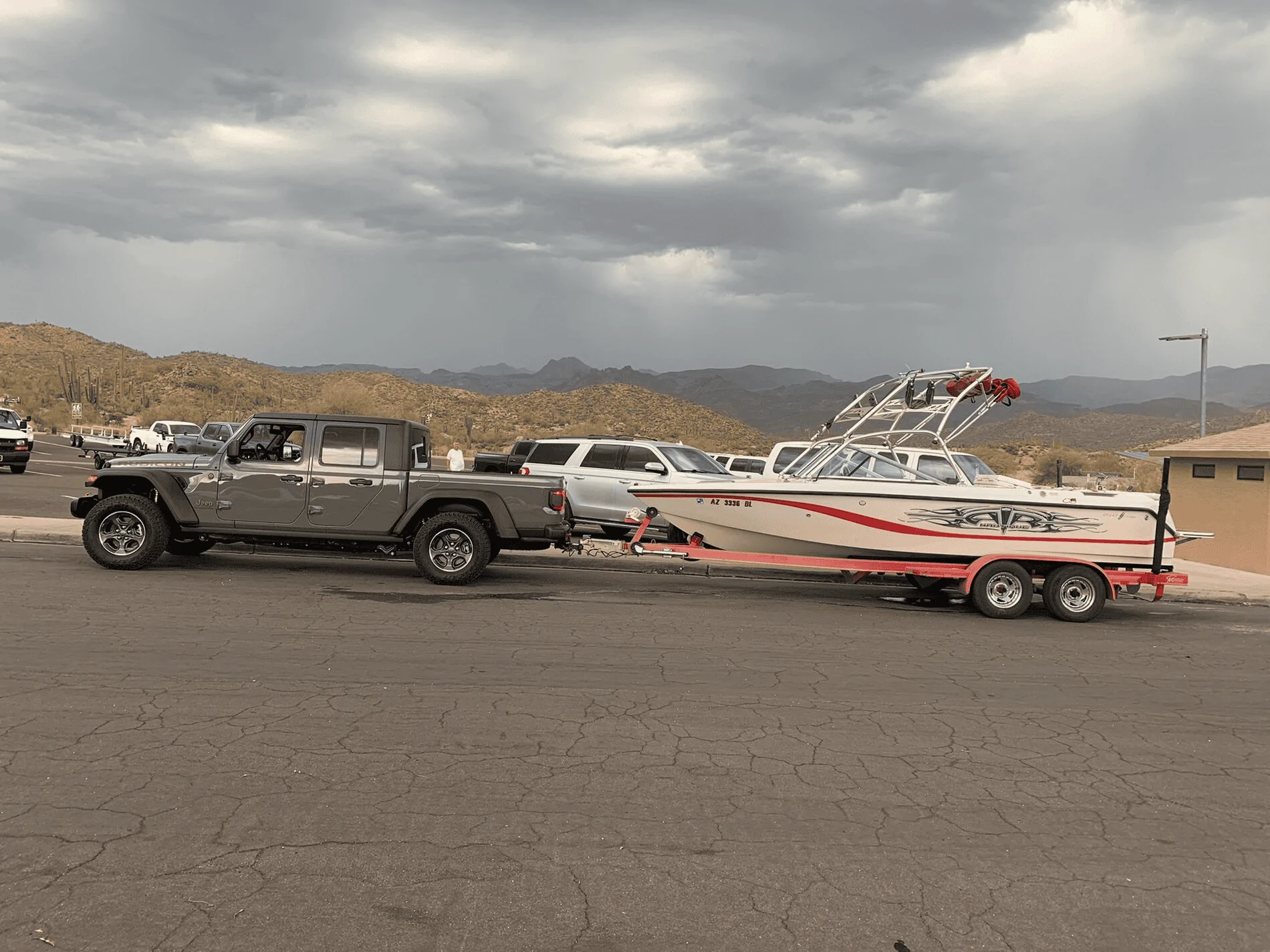

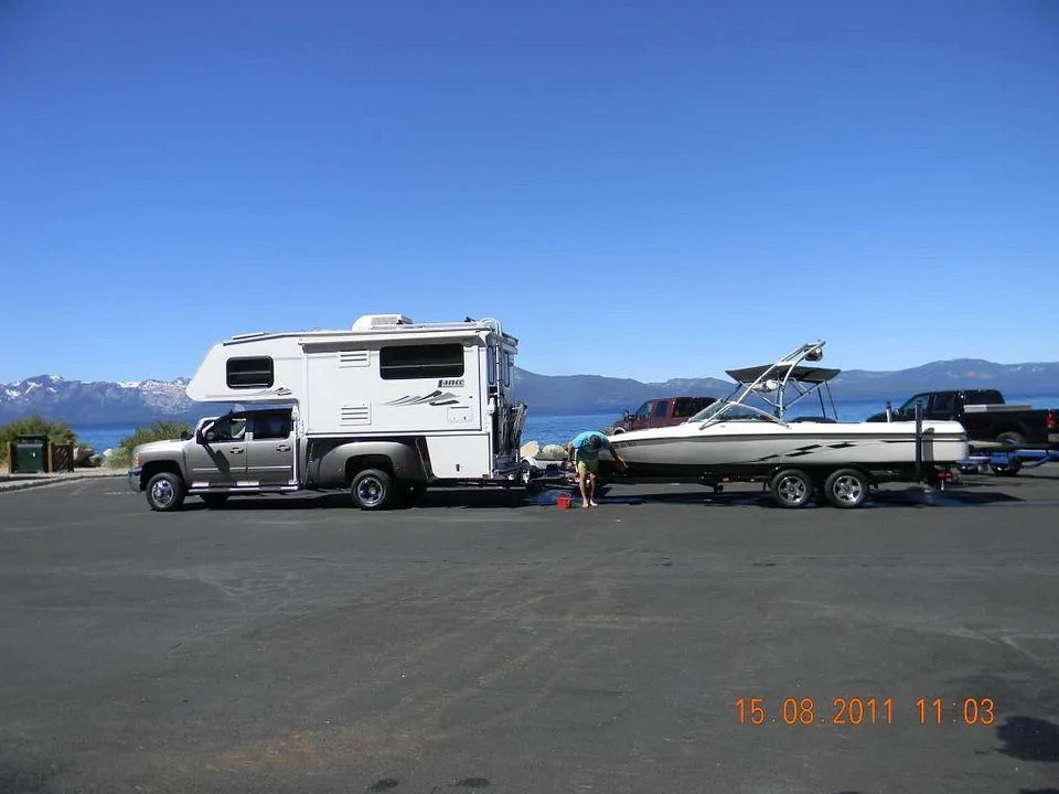

Wow, that's 6000 lbs? Are you fairly certain it's that heavy?
I ask because I own a 2003 Centurion 22ft wakeboard boat with a Chevy 350 in it on a Trailrite trailer and the information I have found online SEEMS to put them at a bit under 5000 lbs. Since my truck is a Rubicon the maximum tow rating is 7000 lbs. I'd prefer to be well under the max.
Here's my boat & trailer behind my old '08 Chevy 3500:
PS: My trailer has surge brakes only.
My Correct Craft SAN 210 in my original post picture weigh in 5,300 pounds on the tandem trailer. I bet your Centurion is similar in weight.

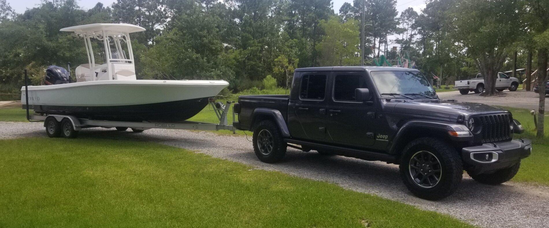

Definitely 6k lbs.
Boat with ttop and options I have is 4500.
Trailer is 1200.
Add batteries, tackle and other stuff that's right at 300 lbs.
Any time I tow I try to have very little fuel on board. That saves about 400 lbs.
So ya, very close to 6k
I will be towing to Florida next week so I'll see how it does on a few hundred mile trip.

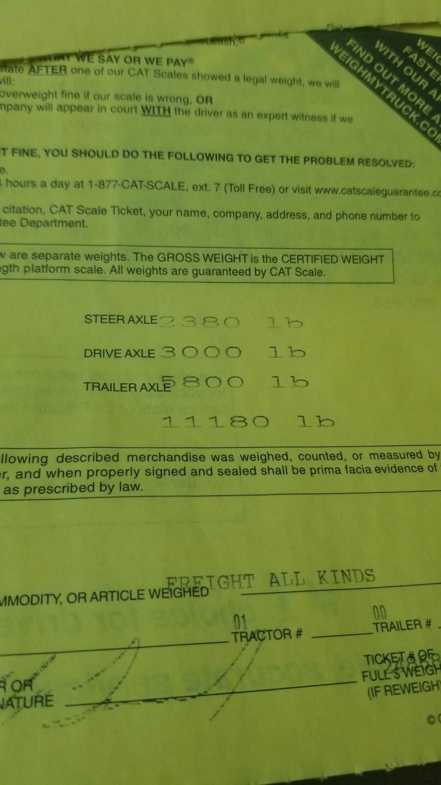

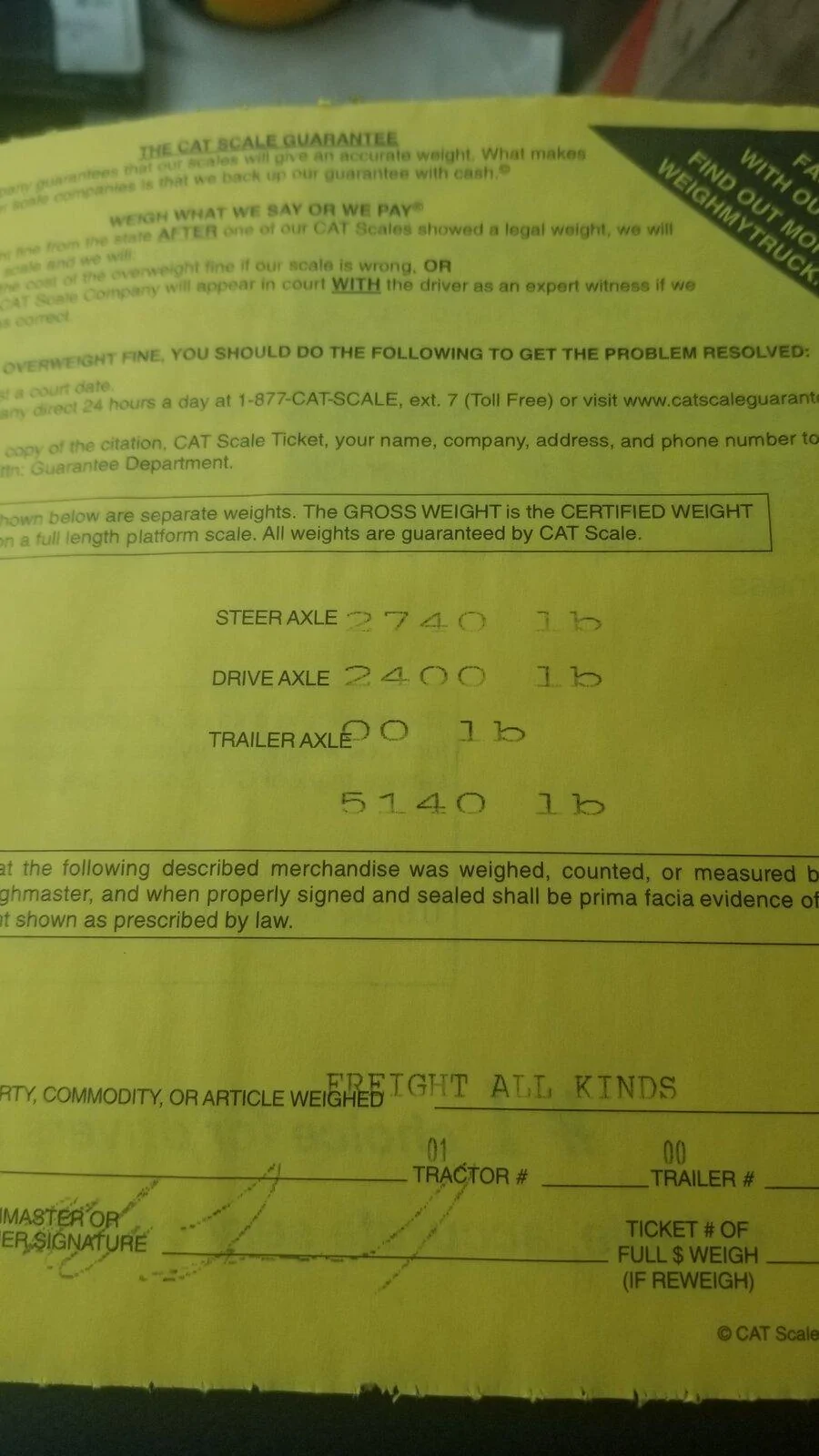

I bet it is pretty close to 5,500 pounds. My boat was fully gassed and geared up. I weighed it at a truck stop and then came back in my truck without the trailer and it wax 5,300. My Rubicon with the diesel tows it okay... You have to pay attention a lot more than I did with my old Ram 1500.

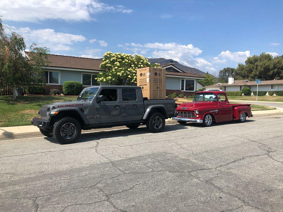

Who says Gladiators aren't trucks? Lol. Mine brought home this 22 cu. ft. refrigerator today.
I keep thinking it's the same size as older "full size" American pickups - Apparently not parked next to my '55. Yeah, the '55 is low and the Gladiator is high but it's still bigger overall and by a lot.
You should see a modern 150/1500 up against any that is 25 years old...

Hooked it up and drove to a scale to check the weight. Weight came back at 6040 lbs. That's about 1/4 tank of fuel in the boat.
