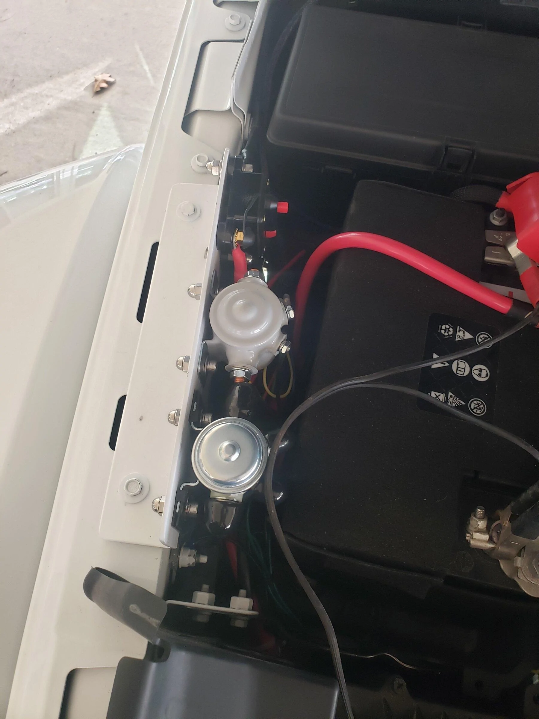

Have any of you found posts about where and how to mount this warn interrupt solenoid? I’m intending to use one of my aux switches for it instead of the included switch but that’s fairly straight forward. I’m mostly concerned with where to put the solenoid and how to attach it (bracket?)

Now that I installed it this way, I screwed myself for the ability to install a hood bungee. I guess for me the prop stick is fine.

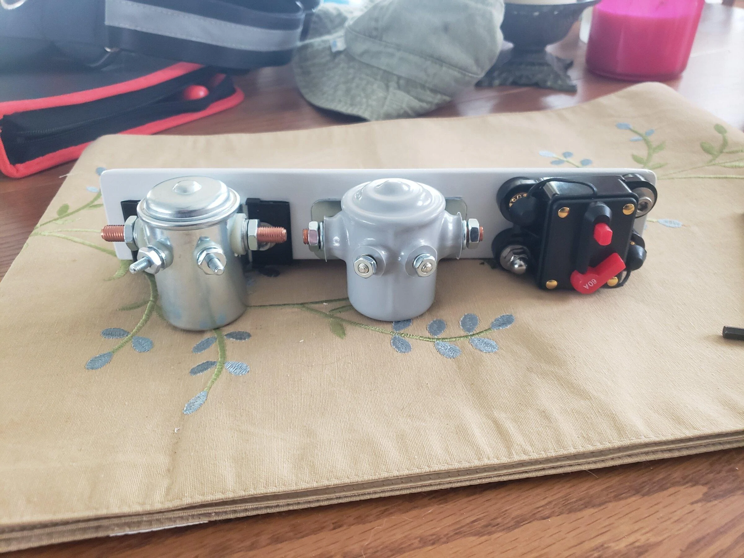

I think a breaker would be better than a solenoid. I too in the past have tried to find a quality one that can handle 450 amps just for surge. None found that suited what I looked for. But breakers on the other hand. There are cheap ones on amazon. other companies have higher quality ones as well. Just getting ready to install 2 80 amp ones, one for the compressor, one for the dc/dc charger. the are also smaller than a solenoid.
