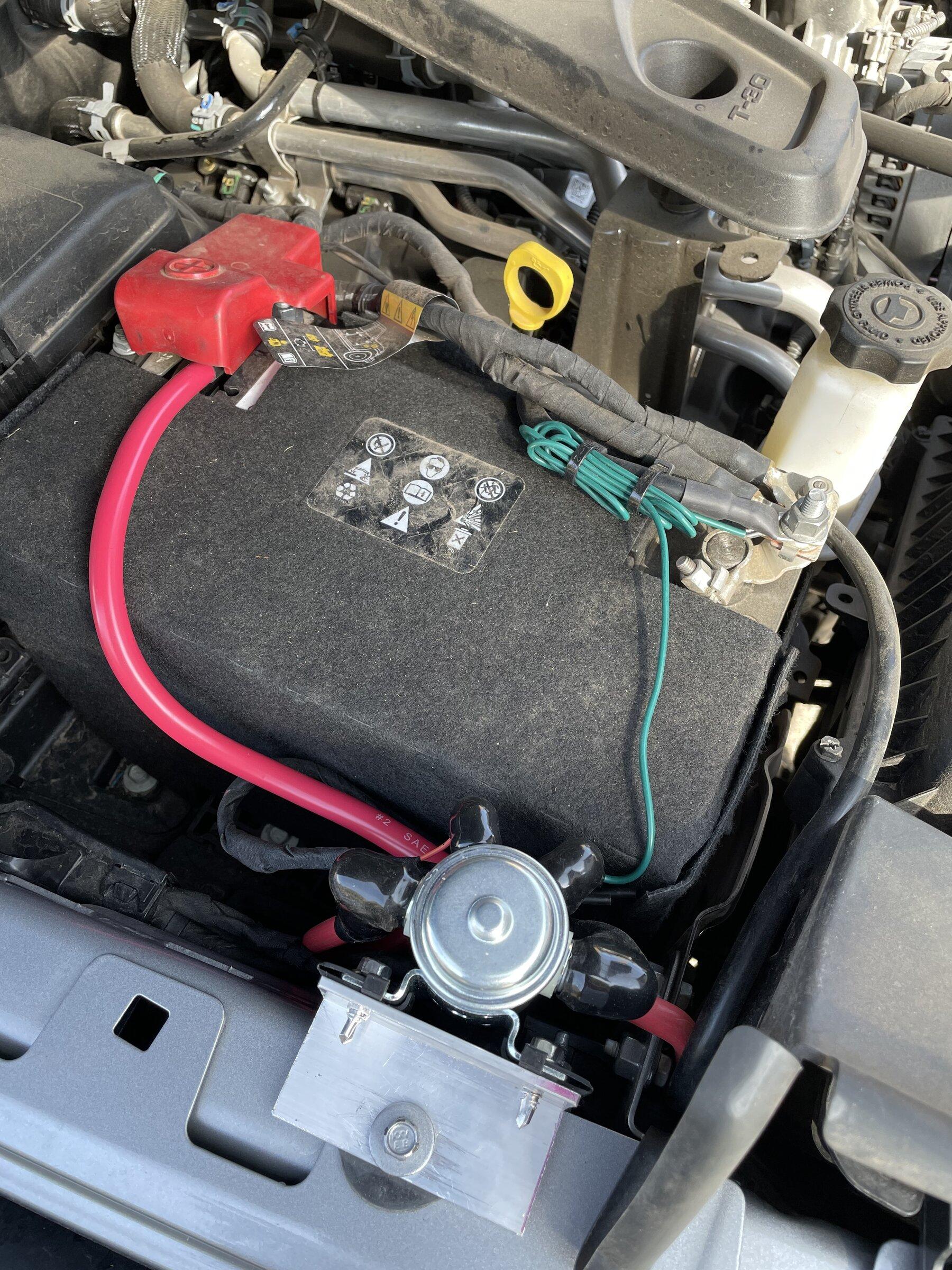

Have any of you found posts about where and how to mount this warn interrupt solenoid? I’m intending to use one of my aux switches for it instead of the included switch but that’s fairly straight forward. I’m mostly concerned with where to put the solenoid and how to attach it (bracket?)
I installed similar to @Lost1wing and also used an aux switch (4) for mine. I used some aluminum angle iron and large rubber washers to avoid paint scratching. It works perfectly, and the Warn model is rated for winch amp draw. Wire routing has since been cleaned up from how this was. This was five mins after install.
Thank you for the photo & info, the additional perspective is helpful.

I used what came with the winch. (pic below)
That looks like it would fit where I have my manual cut-off now.
Since the new one will have aux switches, I had considered using one of those for a solenoid but am leery of too many of the solenoids I've seen. I have not checked with my supplier of auto electric stuff if they have a solenoid rated high enough.
What does Warn actually rate theirs - and duty cycle? Do they publish their actual rating - and not just surge or momentary?
Be wary of those you see on eBay and Amazon - when it says "350 amps" that is almost always surge and constant draw is a fraction of that.
We wary of those you see on eBay and Amazon - when it says "350 amps" that is almost always surge and constant draw is a fraction of that.
That’s why I bought the one from Warn, as it’s designed for continuous draw from a 12k winch. I’ve used my winch around a dozen times now for real recoveries, and have yet to have an issue. I totally agree that saving $40 by getting something not designed for this is asking for trouble. It was always on my list to prime and paint the angle iron, but with billet silver paint not contrasting much, and the fact that the raw aluminum isn’t touching anything but the bolt, it hasn’t been a priority. And it’s under the hood, so only I see it. I still may do it someday though.
I know some of the aux switches are higher amperage (40 vs 15?), than others, but for this application, we only need the low amperage location since this is acting like a relay... right?
Correct. You’re just activating the relay, so you need almost no power.
From a safety standpoint, when consideing a cheaper disconnect solution, remember that there will be situations where you need someone to pull winch line for you, when you’re in the vehicle in a compromised position, potentially unstable. The last thing you want is to need to open the hood and reach for a connection. It’s much safer to tell the person helping that you’ve put power to the winch, after pressing a button inside the cab.
Thanks, yeah I’ve been in one of those situations in a ‘13 JKUR I used to have. I strongly believe the winch needs to be able to be turned on from inside the cab.
