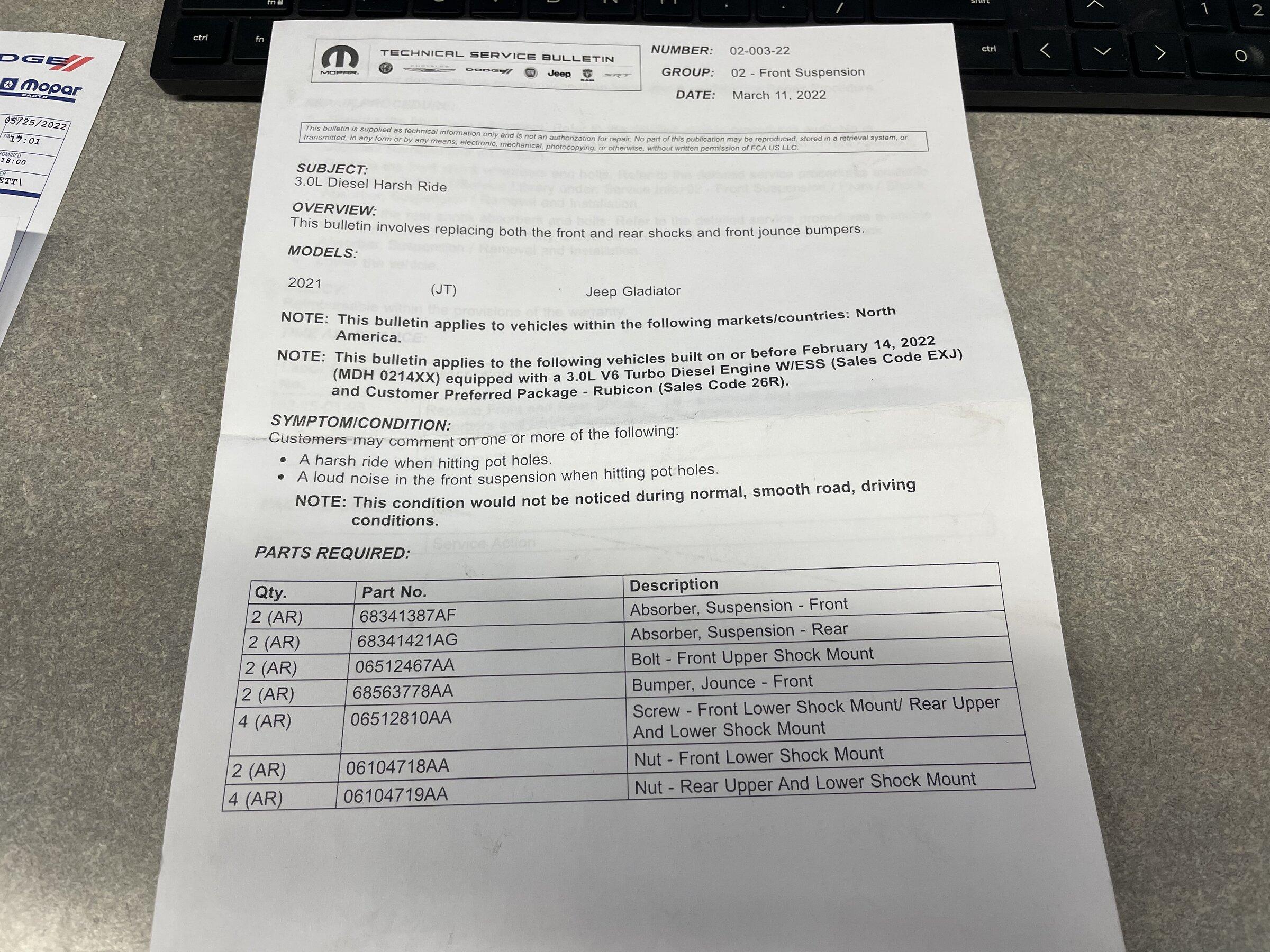

Can you tell me what part numbers they used? I’m a parts manager and I try to order the numbers off the TSB daily, it always says they are not available yet.
Synctheship
Jul 18, 2021
62
48
21 JTRD
Jeep Gladiator Your stock Rubicon diesel JT bottoming out? Here’s the fix!! photo_2022-05-25_20-01-05

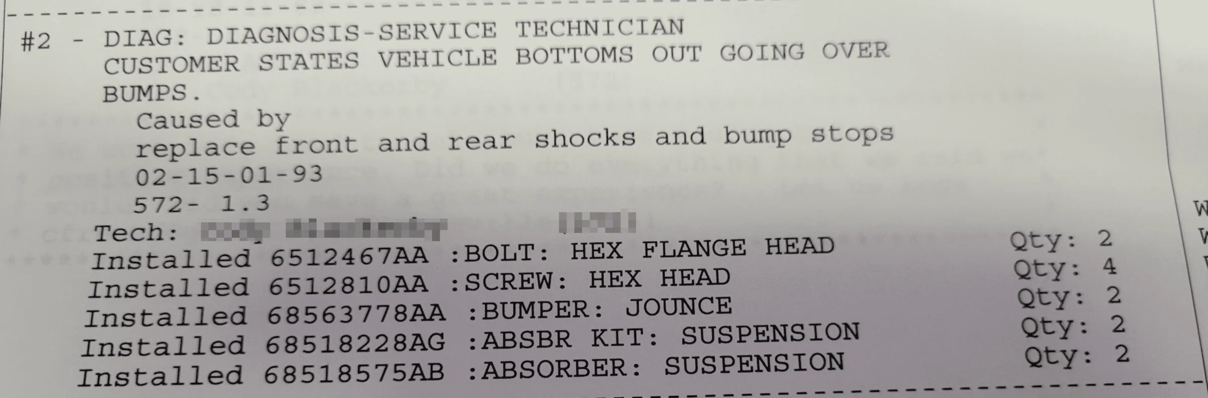

These are the parts that were supposedly installed. If they don't work out for you let me know and I may be able to crawl under there this weekend.
Also I did some short testing tonight, definitely an improvement. It's no Mojave by any means but I'm happy to consider this issue resolved. Speed bumps that I couldn't take at 5mph without harsh bottoming out are now good at 15mph. Huge dips (v-shaped) that I'd harshly bottom out at 2-3mph before are good at the 8-10mph range. And now frame bottom outs are much softer, you can feel them but it doesn't feel like metal on metal now.
If I wanted better I'd probably have to lift it as it looks like I still only have around 3" of up travel (I'll measure over the weekend). But I'm trying to enjoy the truck in it's stock form for a few years.
Probably worst case scenario for front end weight. JTRD Stock with metal rubi bumper(with wings), winch plate & 10k winch (synthetic line).
EDIT: Also not sure if it matters or if my dealer did something special, these parts were initially ordered 8 weeks ago. I got the call on 5/20 that the final part came in and scheduled the install.

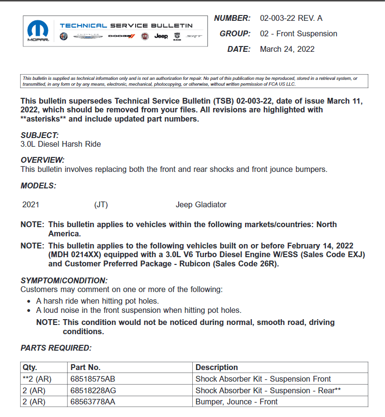

looks like they revised the TSB. I’ve had the original on my desk for 2 months. I guess that explains why I haven’t been able to order them. ??‍♂

TSB has been revised. Just shocks and bump stop now
