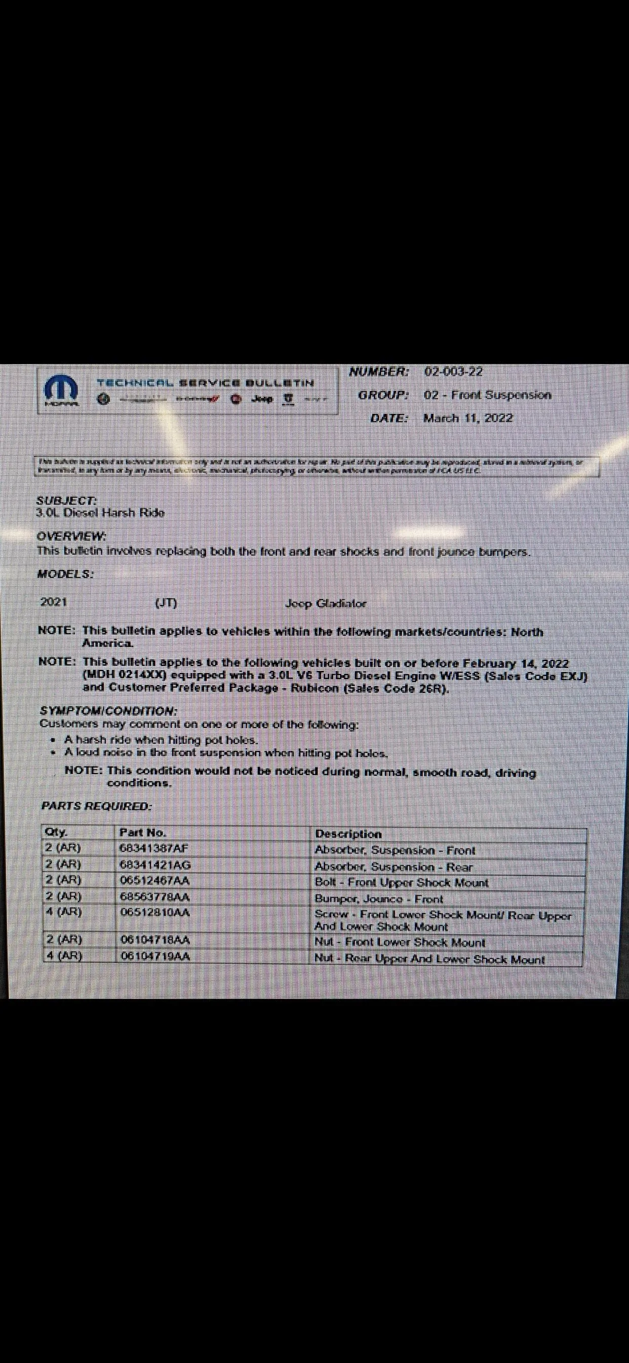

Benny - can you please confirm the part numbers are correct/incorrect for a Rubicon for the revised TSB. My dealer is saying the parts listed are for a sport and are non-fox shocks.
Front Shocks - 68518575AB
Rear Shocks - 6851822AG
Thanks!
Hi Shawn,
The fronts are Fox shocks with a "performance" sales code. The rears do not appears to be a valid # though.
If you need me to validate any numbers from a TSB send me your VIN or the TSB# and I will look it up.
- Benny

So my dealer just tried to tell me this does not apply to my gladiator and said there was another TSB issued on march 24th a revised one? Anyone have this issue?
My build date is 2/17. And I have the updated parts. So If your build date is 2/14 or later. You have the new parts.
Mine is a January build. It looks like the rear shocks in the revised TSB are an invalid part number which is preventing it from going through. I reached out to @JeepCares to have them look into it and @AllMoparParts.com was kind enough to look into it and confirmed the rear shocks are invalid.

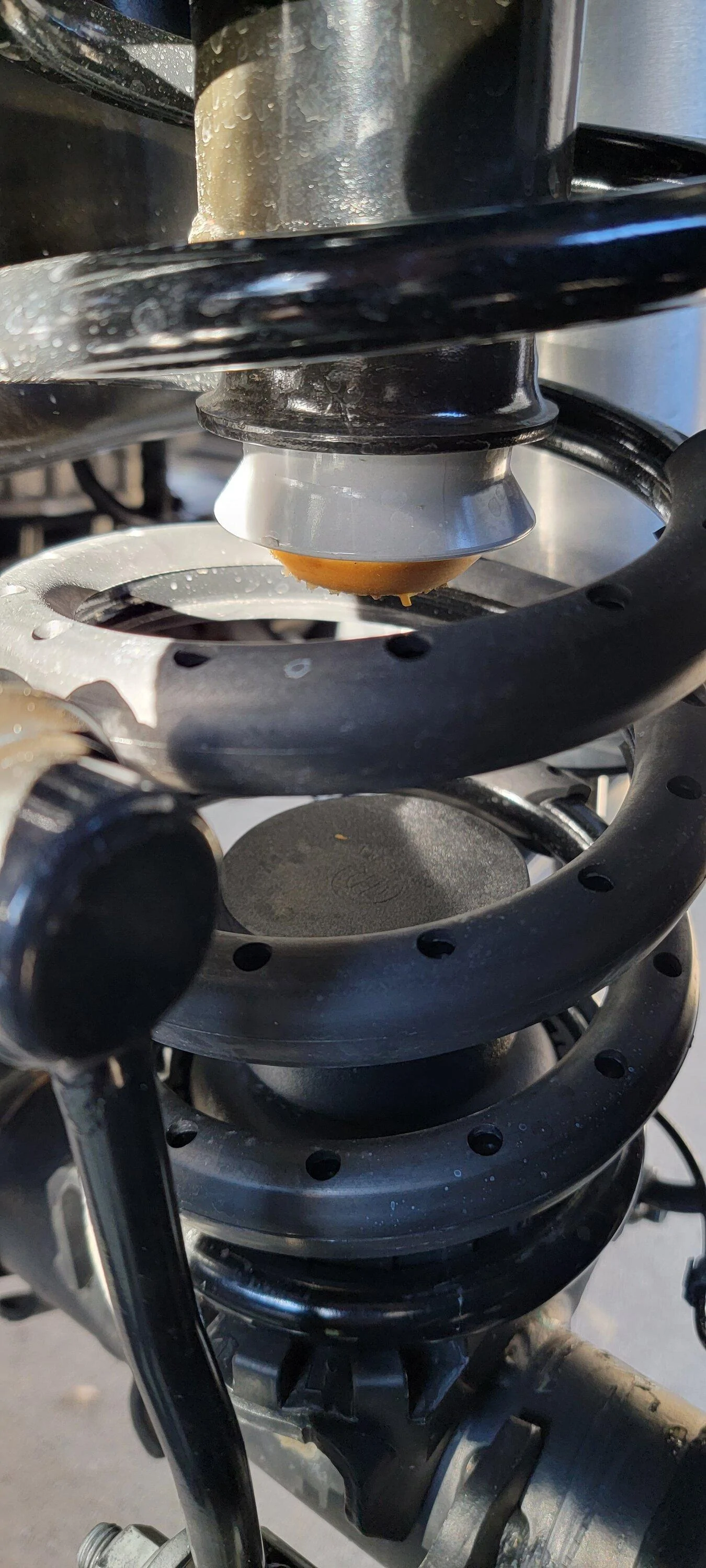

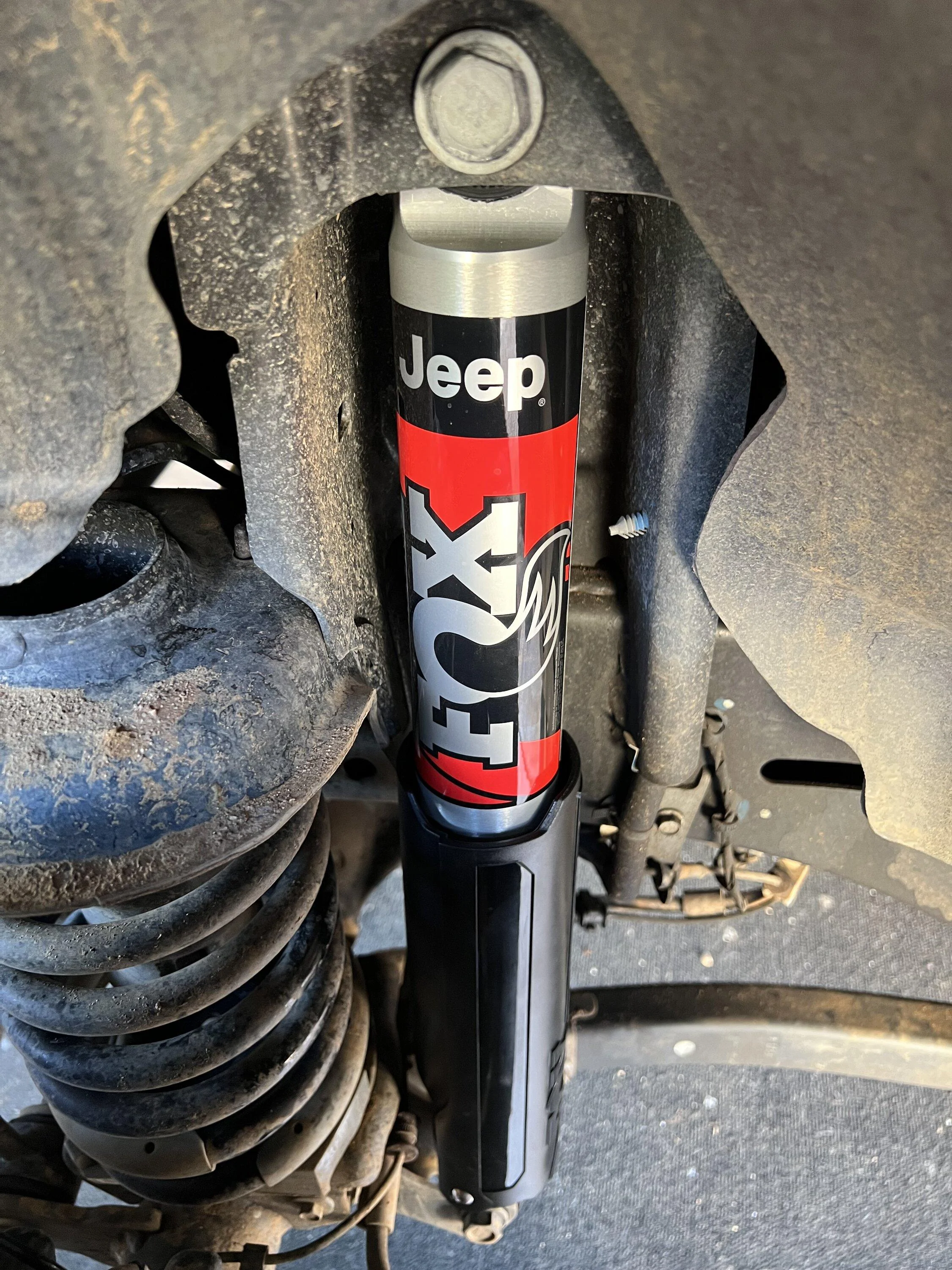

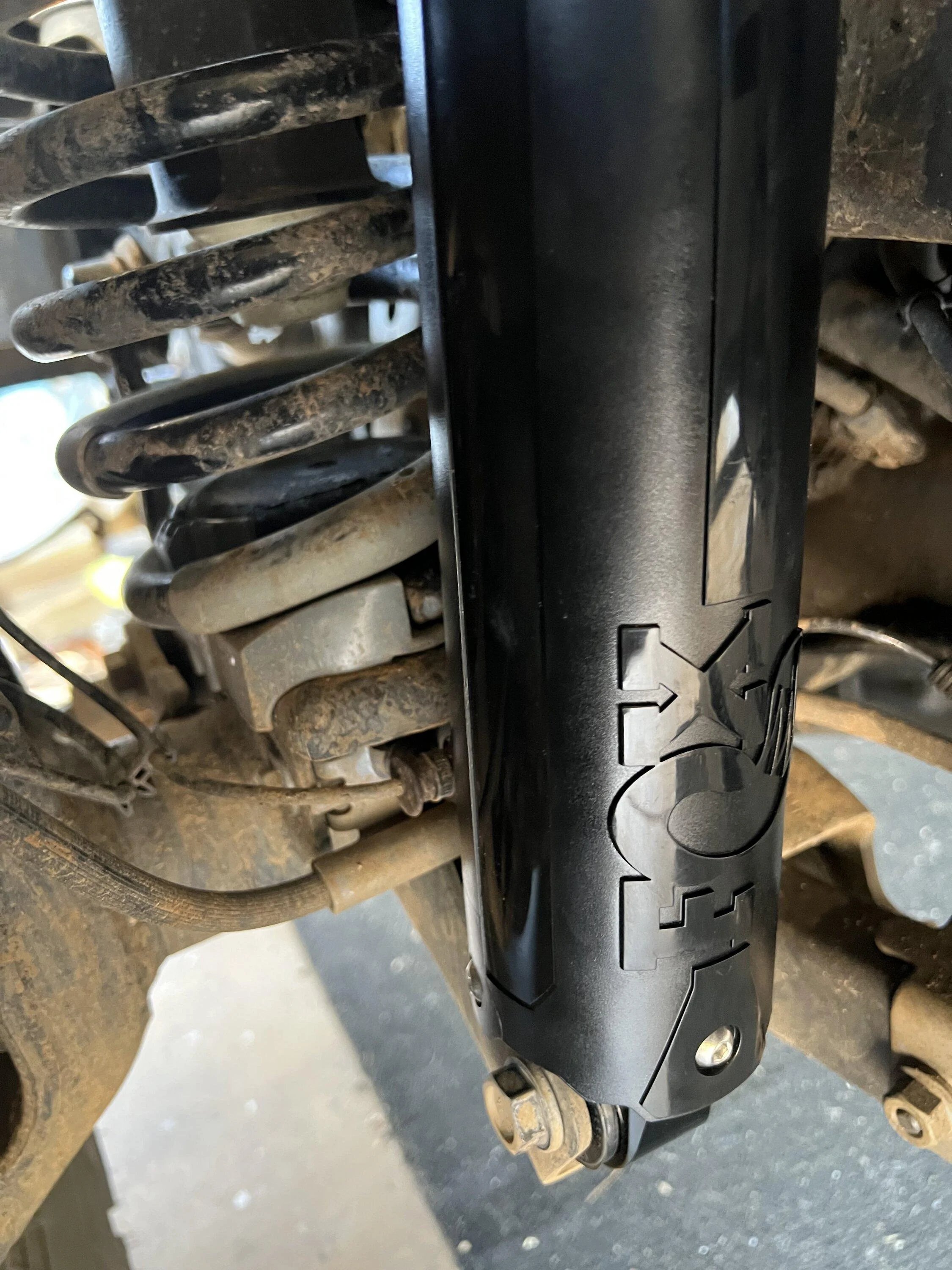

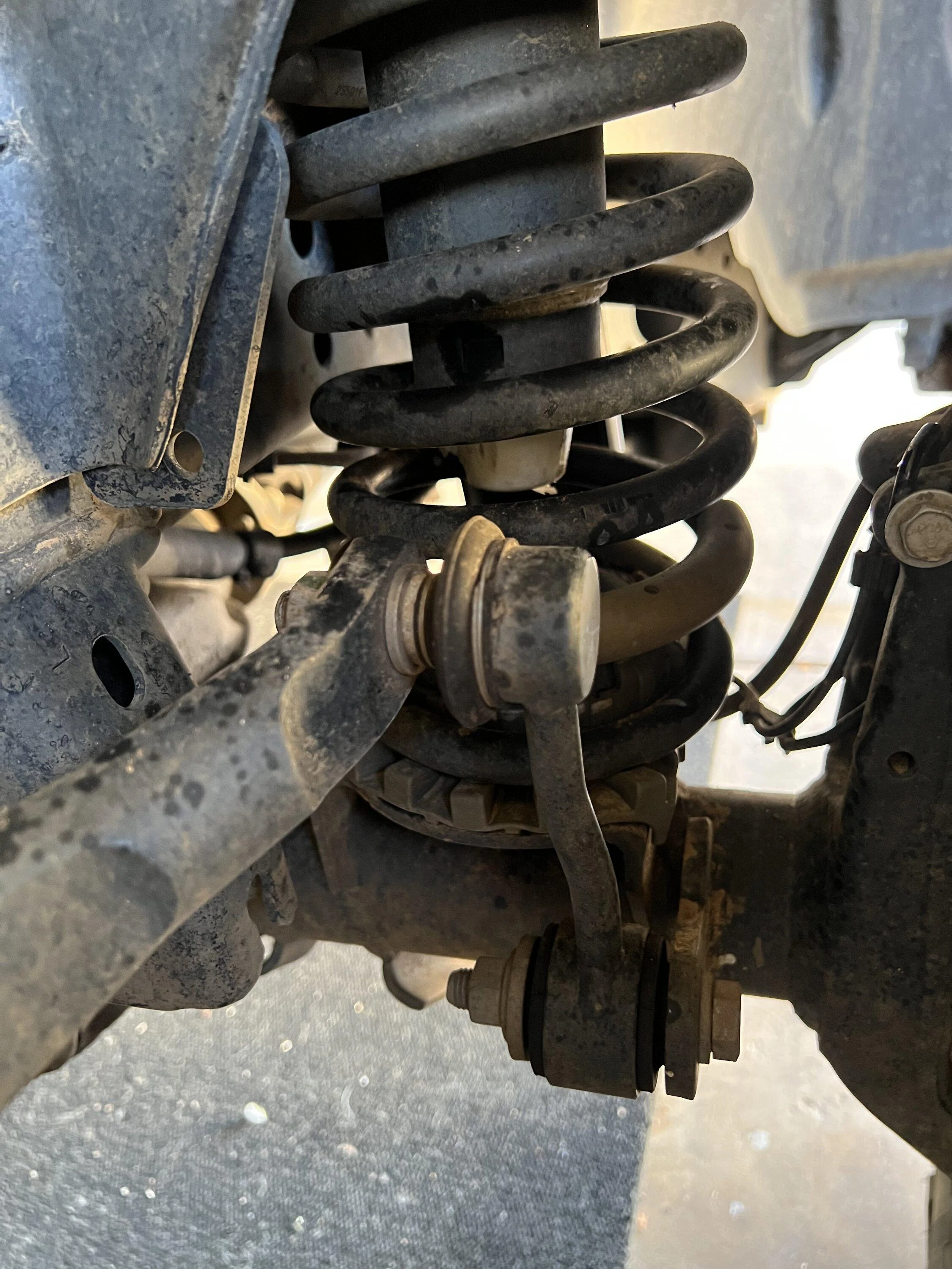

I just got mine back. They are Fox shocks. Here is my invoice and pictures of the shocks and jounces. It drives much, much more like a truck now. I could not get it to bottom out, but the ride is much, much stiff now. Where it use to sway in the tight turns, the body now sits level through tight turns. Ride is now stiff, but a definite improvement in my opinion.

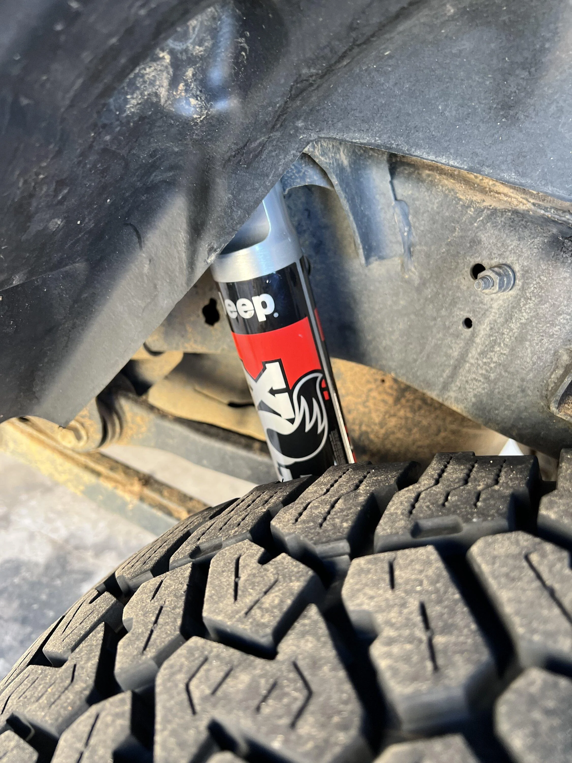

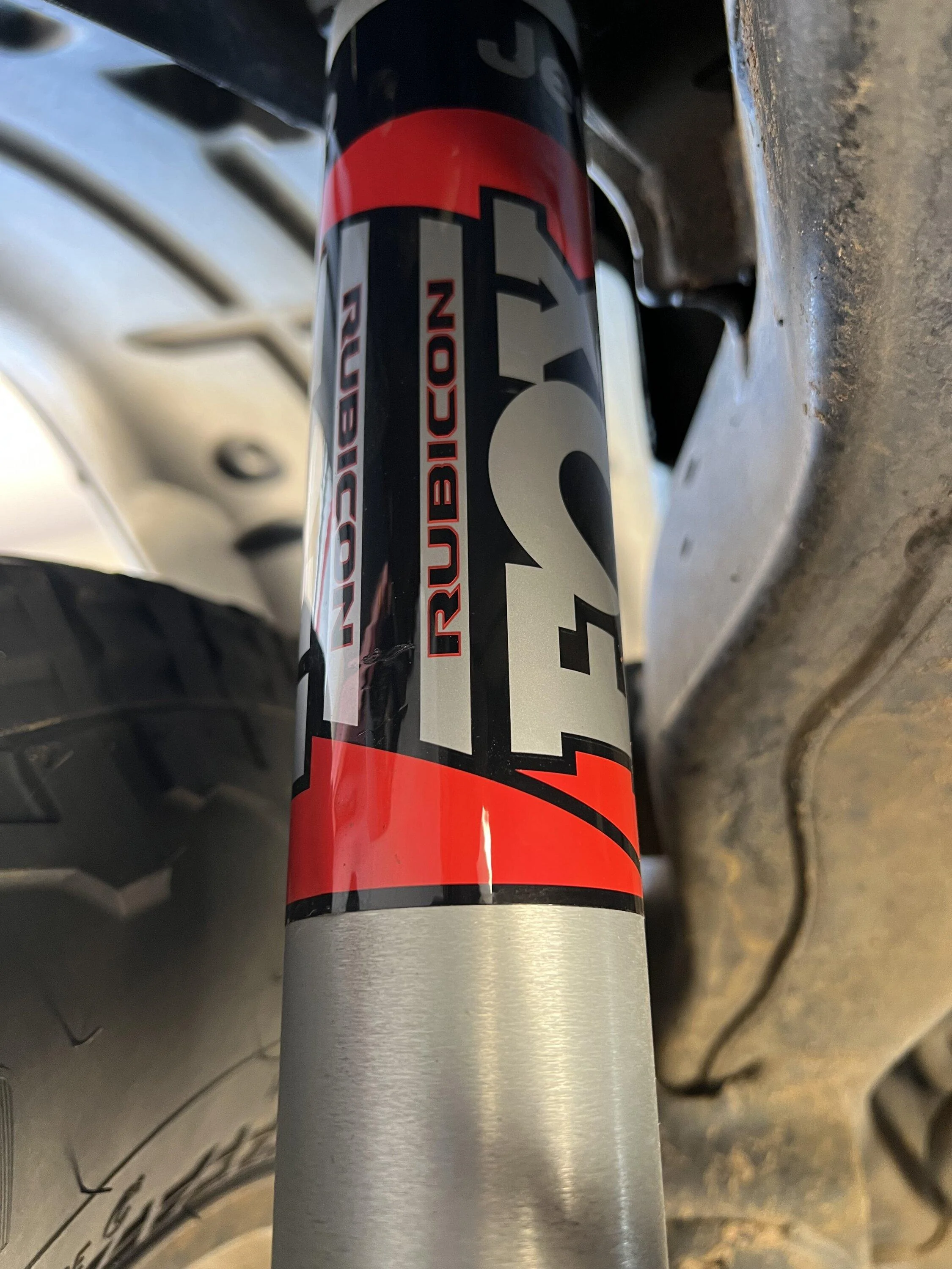

Here are the rears.. The shocks have stickers on them (not put on very well) that say Rubicon...

Update. Per @JeepCares I'm now being told this TSB only applies to 2021 model year despite the TSB clearly stating vehicles built BEFORE February 14th. This is extremely frustrating to get the run around here when it's clearly outlined in the TSB and I meet all the requirements.
I have a feeling this is going to go nowhere and I will be SOL. Thanks Jeep.

After more driving today I am pretty impressed with the difference that just adding shocks and jounces made on the ride. It feels like a real truck now and it does not bottom out that I can tell. It use to make my teeth rattle when going over a speed bump or over a pothole.
