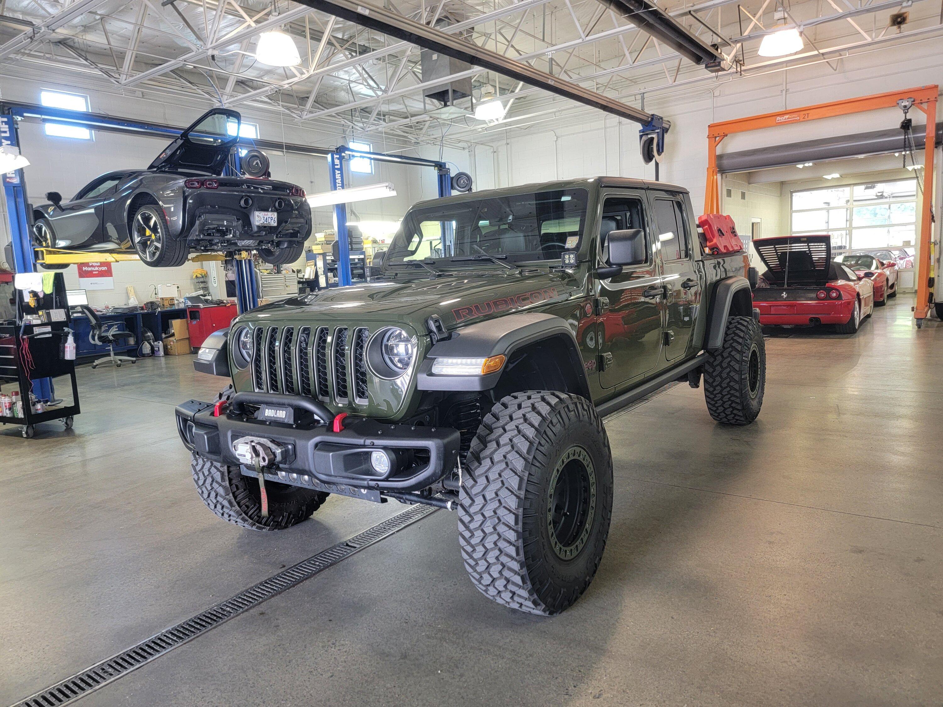

I did clayton 3.5" . Fixed the issue. Love the setup, but you can't just lift it and expect good drive quality. It drives better than stock now on 37s. Only after upgrading the tie rod, drag link, new stabilizers bar, driveshaft, and few other things. (Tires killed the comfort most before doing the other addons.)
I had 1.5inch teraflex spacers originally and it helped the issue but only by about 30-40%. I might throw them back on just to gain a bit more clearance from weight of the winch and mounting plate.

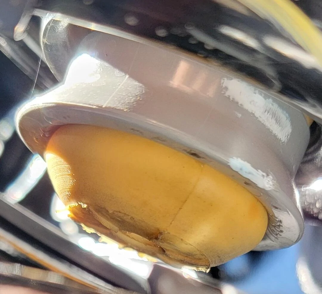

I could be wrong, but the guys that have had this problem appear to have a different bump stop than you (image cropped) and me. I've just started reading about this today, and I don't yet know if my 2022 Sport S Diesel is affected. Need to go find a speed bump tomorrow or something.
Nice ride for sure! Good Job.
A couple questions if you have a minute or 3. I’m on the fence between the 2.5 and 3.5. At any given time I may have to go down to Miami for work and a very high % of the parking garages were built so Oompa Loompa‘s would just miss bumping their heads. Well not quite that bad, but I caught myself just before pulling in one with a non-lifted 2008 Dodge 3/4 ton 4x4 (that’s 2500 for those still damp behind the ?) and taking the top 2-3” of my windshield up…off!
…so, if you you’d be so kind…what’s the height as it stands in the photo above? In a pinch, I have on board air so ultimately I could air down, but may run the risk of blowing a bead driving in circles on the concrete finding a parking place and I may not present well dripping wet from the humidity.
Also, the best I can tell in your photo, you appear to be running 9” KMC bead-locks with a negative offset. From the angle it looks like about 1/2 of the tire is poking. Is this an illusion? Can you post some “down the side shots” and specifics on the wheels for those of us (me) that are close to pulling the trigger and want to get it right the first time.
A big thanks in advance!!!

I could be wrong, but the guys that have had this problem appear to have a different bump stop than you (image cropped) and me. I've just stared reading about this today, and I don't yet know if my 2022 Sport S Diesel is affected. Need to go find a speed bump tomorrow or something.
What does your bump stop look like ?
Like the one in this image. But the springs were apparently not improved (6376AA), and a lot of people are complaining that they're insufficient. I've only had the vehicle 2 weeks, so I'm looking in to increasing stiffness and up-travel before I do anything fun with it.
Give me a day or so. I just drove her 1200 miles and got back with covid lol. Laying in bed as we speak. I'll get you that info though.
Thanks! When I typed that note my eyelids were slammed open after a 1,800 mile turnaround to Little Rock…I feel you. I’m 2 weeks out from the c myself. Fun times.
