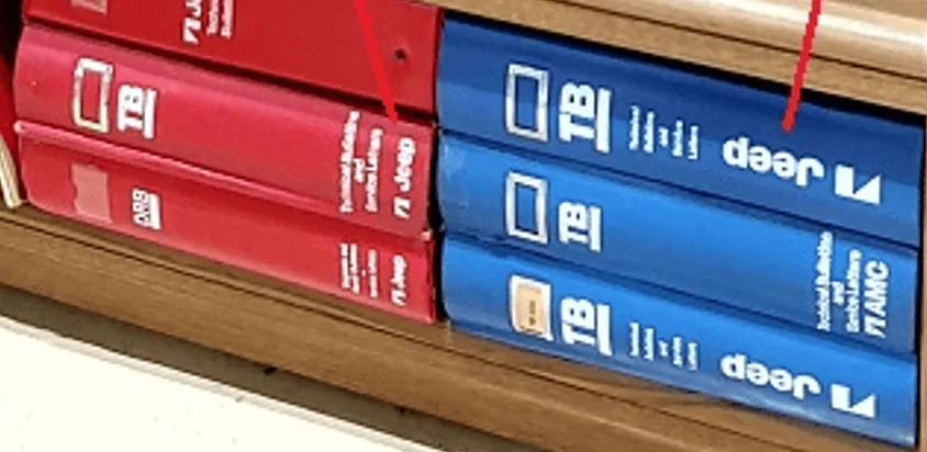

I have half a dozen binders of Jeep service bulletins covering years. I know all about it. I'm not a newbie just out of high school.

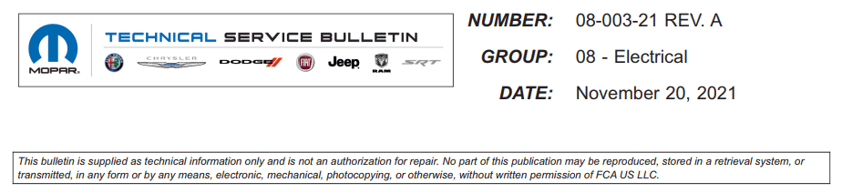

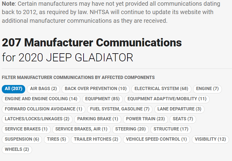

THESE 207 manufacturers' communications for the 2020 Gladiator are TSBs - NOT recalls ->
Jeep Gladiator Your stock Rubicon diesel JT bottoming out? Here’s the fix!! 1654663231965

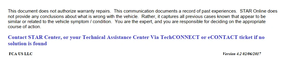

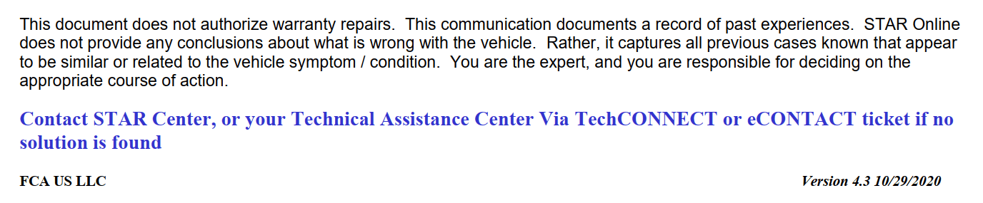

Here's snippets from TSBs - I've looked at a dozen so far, no mention of them being secret, internal or otherwise.
Jeep Gladiator Your stock Rubicon diesel JT bottoming out? Here’s the fix!! 1654662593042
Jeep Gladiator Your stock Rubicon diesel JT bottoming out? Here’s the fix!! 1654662653739
Jeep Gladiator Your stock Rubicon diesel JT bottoming out? Here’s the fix!! 1654662745498
And 30-40 years ago, DRB, then TB, then TSB.
Jeep Gladiator Your stock Rubicon diesel JT bottoming out? Here’s the fix!! 1654663726001

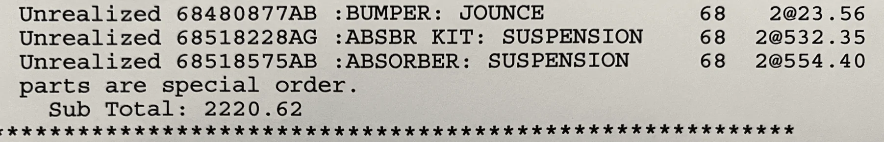

Wow, it looks like they ordered different parts for mine... expensive too.
Jeep Gladiator Your stock Rubicon diesel JT bottoming out? Here’s the fix!! 1655244664841

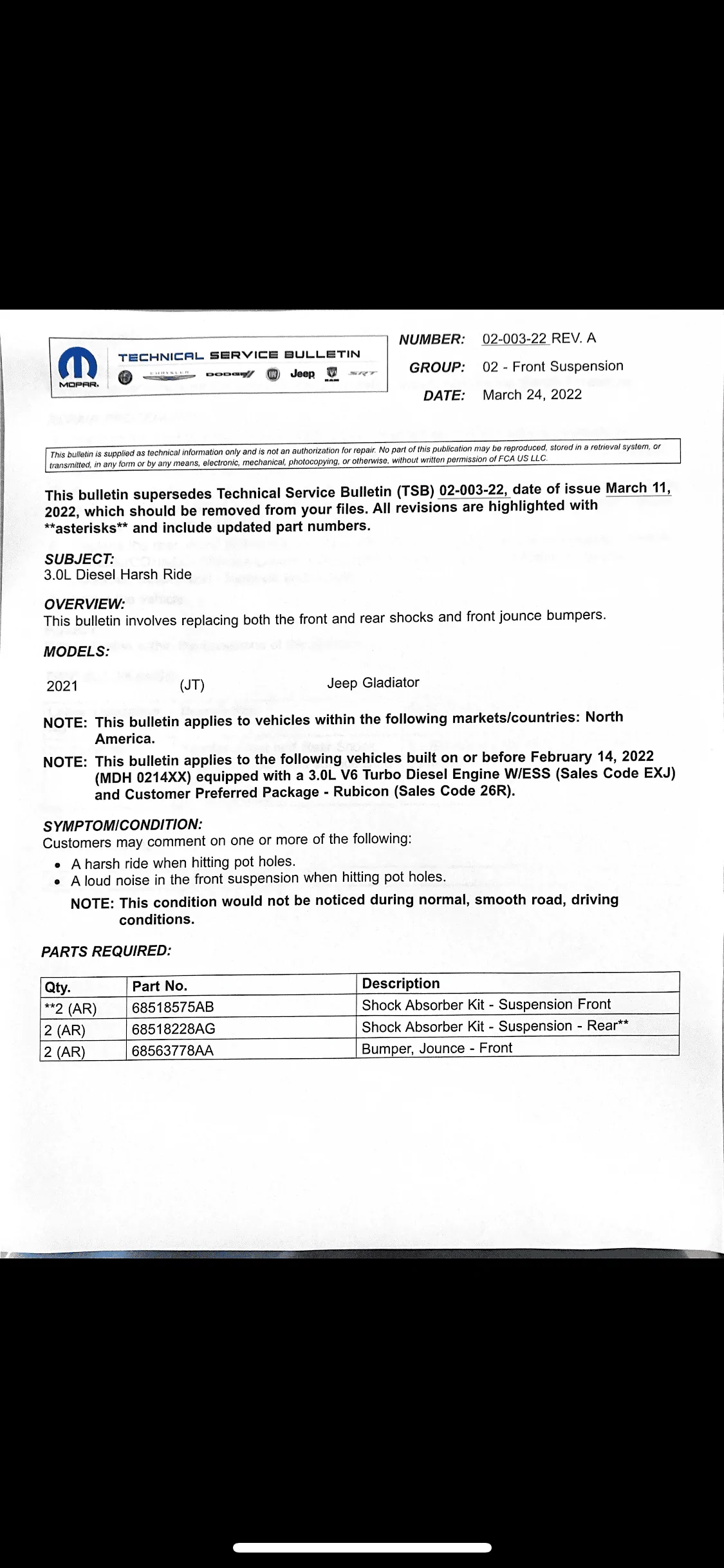

So my dealer just tried to tell me this does not apply to my gladiator and said there was another TSB issued on march 24th a revised one? Anyone have this issue?

Jeep Gladiator Your stock Rubicon diesel JT bottoming out? Here’s the fix!! 27C74309-648D-4A79-A77C-C61CD3C5E84D
Here is the revised TSB. They revised the part numbers and my dealer is saying they don’t apply and are non-fox shocks despite it being a diesel rubicon. @JeepCares you have any insight why my vin would not qualify or why the part numbers are incorrect and for a non-rubicon?

@AllMoparParts.com
Benny - can you please confirm the part numbers are correct/incorrect for a Rubicon for the revised TSB. My dealer is saying the parts listed are for a sport and are non-fox shocks.
Front Shocks - 68518575AB
Rear Shocks - 6851822AG
Thanks!

We will know shortly, mine is getting this done as we speak.
The parts website says "Performance Suspension" and that it fits pretty much every Gladiator...
https://www.factorychryslerparts.co...on-Front-Left--Right/17096188/68518575AB.html
