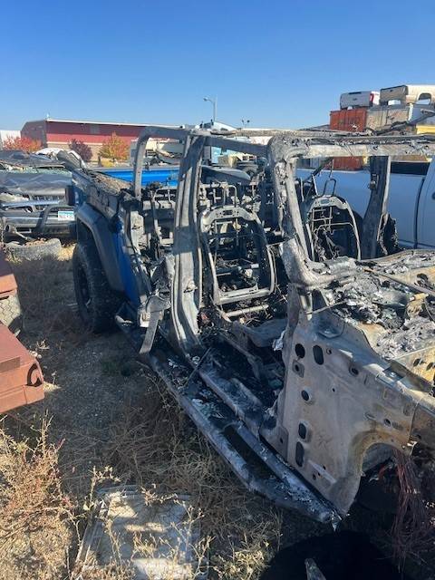

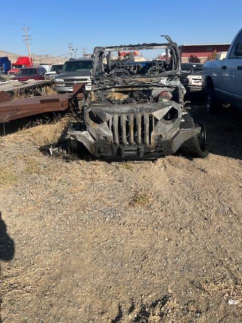

I've had the 2020 Gladiator with a manual transmission for a year and and half it had 52000 miles on it always had it serviced maintained it, well on October 20th (my birthday) I was on the highway and I smelled a smell then I heard grinding when I was in 6th gear going 80 mph I put it in neutral and t hen heard a big explosion fire came out from underneath and thru the engine compartment I pulled over. My wife and I got out without injury within 5 minutes the Jeep was gone

Definitely a safety concern for multiple reasons - anyone who has seen clutches and flywheels explode even with NO fire knows the danger, but add fire to that and it endangers not only the occupants, but others on the road, including the firefighters, police and first responders on the scene.
