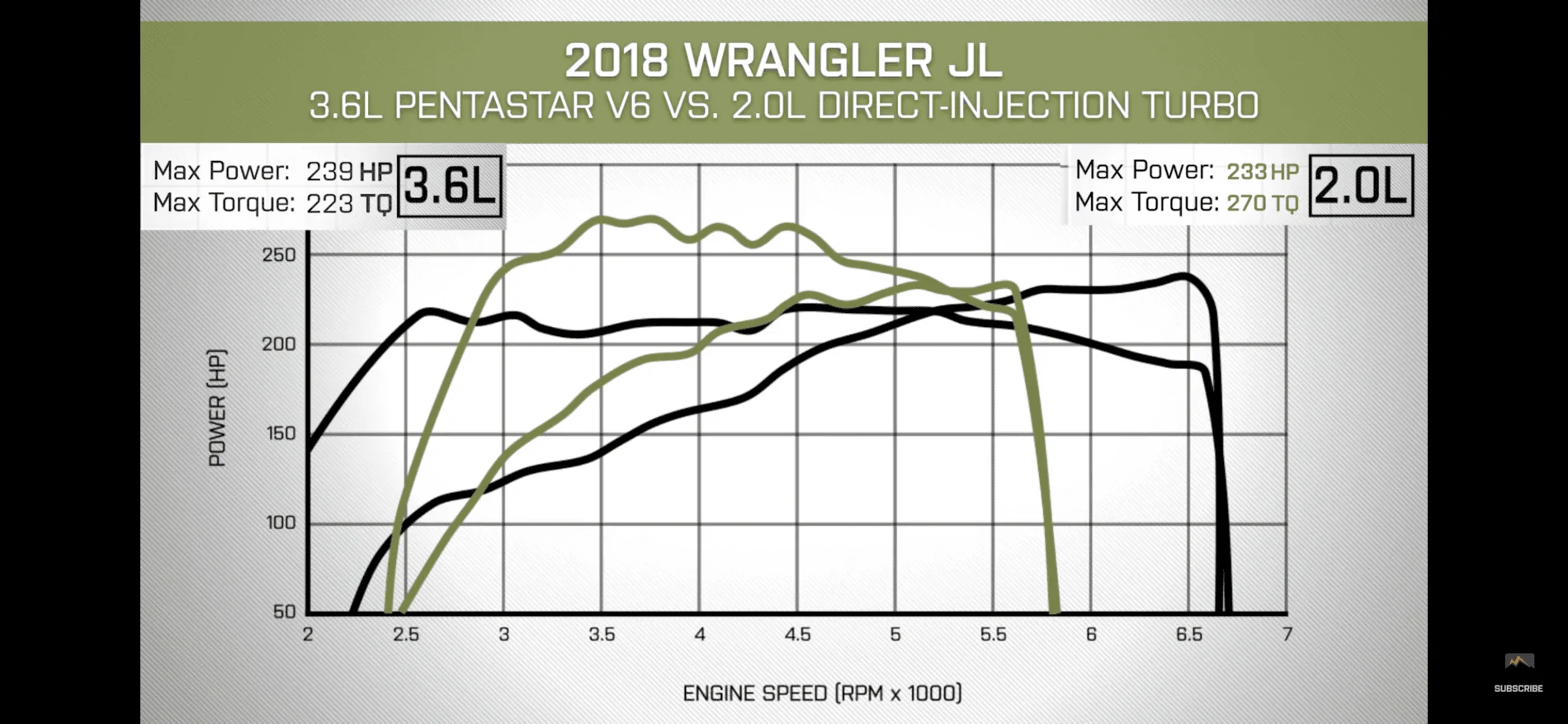

2.0T puts out a lot more torque and about the same power as the 3.6, which comes on sooner than the 3.6 So if anything it would be a better tow vehicle than the 3.6 if it has all that torque, no? It could be that perception dictates that you can't put such a small engine in a truck? The 2.0 also sounds awful, which again would be counter to what a truck is perceived to be.
Jeep Gladiator 2022 Jeep Gladiator Order Banks & Production Start Dates 8fbb5473-9230-43b8-a303-5e12b5fb33e6-png
40,440
53,854
Torque is the potential to do work - HP is the work it actually does. Even 6 HP drop is a fair amount on such a low HP engine. HP gets you down the track and is what determines your ET and max speed achieved. Take HP and you get there slower. We're pushing these at today's speed limits as it is - you really want to tell people yeah, the torque is great but your towing will be limited to 50 mph?
Torque feels good taking off - but if the HP isn't there - it will take forever to get to the line at the end.
Any less HP than what these have now would be unacceptable for me.
Hell, I'll put a hitch on my Javelin and tow if the next JT has less HP.
There's no way they'll keep the tow ratings they have if they have to lower HP on these. Just my gut feeling.
My wife's Grand Cherokee has a better tow rating than my JT has as it is.
I agree 100%, but the 2.0 makes more HP below 5750 RPM. Even when towing you won't spend much time above that RPM.
I'd still probably pick the p*. Just less stuff to go wrong, and easier to pull when I V8 swap, LOL.
40,440
53,854
That's a good point - HP down where it's more usable........
I'm used to cruising at 2800-3200 rpm.
My little red car hardly ever sees 5th gear because I can't stand something not responding when I want to get up and go. When I have the cruise set on that car, I leave it in 4th.
I only use 5th when not using cruise and at 65 mph or better.
I'll never get used to highway RPM of 1500-1800
