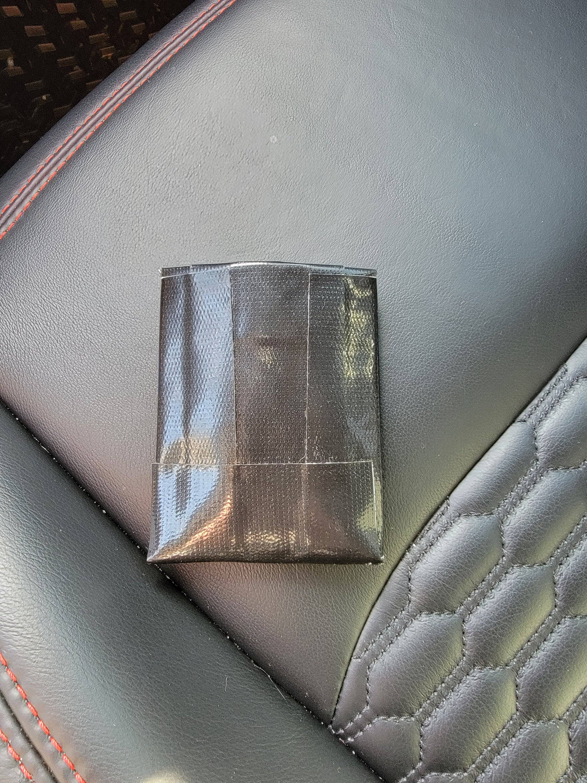

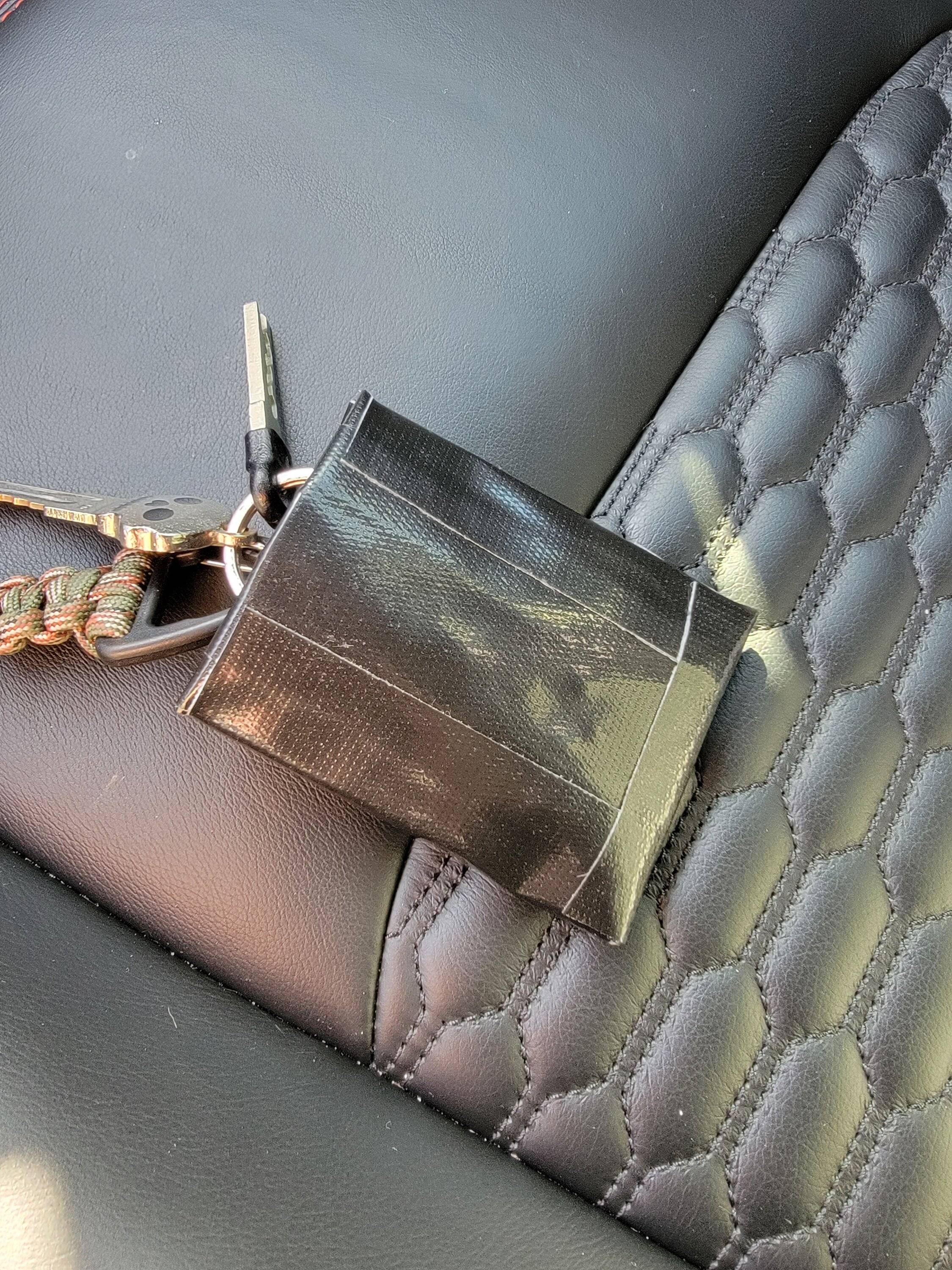

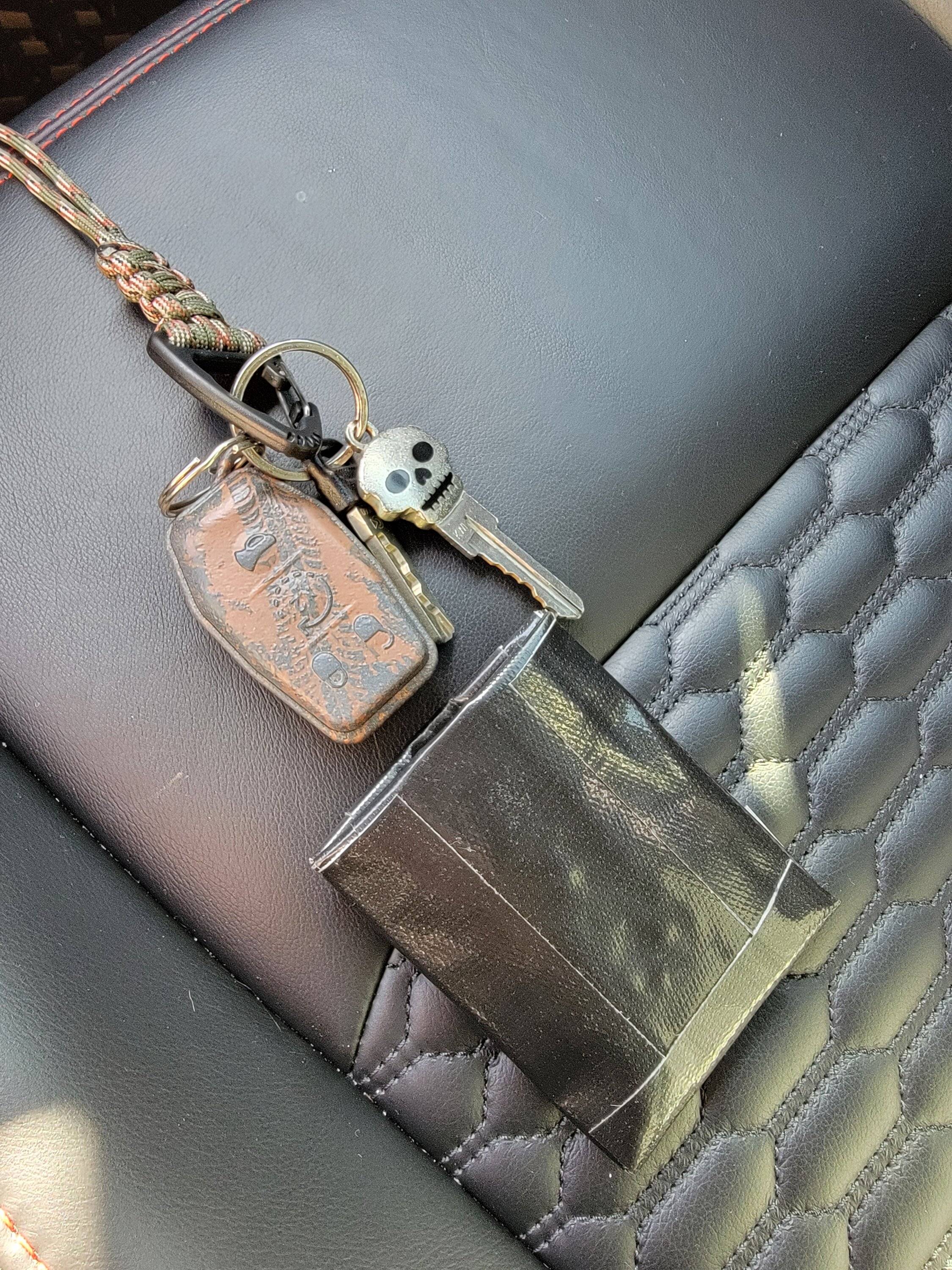

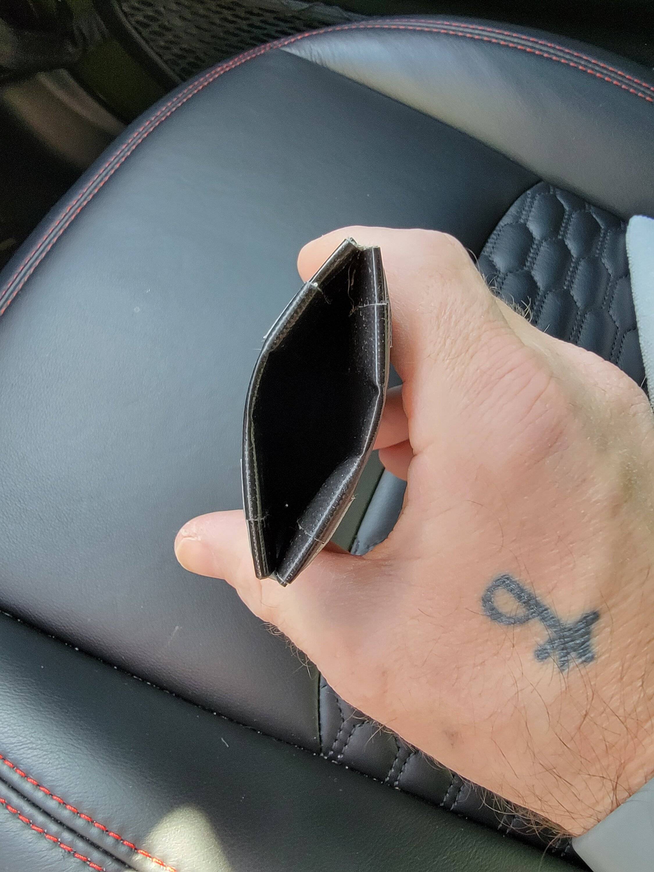

@ShadowsPapa Is on the right track with the aluminum foil... just takes one/two layers and it works like a charm. I wrapped my spare fob generously and tucked it away. With my daily use fob, The process of wrapping and unwrapping foil didn't work for me, so I created a foil/duct tape sleeve. It easily slides into my pocket when on the go and the key stays put when hanging my keys at home. I left my fob in the sleeve once after remote starting and when pushing the start/run button, I got a "key fob not found" error message and my keys were in the front cup holder.... proof enough for me... this was my first quick attempt, but with more thought/time I/you could come up with something nicer or anything you like... especially with all the cool duct tape available now.
My wife makes pouches/holders for credit cards. She has a RF blocking fabric she layers into them. Should work for a fob, too -I need to borrow one she's made for friends and see how it works.

You can buy the faraday pouches all day long on fleabay or amazon. I have them for the Harley, Vette, and now the Gladiator. I have tested all the keys with the pouches and they will not allow data or signal transmission.
Yeah, but what my wife makes can be in any color or pattern you want! Love purple, she'll make a purple one. ?
My wife couldn't start the Jeep with me holding the key in my pocket standing at the front of the Jeep without any RFID blocking.
