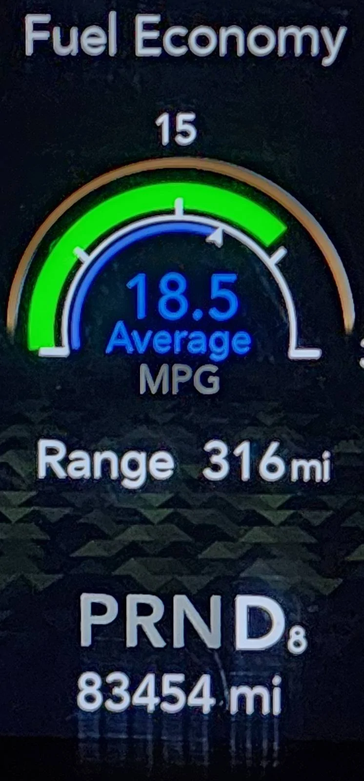

So ... recently bought a 2021 used (40k) JT Rubicon (not diesel)...8 speed auto trans... lifted it 2.0 inches (Mopar)...put on some 17 inch black rhino wheels and 35 inch mud tread nitto's on it...and driving around town it drives great.. look good too. On highway...well...it sucks...wont leave 6th gear and slight hill bogs down or will down shift to 5 or even 4th...I honestly can not believe that the 4.10 gears can handle the set up....but I read so many post that claim "no worries...4.10 is fine no need to regear"....then I read post that say...at least 4.88 and if you not a speed freak (e.g. enjoy driving at 80 mph) you could actually go as high as 5.12. So if you have something similar to my set up and drive a bit of highway on your daily commute I would live to hear from you.
Mine has 91,800 miles on it sitting on a 2.5 inch lift with 4.10's and mine is in 7th and 8th gear every day.. I live in WV and there isn't hardly a flat or straight road in this state.. if it is straight your either climbing or decending from one.. I don't understand why some won't handle it and why some will . Beats me .? I swear every word I just typed is true. This was 4000K after I stuck my 2.5"lift and 35'X12.50x17 on it .
That's what I get on Highway. On back roads I drop to 15.0 Because I am on and off the juice so much.
