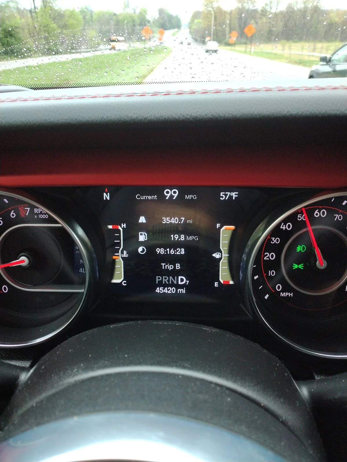

Jeep Gladiator 35's on gladiator...regear? IMG_20240429_102329
Gladiatorx2
Apr 6, 2024
42
328
463
Knoxville Tn
2021 Gladiator Rubicon
Police Officer
I am at 19.8 right now. That is an older picture. The current true pencil is 19.1 but shows 19.8
