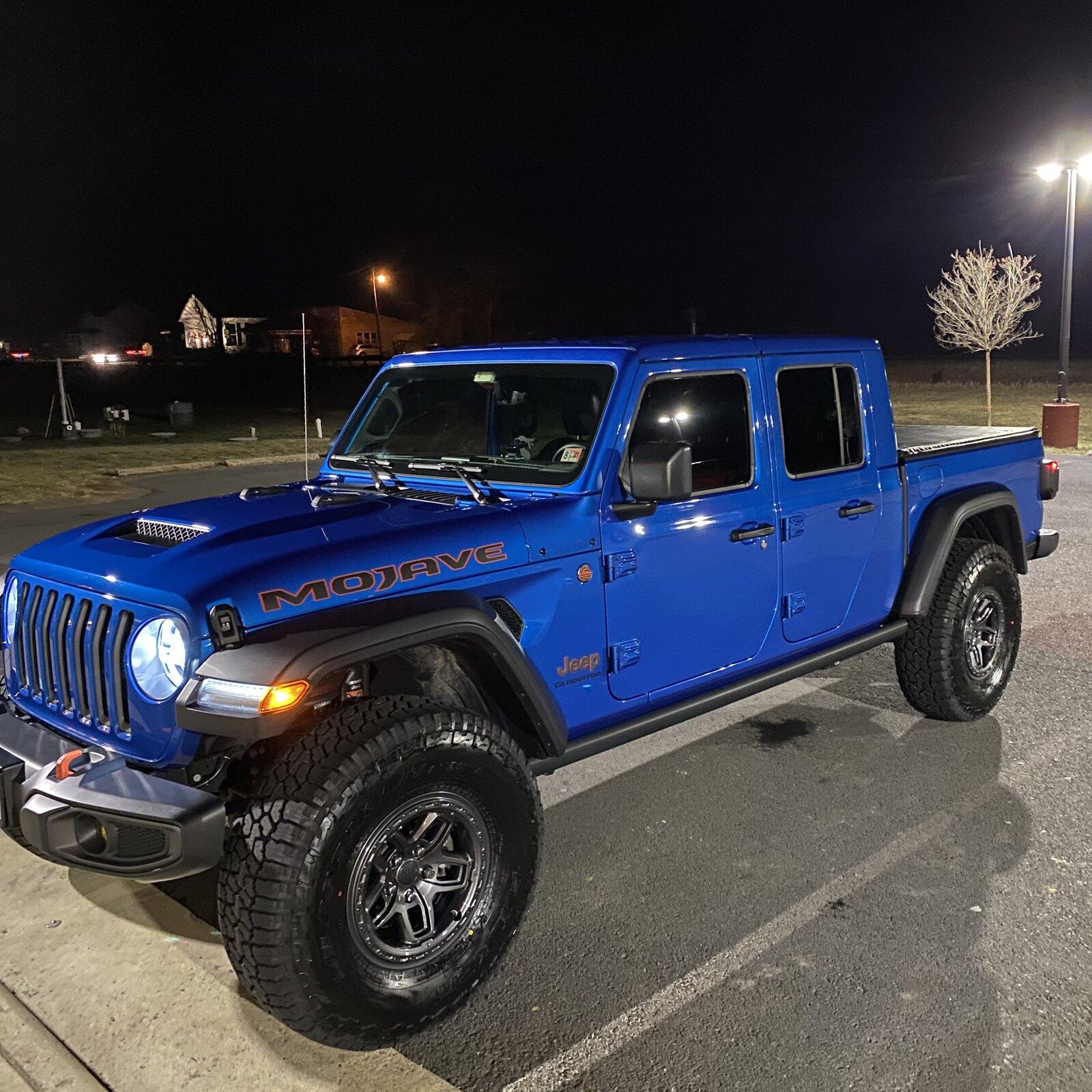

i regear to 4.88’s monday. I know a lot of people run stock 4.10’s on 37’s and say “it’s fine“ but i think its nuts, personally. Ive had my 37’s on waiting for gears on order and i cant wait to get them in. Imo, if youre really looking to avoid gearing, stick with the 35’s. I still think those need regear, but it wont be as bad and the difference doesnt look as much as you might think.

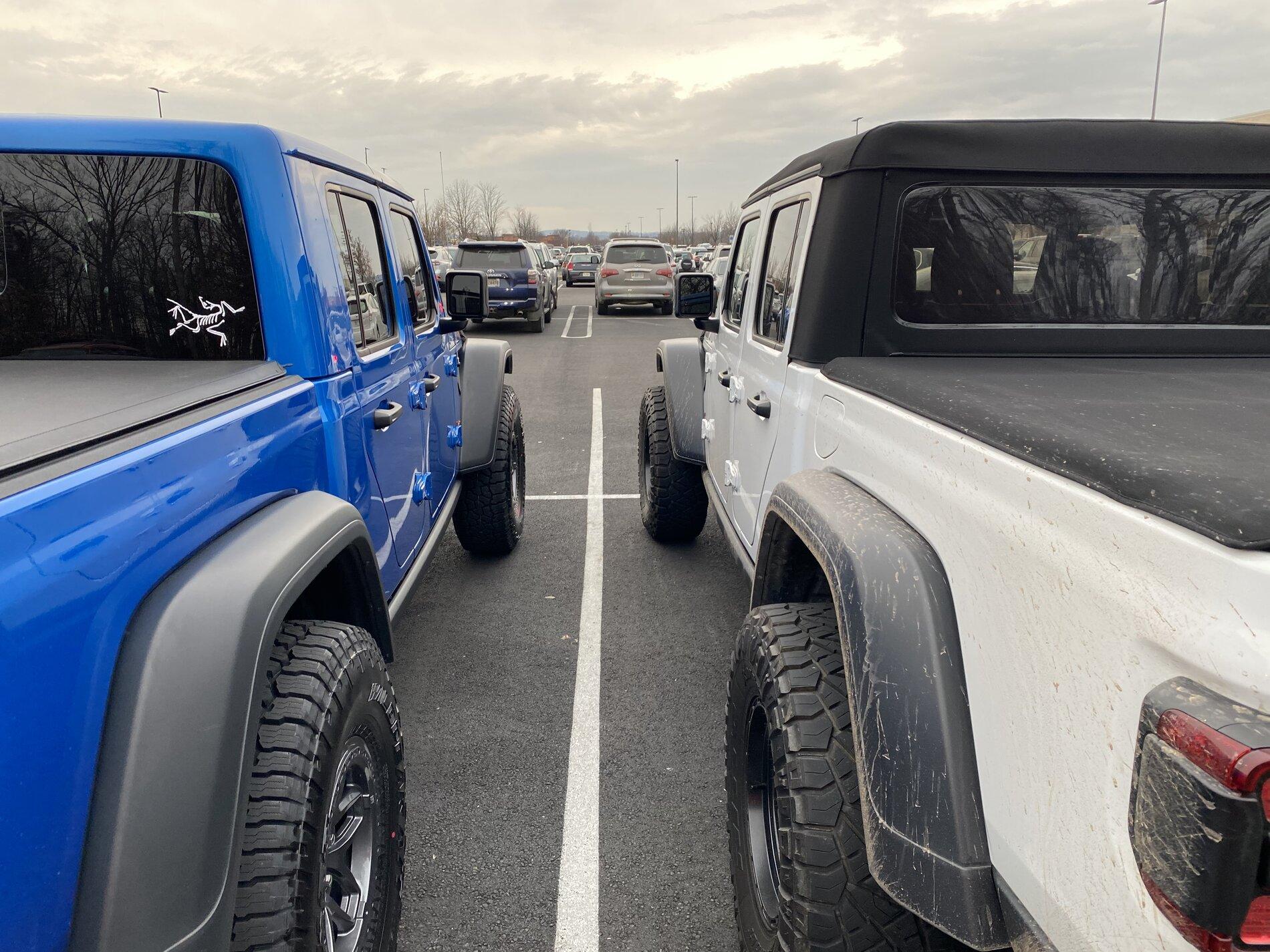

here is my Mojave next to a Rubi on 35’s. It looked like a leveling kit on it, but I cant say for sure.

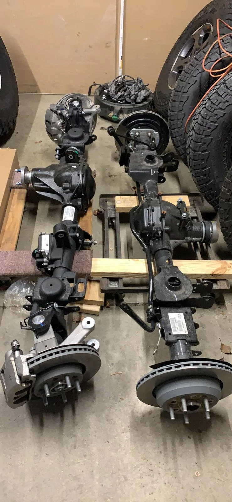

Please show me the ball joints - here are the front and rear axle assemblies. They are held in place by links, bolts through bushings.

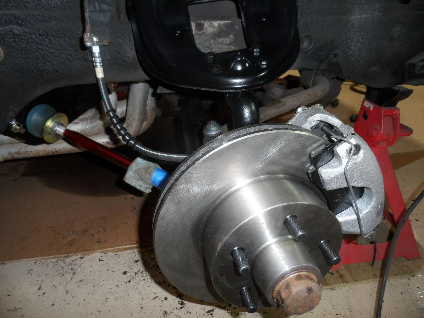

The other picture from my race car (after I swapped in disk brakes) shows an upper control arm and you can see where the ball joint is at the outer end of the control arm - connects the upper control arm to the steering knuckle.
All straight steering axles have king pins or ball joints. Even the heavy duty front axle in my F450 has ball joints

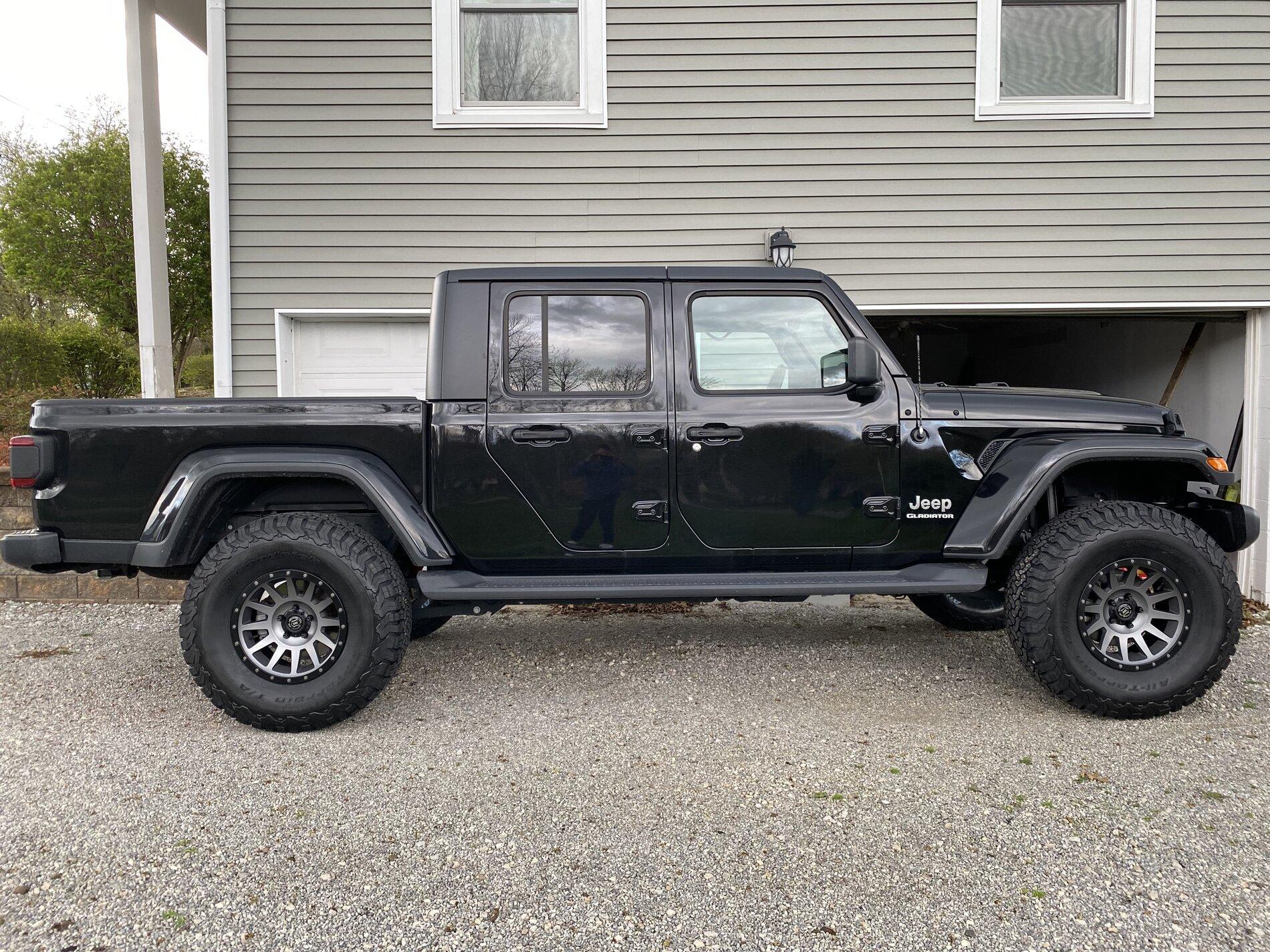

How about in between? BFGs tend to run a little small and the KO2s are very light. Very happy w the result. Wheels are Icon Compression w 4.5” bs
Nice setup! I’m looking at those same wheels and tires for my Overland. I’m running a Teraflex 3 1/2” lift with Fox shocks.
What offset did you choose (-6 or -12)?
What lift do you have?
Any rubbing either on or off-road?

I went with the -6 offset, which is 4.5” backspacing (the same thing as running the stock Overland wheels with a 2” wheel spacer). This is actually a requirement for the 3.5” MetalCloak lift as it has outboard shock mounts. The tires stick out past the fenders a couple inches, but nothing odd looking. No rubbing anywhere on the road. I haven’t had a chance to get off-road yet with this setup, but I’m expecting to have to adjust the bump stops.
