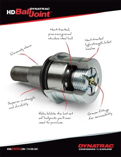

Right there in plain sight on the front axles. Dynatrac makes Pro Steer pressed in ball joints for the JK that will fit the JL/JT. That is what I installed on both of my JLURs. If you were talking about the rear axles, it does not have ball joints.

Never seen 'em called ball joints as all they do is pivot - more like a king pin.
Jeep must be the only company that calls them that.
Ford doesn't.
They pivot around an axis and don't tip or tilt like a true ball joint has to. I suppose because there is a ball in there acting as a bearing, they call it a ball joint. They can call 'em what they wan't, it's a simple pivot with a single ball acting as a bearing.

King Pin is really what they are, you are as old school as I am.
LOL - yeah, it appears so. To me a "ball joint" is like your hip - it can swing or pivot multiple directions. Someone couldn't figure out what else to call them I guess!
For that joint - whatever we decide to call it ;-) I'd want one that had a good long-lasting bearing surface - well, like a quality ball joint has!
I like the idea of being "greaseable".

King pins different from ball joints. They are similar in location on the axle, but that’s it. King pins are a solid pin with a bushing that rotates around it allowing the knuckle to steer. Ball joints also allow the knuckle to steer, but are different in design. The are a ball with a metal socket crimped around it, with a threaded shaft on the end of it. Most oem ball joints have cheap plastic inside. Aftermarket ball joints are stronger and usually have zerk fittings in them so they can be greased.
