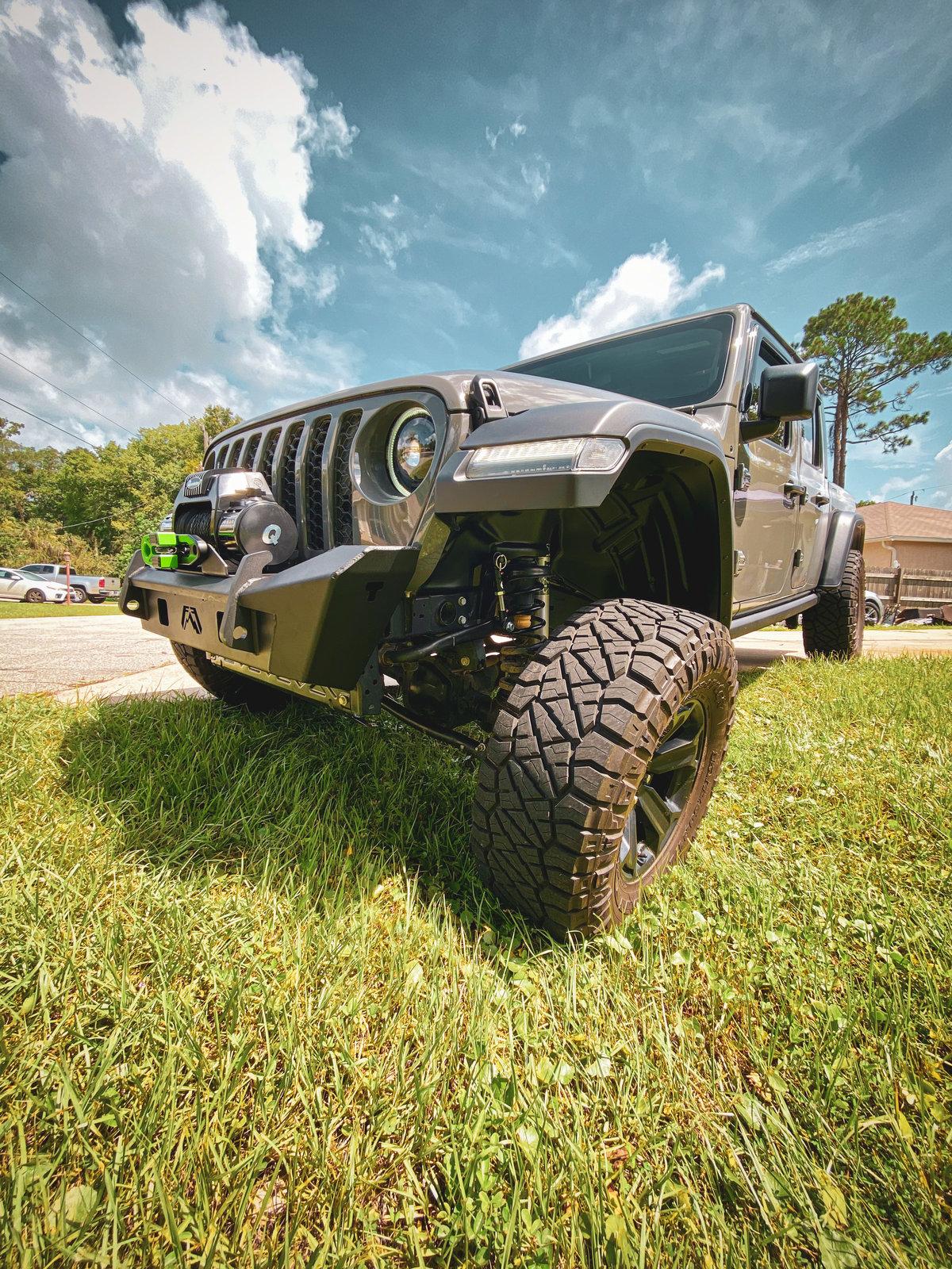

37’s...
Jeep Gladiator 35s or 37s? E9B4F355-2890-4EC0-B5DF-8BB9AA007118

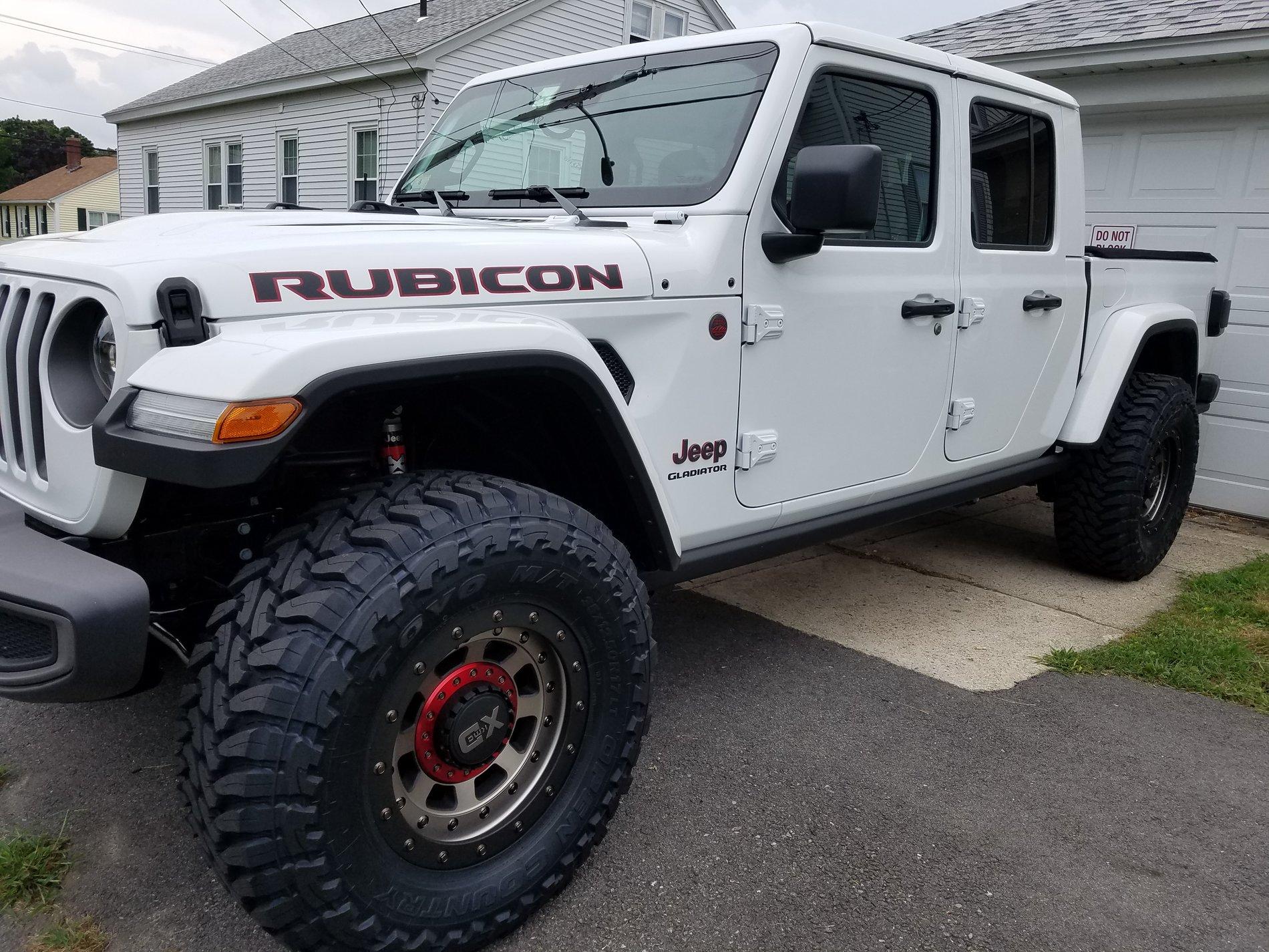

I went with 37” Cooper STT pros and the 3.5” rough country lift. I debated heavily between 35s and 37s. I’m very happy with the results.
37" looks so much better imo. I'm wondering if I can do those on my overland with 3.73 gear ratio and not push it off road while planning to upgrade the axles later.
Any thoughts?

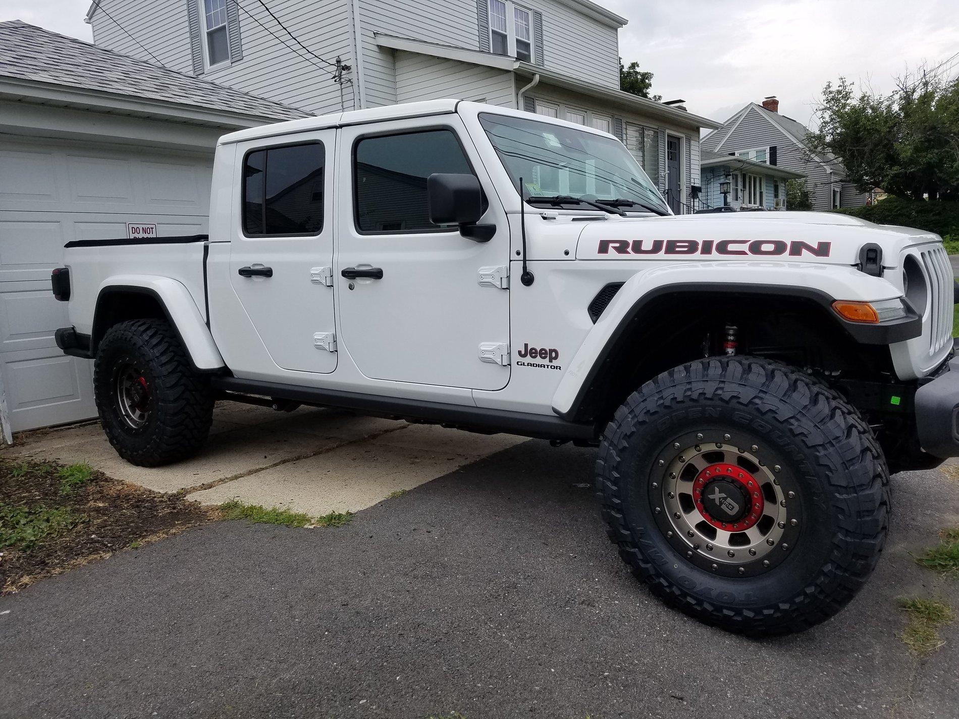

Anyone know for sure whether or not 37’s will hit the inner fender with the sway bar disconnected (rubicon fenders) At full lock? I’ve contemplated going from 35’s to 37’s but I don’t want to gut my fenders to do it.
Jeep Gladiator 35s or 37s? 97EC68CB-2710-403F-8D0B-63CA14101E70
Probably depend on wheel backspace and tire width. Plenty of folks are running 37s!

I agree. I’ve read SO MANY posts here on 37’s but can’t find anything on whether they’ll completely fit at full lock. Assuming stock wheels or a mild offset. My wheels are quadratec recon 17x8.5.

So those wheels are 5.2" backspace, +10 Offset. There should be someone that has that configuration to tell you. I'm running 35" at zero offset.

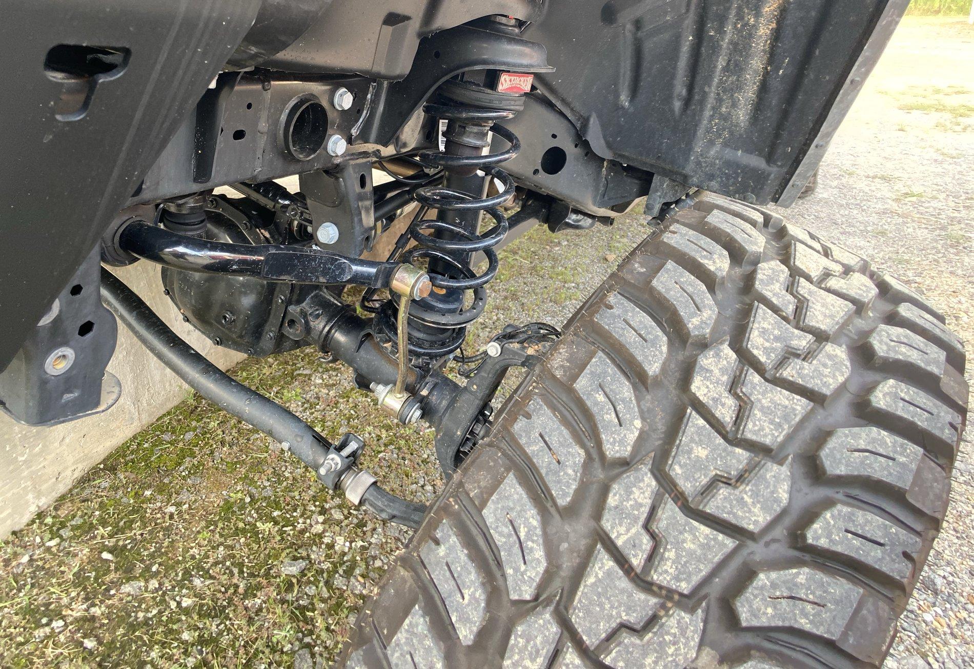

The flat top part of the concrete ramp is 3-feet tall. And I was nearly all the way up it. So, just shy of 3' of articulation and stuffing 37's with the swaybar disconnected and a 2.5" spacer lift on an otherwise stock Rubicon suspension.
