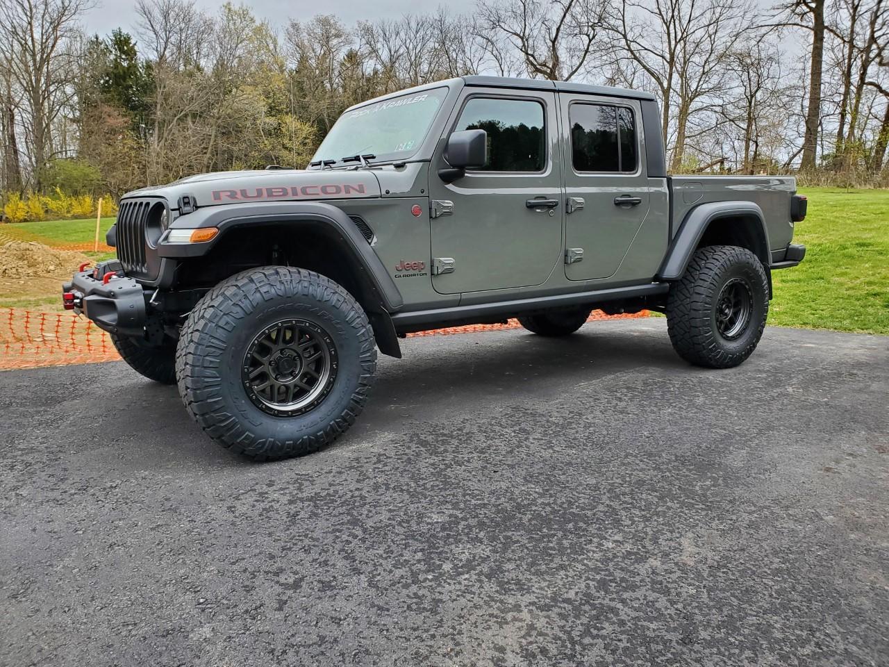

whats your highway mileage like on that set up
I'll keep you updated. Have only put about 100 miles on it so far with new gears.

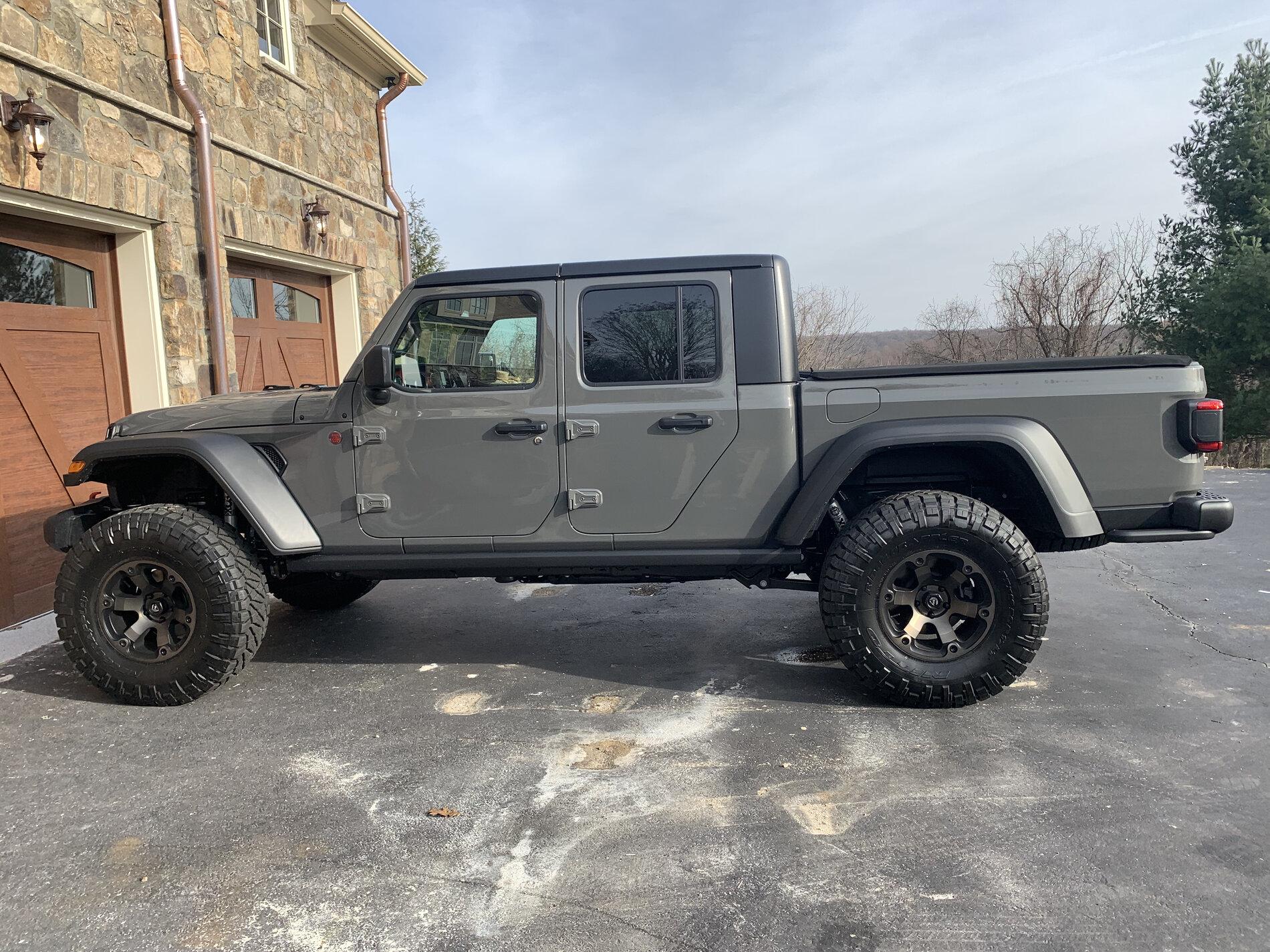

My stock diesel handles the 37's better than my (previous) supercharged gas handled 35's. No regrets. I don't see any need for a gear change so far (Mopar lift with level kit.)
Nice choice of color!!
