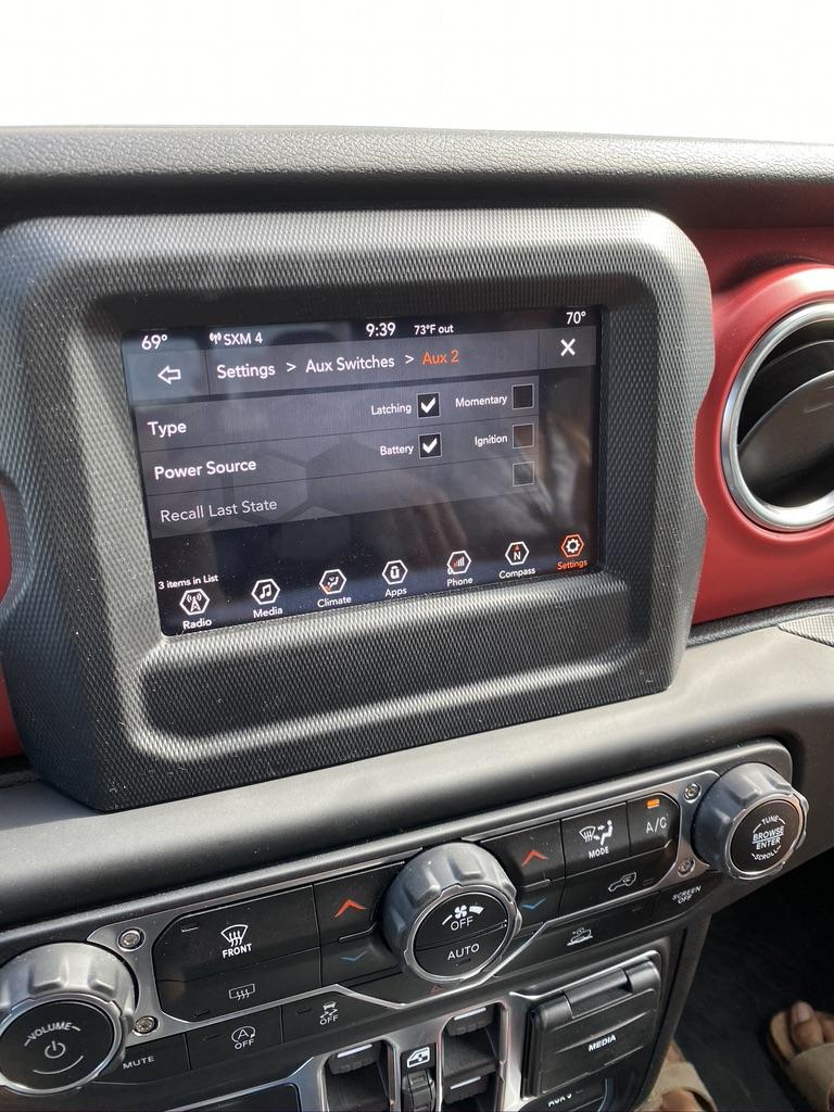

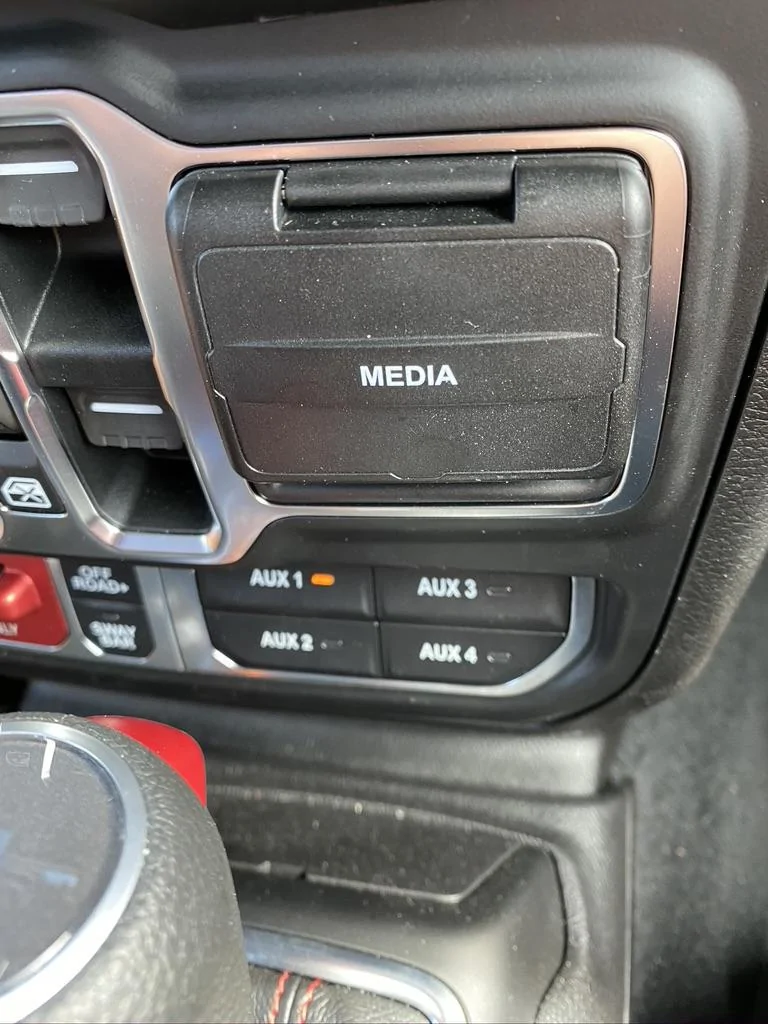

Had the switches installed yesterday at the dealership.
I don't have anything installed to test the connections yet; but the switches light up when pressed. When you go into the radio menu, Aux Switches are there, I can program them without issue.
I hope to get some items installed soon to test them.
