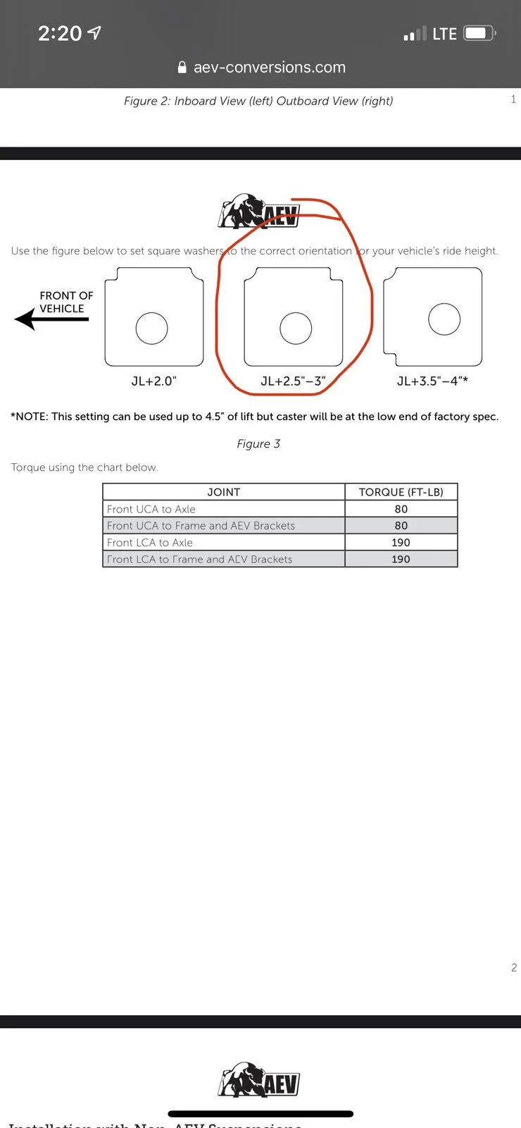

I think the instructions for the AEV geo relocation brackets should be updated to say on Mojave’s to use the 3inch holes instead of the 2 inch as the Mojave is already 1 inch higher. I also used the 2 inch and have the same caster as you. I’m going to flip the washers to the 2.5 -3” holes and have my alignment rechecked.
Will you please let me know if that works for you?

I emailed AEV. I won’t be home to measure until Tuesday, but here’s their response:
Most likely you'll use the middle, but you can measure from the top flat spot your spring seat on the axle to the bottom of your frame directly above it and see what suspension height you have. In a nutshell, the measurements break down as:
5” = 2” lift = location 1
5.5-6” = 2.5-3” lift = location 2
6.5-7.5” = 4.5-4.5” lift = location 3
I would recommend not overthinking and just use location 3...these Jeeps do not have enough caster from the factory (should have been 5.5 to 6 degrees for Rubicon) and with larger tires and lift you want more than stock anyway. You will not be able to add too much caster with these components.
The additional caster will help the steering wheel return to center and would increase the steering effort a but, which I think is a good thing.

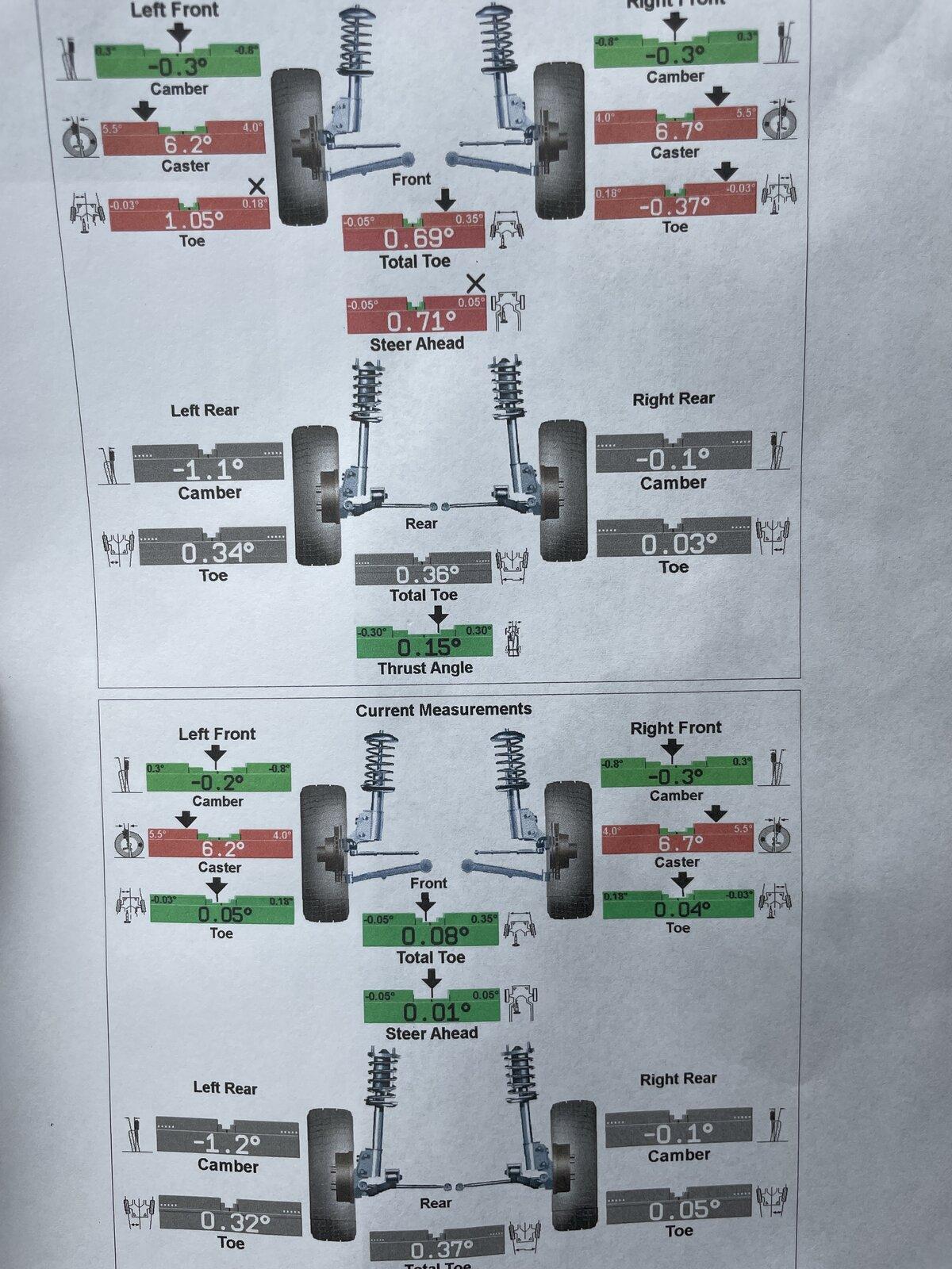

I’m noticing a fair amount of “wander” at highway speeds. I’m wondering if getting the caster up will help that?
The geometry brackets helped my truck with the wander
I have the geometry brackets but I think they’re set at the lowest position hence my lower caster? I’m at 4.7.
