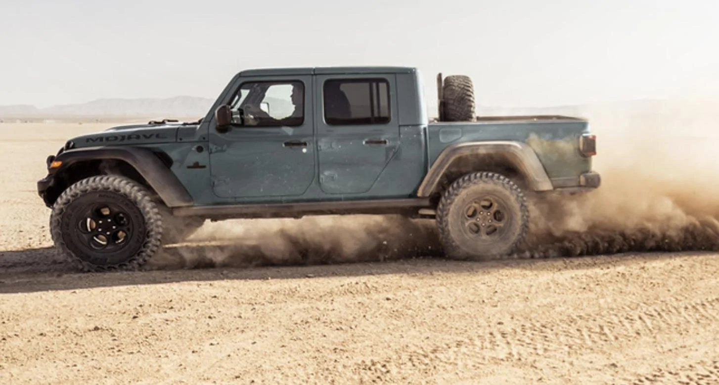

Anyone have more pictures of the AEV Mojave? It seems like I only ever seen AEV Rubicons?
Jeep Gladiator AEV 2" spacer lift for Mojave Gladiator AEV-Jeep-Gladiator-Mojave-Space-Lift-Kit

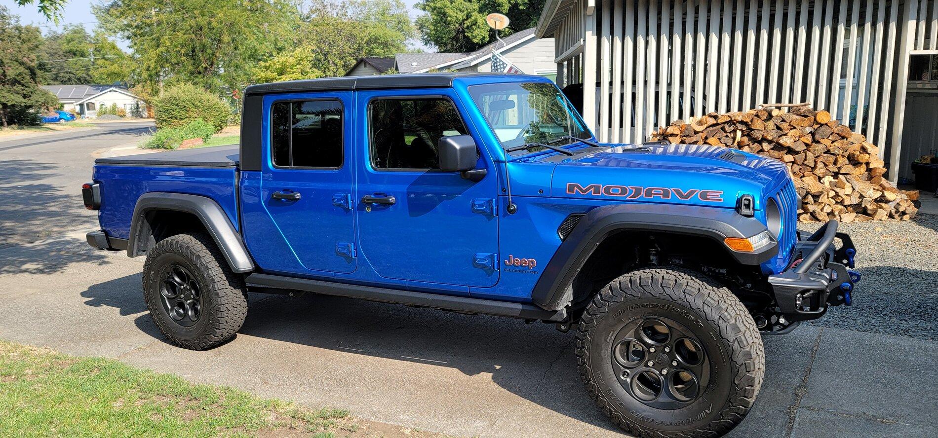

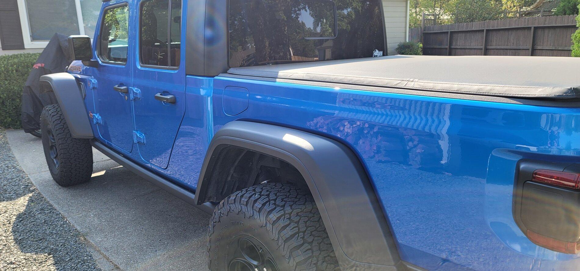

Just picked mine up from the installer. I had it installed because I wanted a receipt to avoid any potential warranty issues. Probably a waste of money but my local dealership sucks and I don’t want to give them any reason to hassle me. Anyways AEV Mojave kit with Geo correction brackets. Drives like stock and looks good. The installer acted like it was the hardest kit ever to install. ?‍♂At any rate they were thorough and that’s all that matters. Alignment came back good although the caster is a bit lower than I wanted at 4.7. Don’t notice any issues with drive ability yet but I will keep an eye on that. I highly recommend this lift for Mojave owners if you don’t want to go nuts on buying tons of suspension parts. Not to say I won’t do that in the future. ?‍♂
Jeep Gladiator AEV 2" spacer lift for Mojave Gladiator 17D81945-698D-4D77-A489-4D35E8BDC68F
Jeep Gladiator AEV 2" spacer lift for Mojave Gladiator 8713A194-5C62-4C57-8EB6-3A7159D8F5AA
I think the instructions for the AEV geo relocation brackets should be updated to say on Mojave’s to use the 3inch holes instead of the 2 inch as the Mojave is already 1 inch higher. I also used the 2 inch and have the same caster as you. I’m going to flip the washers to the 2.5 -3” holes and have my alignment rechecked.
