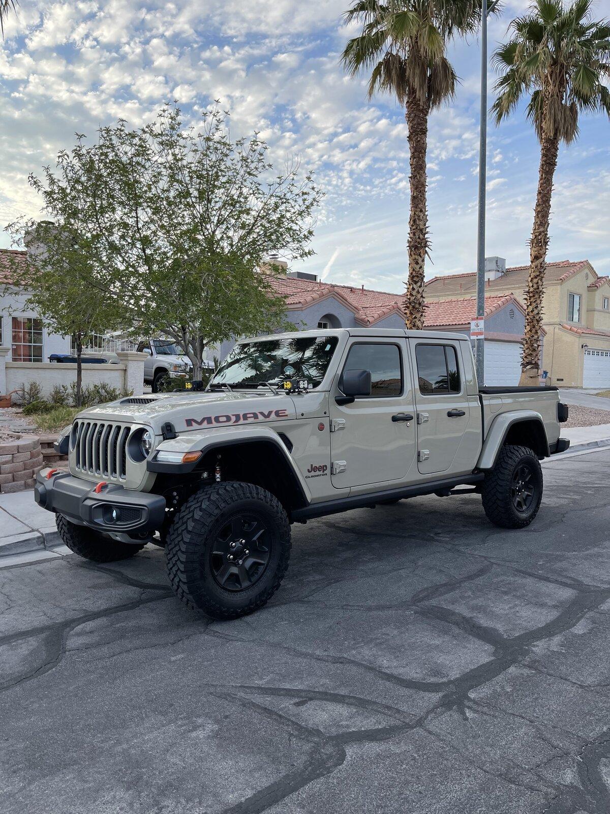

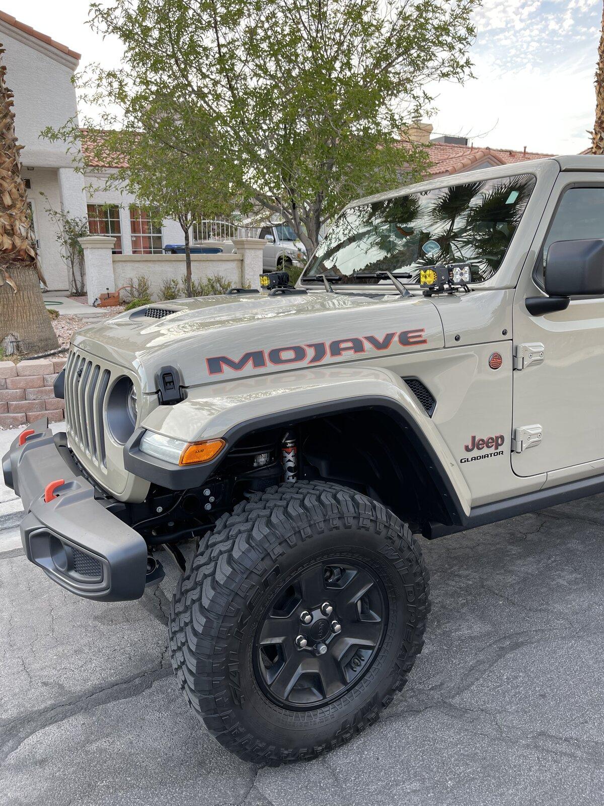

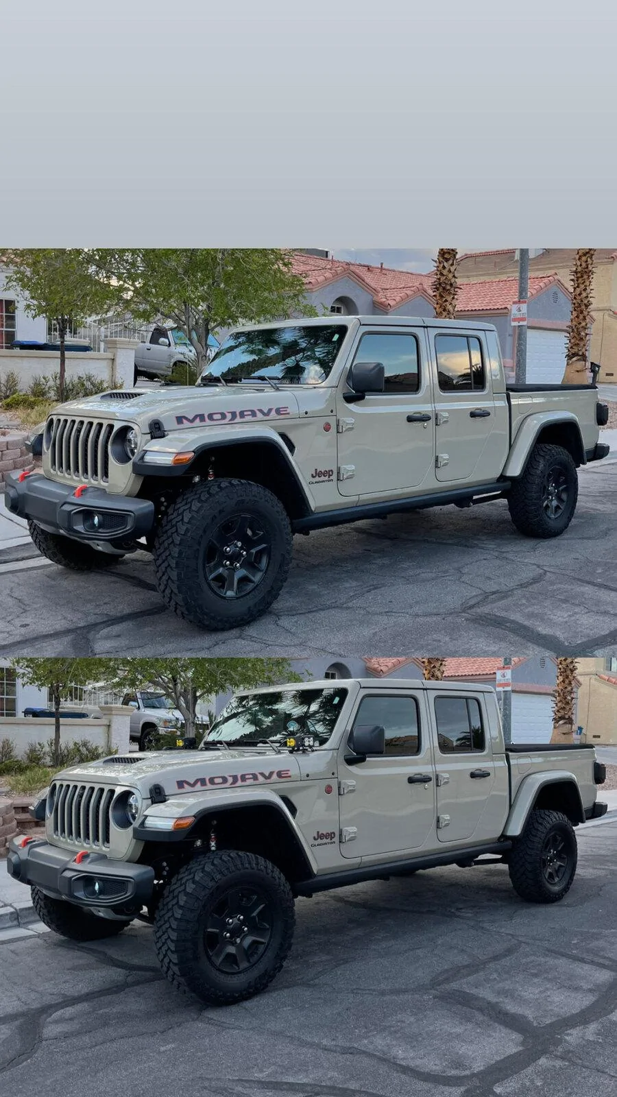

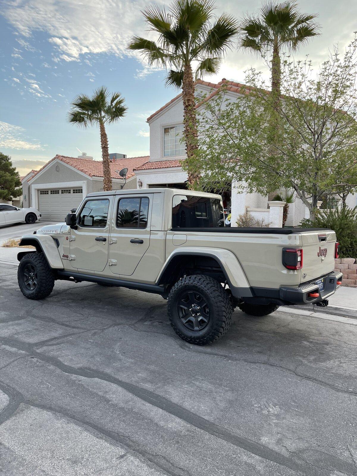

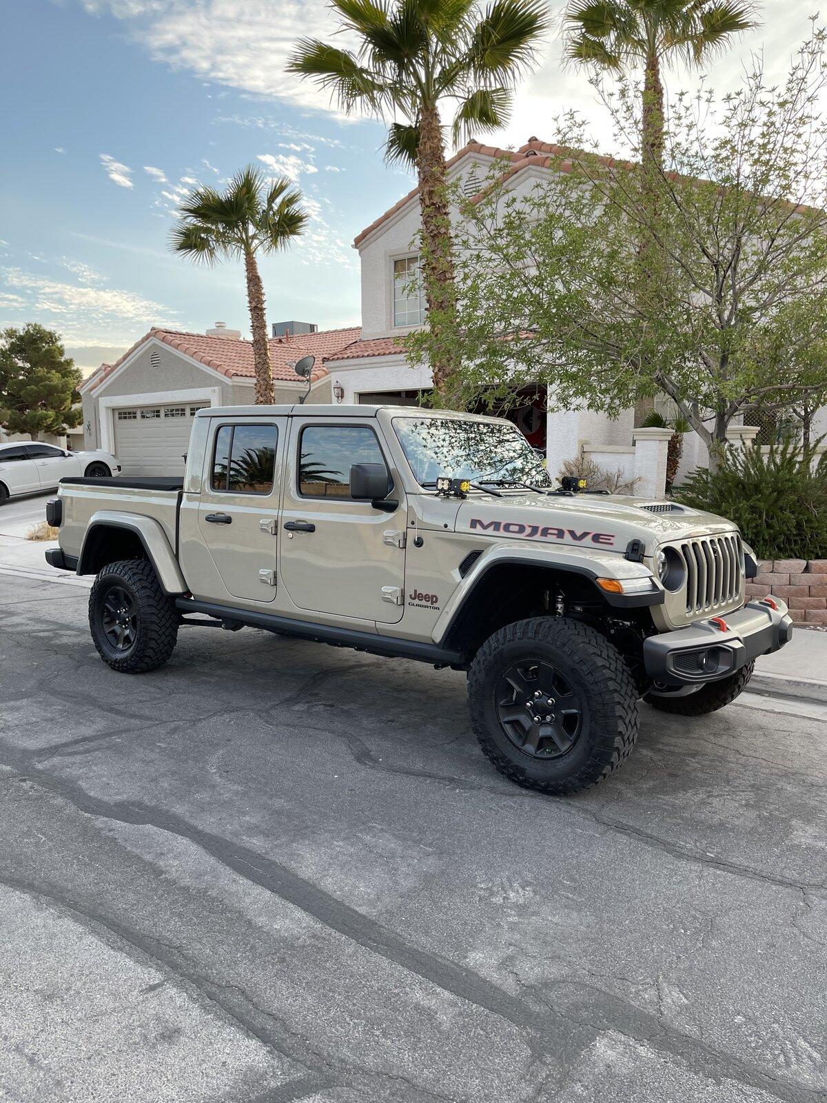

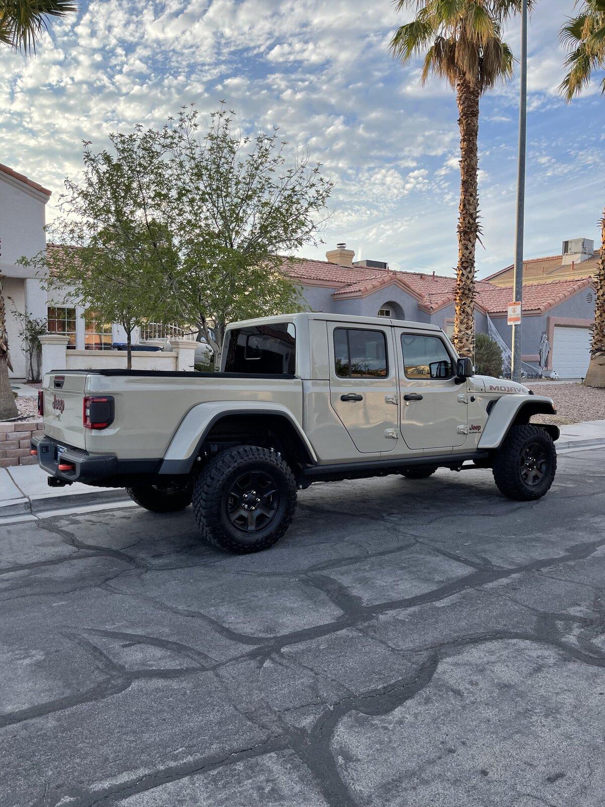

Finally installed mine a couple weeks ago. Aev 2 inch kit + geo brackets. Rides like stock, 10/10 would recommend, great quality product. I set my caster bolts on the geo brackets to option 3 to see what that comes out to. Will get back with alignment results to see if i need to drop down to the middle position.
