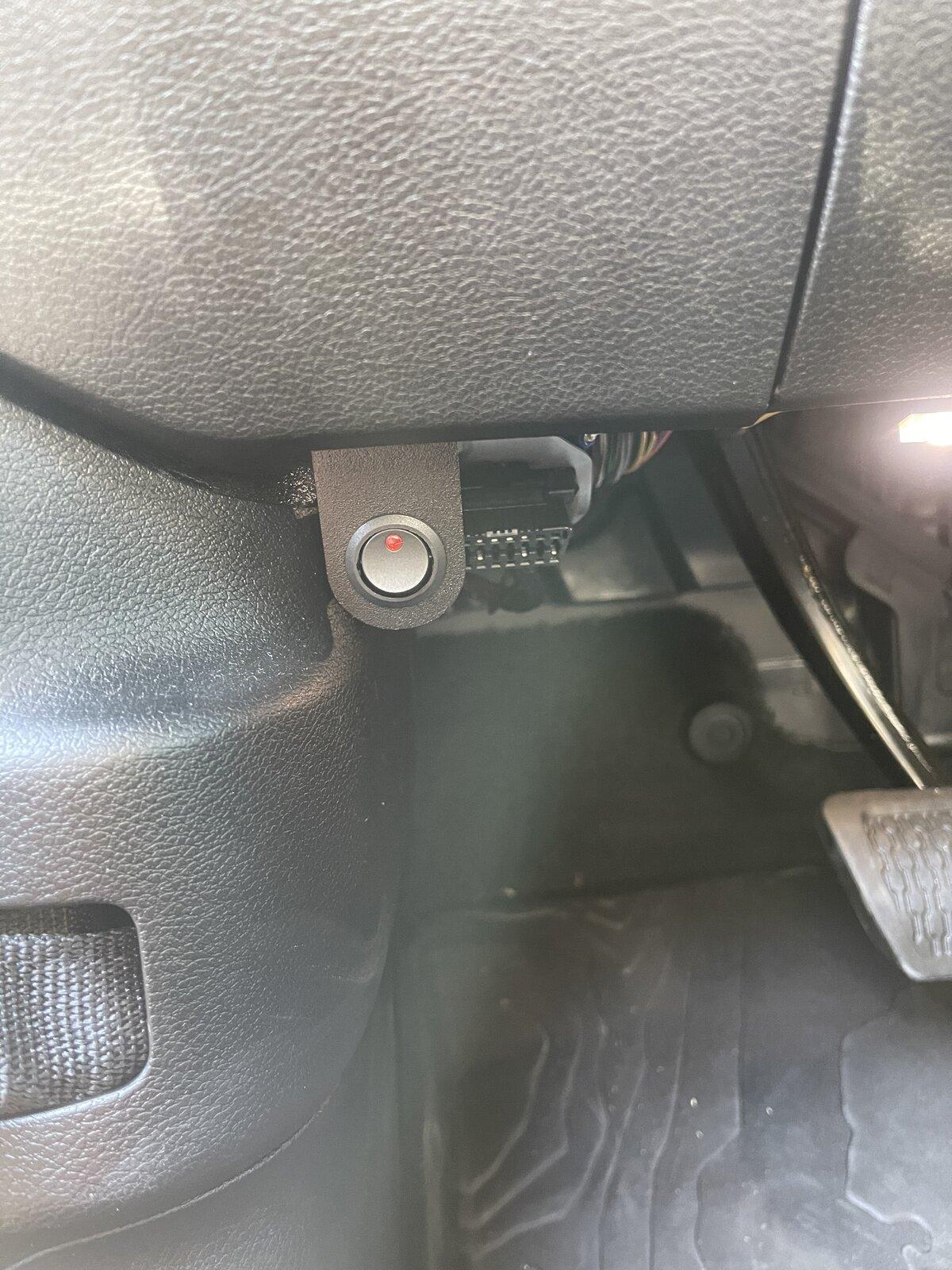

Oh, I loved them on my JKU, and I am sure I would get over the width on the Gladiator if I actually went that route. I loved the low step when they deployed! Where are you guys mounting the buttons for manual operation when they doors are off?
It comes with a bracket, just mounts up super easy.
I have the door delete kit installed (x2, needed for front and rear). I just drilled out a couple spots on my B pillar, just below the panel that pops off to remove the doors.

I bought mine at Northridge4x4 with 10% off on Black Friday. I bought the armor, lights, and 2 door delete kits. The lights are definitely worth it. The armor is thick and heavy and seems worth the price. The motors require 20 amps, so, yes, you can use aux switch 1 or 2 (40 amps) and use the ground by the passenger kick panel, but, you also want to install the RSE switch by the drivers door, so, you can just reach in to an open window and turn the steps off. I have not installed the door delete kits yet. I will probably install them later this summer.
