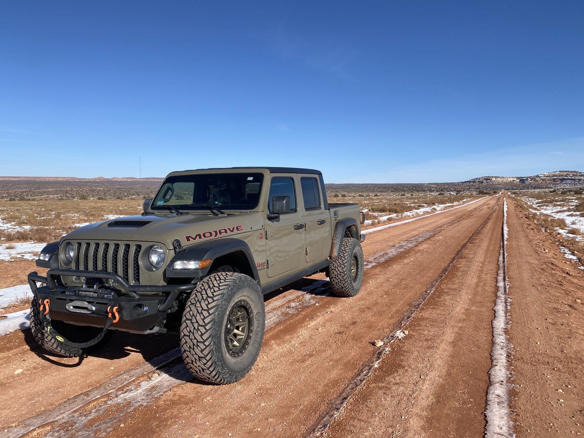

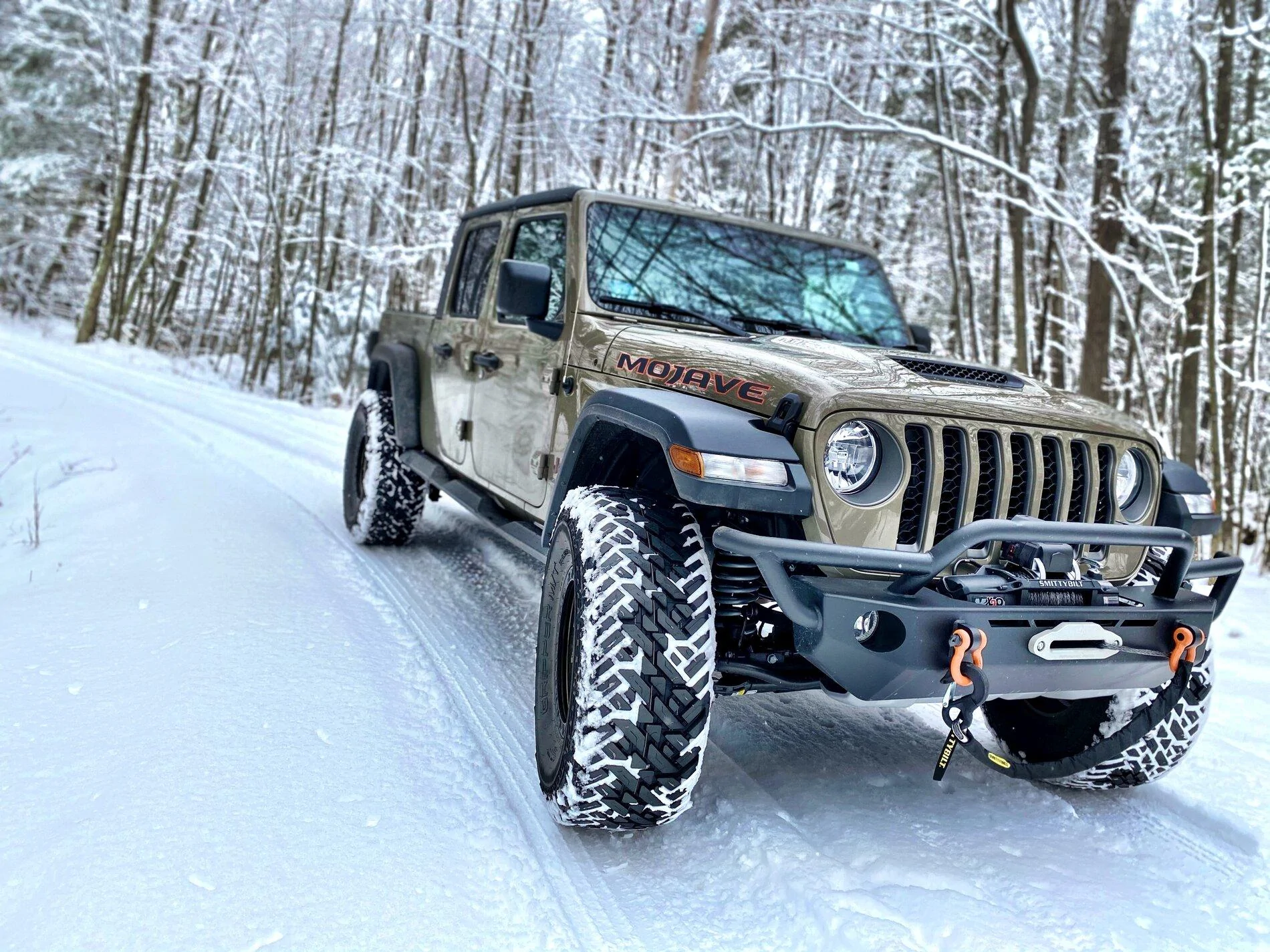

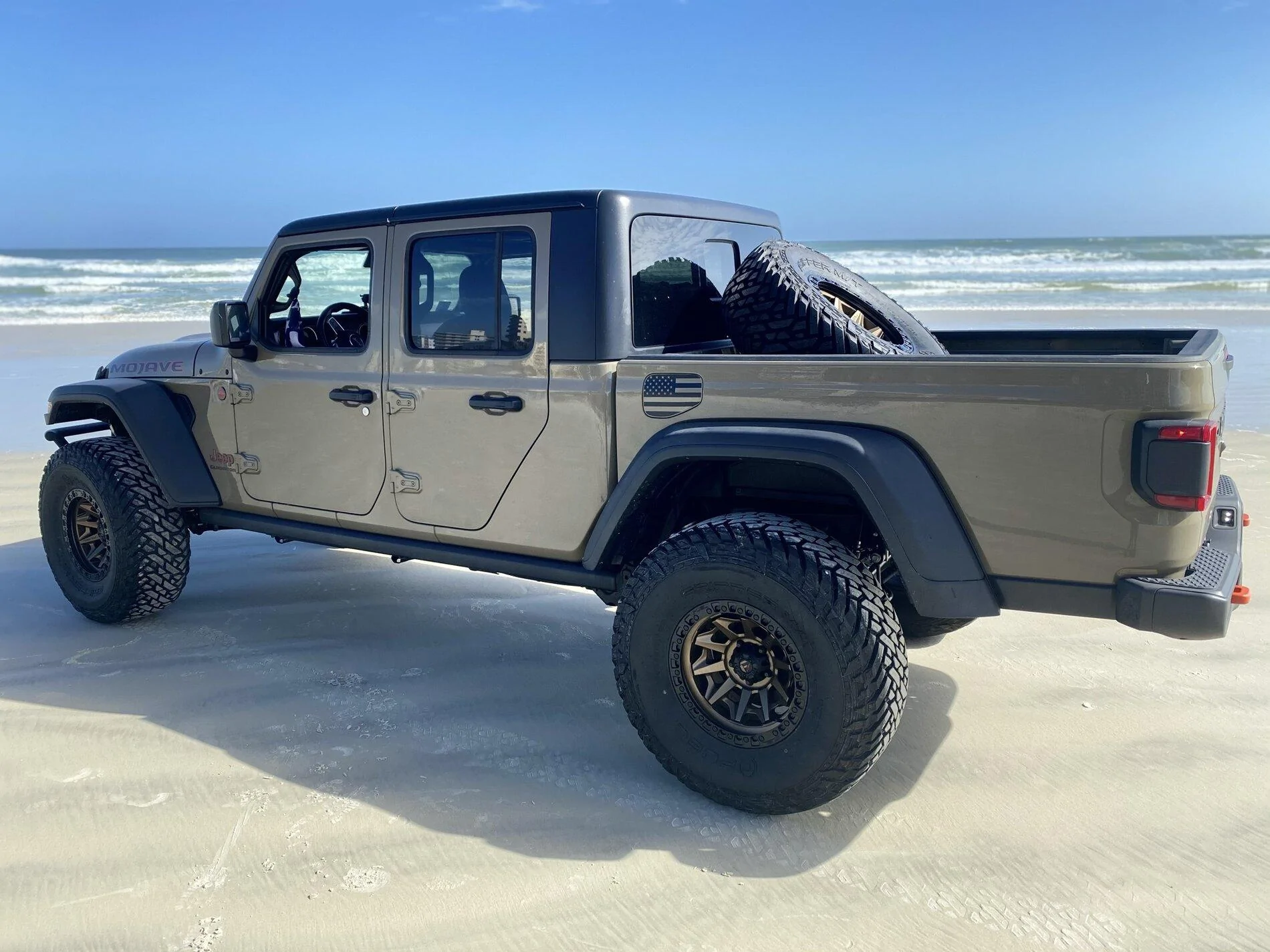

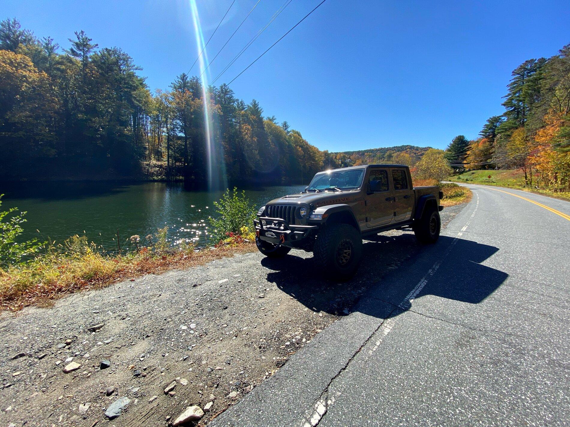

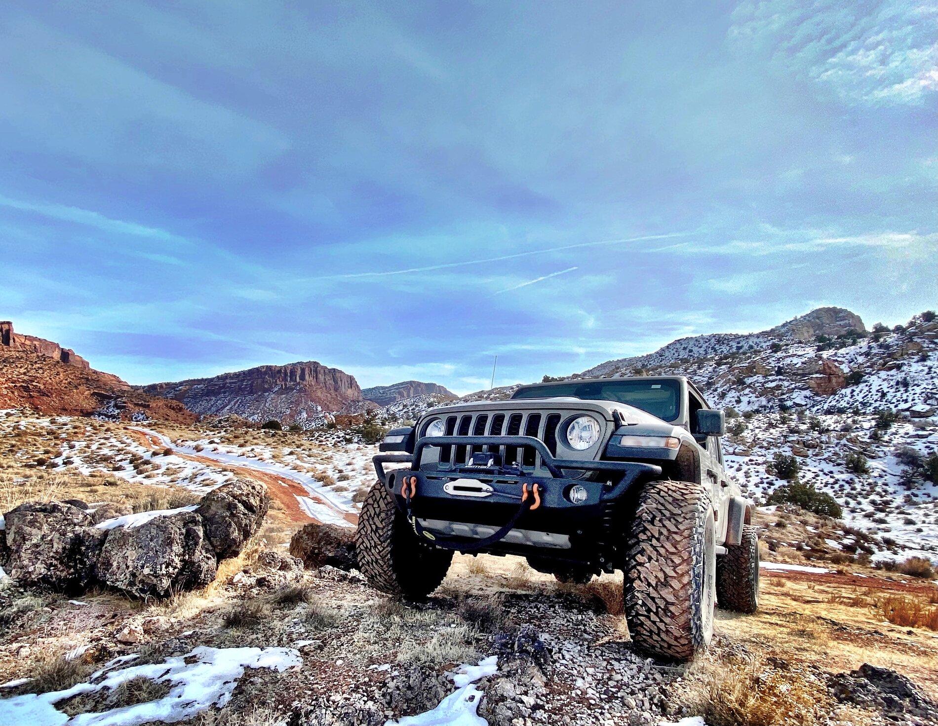

I recently did a long trip using 37x13.5x17R. Visited 25 states on-road e off-road, during day, night, deep mud, snow, slippery asphalt, trail rocks, concrete roads, alone roads, crowded roads, old roads, rain, winds like hurricane.... My conclusion about the size of your tire is: It doesn’t matter! In long trips everything is about drivability, adapt yourself for all terrain and weather conditions, know your equipment and enjoy the ride. I’m investing right now in an upgrade of lights and a long range fuel thank that will make more sense to me. My old Diesel Land Rover Defender always make me remember that Gladiators have great axels, good suspensions, enough speed, better clearance, room space and technology to take you anywhere at any conditions.
