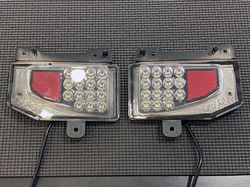

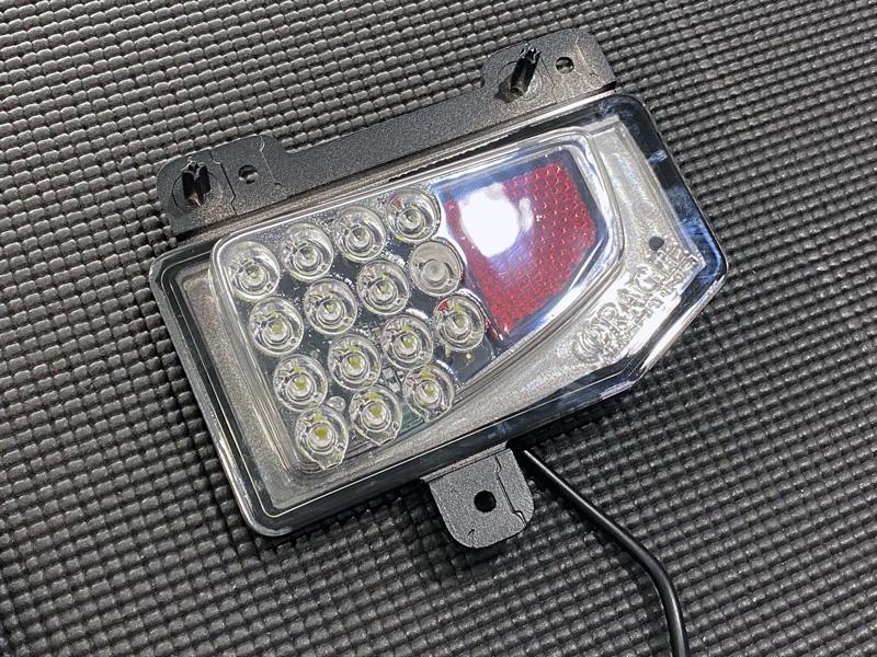

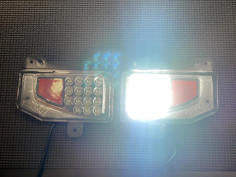

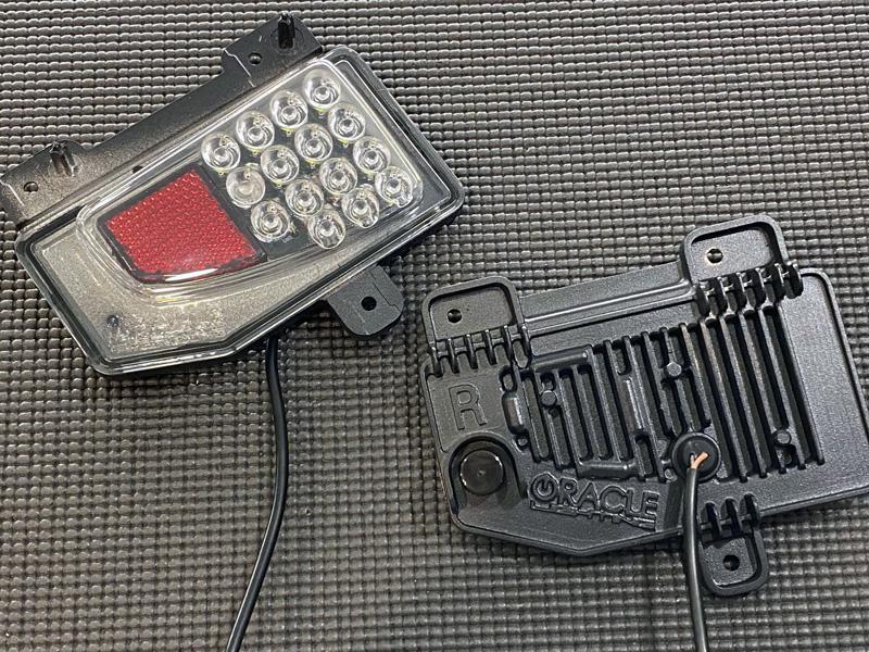

We have the prototypes assembled and are working through our initial QC testing process. So far everything is great, will post more updates as we work through additional testing.
Here are some photos.
Jeep Gladiator Auxiliary LED Reverse Lights (Integrated Rear Bumper) jt_rev1
Jeep Gladiator Auxiliary LED Reverse Lights (Integrated Rear Bumper) jt_rev2
Jeep Gladiator Auxiliary LED Reverse Lights (Integrated Rear Bumper) jt_rev3
Jeep Gladiator Auxiliary LED Reverse Lights (Integrated Rear Bumper) jt_rev4
EDIT: Remember these are prototypes, ignore the bad paint job, these are just for testing the final parts will look more finished and refined.
