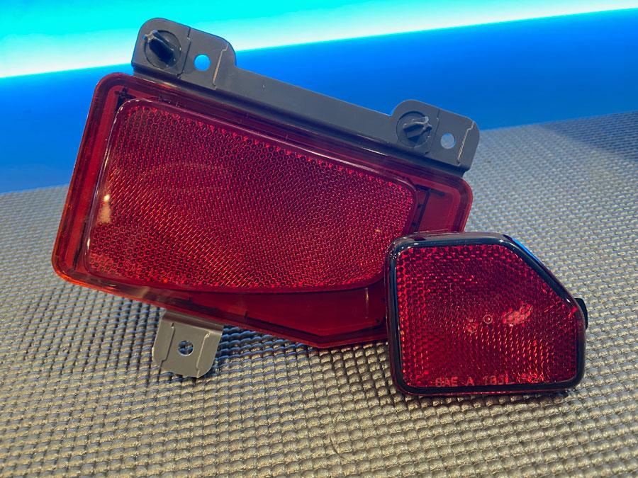

Great question,
We are working through the BOM for this revised design and examining tooling costs associated with this revision. The JL version retails at $99.95/ Pair but that is a much simpler design with fewer LEDs and without a reflector.
Here is a comparison of the factory JL part VS the factory JT part:
Jeep Gladiator Auxiliary LED Reverse Lights (Integrated Rear Bumper) IMG_2777
As you can see the JT is larger (increases material cost) and has a more complex design (increases tool cost).
Based on initial calculations, we anticipate approximately 40-50% increase in cost compared to the JL version. But with that cost the product would be brighter than the JL version and features the reflector which the JL does not and because of the large size and outboard mounting tabs- installation is going to be MUCH easier for the Gladiator compared to the JL.

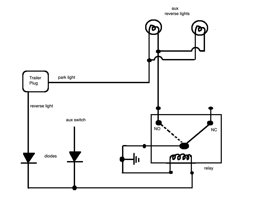

The Curt 56584 harness makes it easy to wire in reverse lights. It connects between the factory harness and the trailer plug behind the bumper. I used this, along with a few other Curt parts, to wire in the KC backup lights I added when I first got the truck.
https://smile.amazon.com/dp/B007EA6WQU/ref=cm_sw_r_cp_apa_fabc_83r7Fb4XC3RG2?_encoding=UTF8&psc=1
I did a DIY auxiliary reverse lights and might replace them with the Oacle integrated rear bumper lights when available.
That is the harness I used and modified for my reverse lights circuit to keep from having to tap into the Jeep's OEM trailer wiring.
For the aux. reverse light to turn on, my circuit requires [park lights AND reverse lights to be on] OR [park lights AND aux. switch to be on], the aux. reverse lights will not come on unless the park lights or headlights are on. I have the aux. switch configured for momentary operation so I don't accidently leave the aux. reverse lights on while driving.
Jeep Gladiator Auxiliary LED Reverse Lights (Integrated Rear Bumper) aux reverse lights
Edit: It would be simpler to just use the reverse light to power the auxiliary reverse lights, but my nature is to make projects more complex than necessary.

Ha Ha, the day I use a Raspberry Pi to control a back up light on my truck is the same day I start using CCTV for shaving in the morning. The Jeep is complex enough without another computer on board ?
