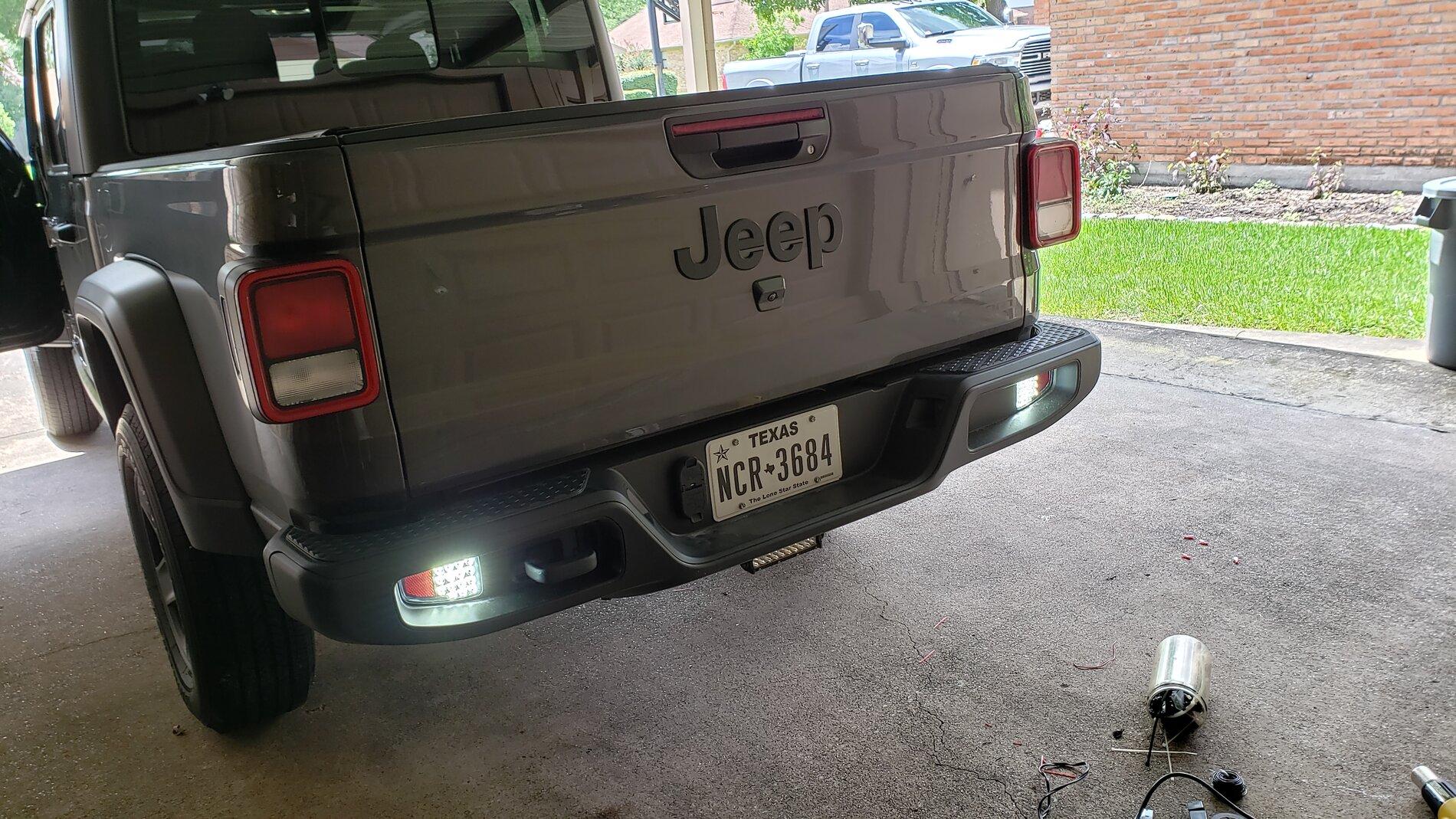

Putting mine in this morning. I agree with the previous poster that had to cut half of one upper guide pin off. I have a Sport S stock bumper. It won't go in without doing that. I'm wiring mine to aux 4.

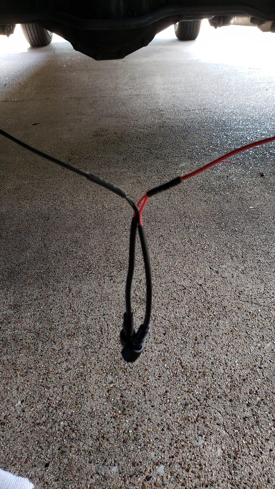

I'd love a "For Dummies" how to wire these to an OEM Aux switch.
Nothing to it. Find the bundle under the hood by the battery. Choose one of the two small wires. Run a wire from there under the vehicle tie strapping along the way. Tie that wire to the left and right red wires coming off the lights. Tie the black wires coming off the lights together and run it to a ground. Select battery hot or key hot in the settings area of the radio depending on how you want them powered.

Having the same issue looked at Oracle's video and the rear bumper they do the install on does not have the clip that secures the tread plate on the bumper. That's a bummer I don't to cut my new lights. They will not mount on a Sport S bumper with out mods.

My Mojave is the same...I didn't do much of an investigation on how to back that screw out (it may be possible) as I wasn't at all concerned about taking about 1/4" -1/2" off that post. As you can see, it's not a lot to remove
