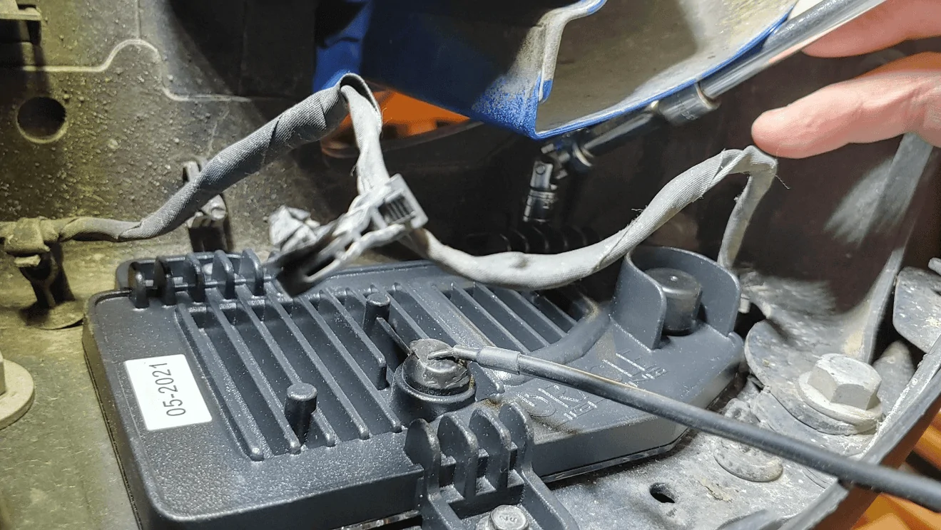

If only I had seen these! Look at that strain relief. Hmm…

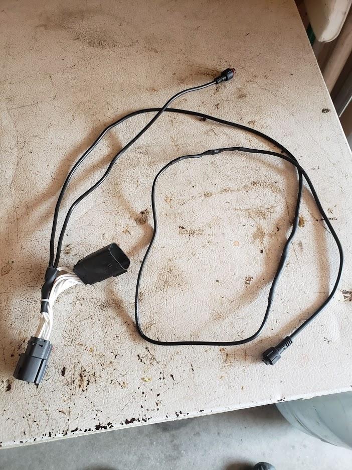

Got tired of dealing with the issues of the short wires, bad fitting, overly long extension wire. So I cut the long lead of the PnP harness in half and cut a section out of the extension and soldiered it into the passenger lead and put heat shrink on all of the wires, individually and as a whole. Then routed the wires out of the taillight cavity thru the bottom and then across so as to not have any contact with any edges. Done.
I really wanted to like the Oracles. They look like they came from the factory. But when saw pics like @ShadowsPapa posted and compared it to what you just posted, it was a no-brainer. The fact that I wanted them wired to an aux switch anyway, which the Vision X ones include a harness better suited for, AND they are almost 3 times as bright, AND they were on sale for almost the same price was just a lot of icing on the cake. I did grab some Peterson reflectors recommended by someone in an Amazon review, and will add that on too. Not quite as OEM looking, but I'll personally sacrifice some aesthetics for build quality. That said, I sure hope Oracle takes all the criticism in stride, and comes out with a V2 product more in line with their rep that finally addresses the strain relief and harness issues.
This is probably what I will do. Either this or I'll hook the driver's side to the PnP and the passenger side to an aux switch. If it's as bright as people say, one should be plenty at any given time.
