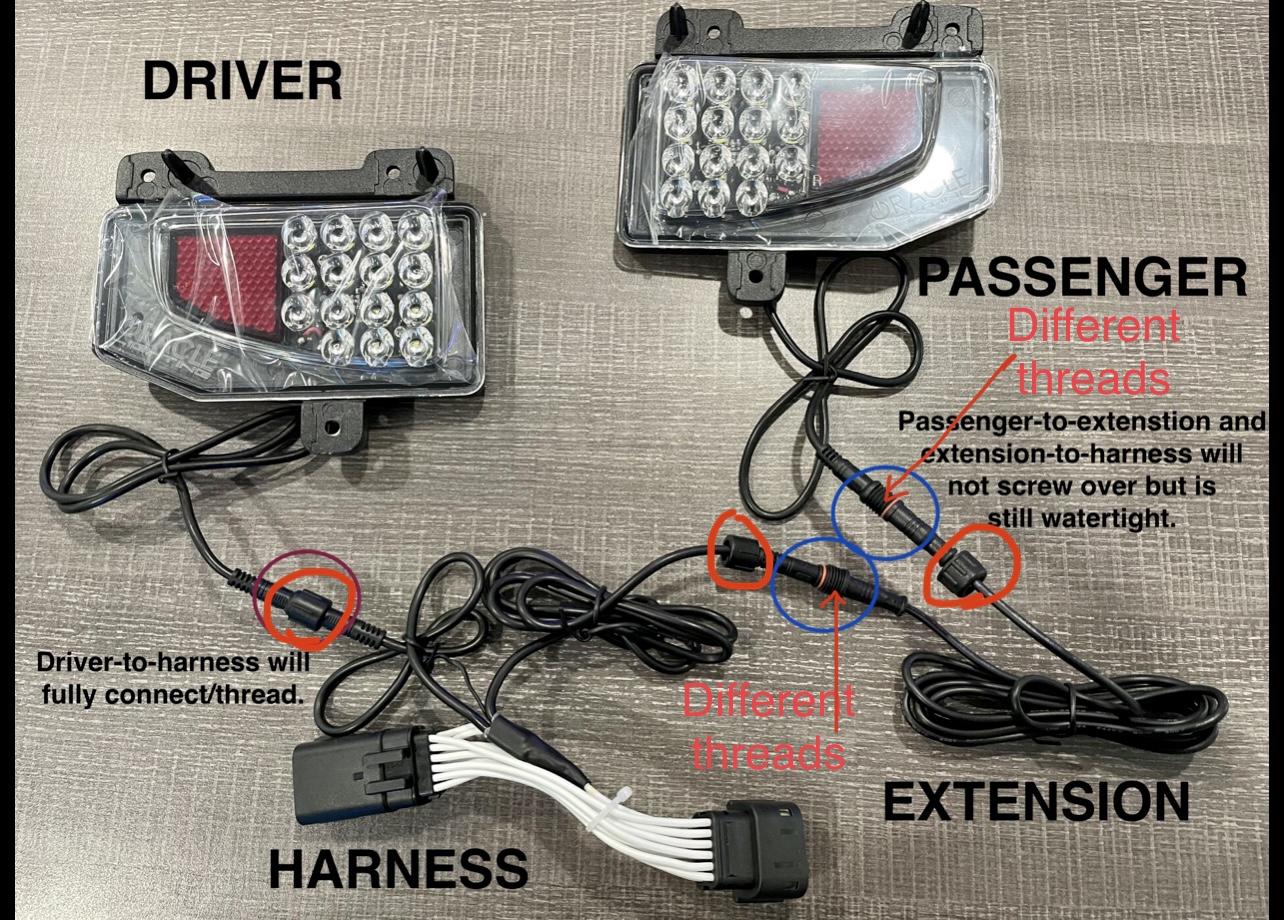

Hello everyone, jumping in here since it looks like some are having trouble with their extensions. The extension should go to the passenger side light.
When installing, be sure to line up the arrows on each side to ensure they fit together. The pin connections are the same. They will come together tightly.
Jeep Gladiator Auxiliary LED Reverse Lights (Integrated Rear Bumper) IMG_0807
Yes, the extension cable is 6" so it will be longer than needed, as noted in @JP_Oracle's original post quoted below. There will be extra cable to allow you to choose the path you wish. This extra can simply be bundled and secured with zip ties.

Lastly, the caps of the extensions will not fully thread over the connections. The caps are simply additional protection against pull-force, but they are not necessary for function. Please be assured that the connections are still IP68 waterproof. If you are concerned, you can wrap in electrical tape or heat shrink for more reassurance -- but again, the cap is not necessary for waterproofing as the ends fit tightly.
Jeep Gladiator Auxiliary LED Reverse Lights (Integrated Rear Bumper) IMG_08082
These two-pin cables are used for this so you do not have an additional wait time to complete installation, and they do function as intended.

The connector in question will only meet its IP68 rating with the threaded part screwed on to squish the internal O ring. Without the threaded part as shown in the first picture below, the connector can pull apart with a little tug. I just got out from under my truck working with these connectors and would never consider plugging them together and not using the locking ring, which cannot be used with the emergency supplied extension failure. In my opinion a length of hot glue heat shrink over the connector without the locking ring would be the minimum satisfactory solution providing both mechanical strength and sealing the connection.

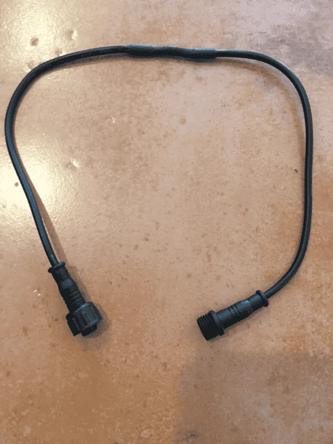

To add insult to injury, I carefully shortened up my 6ft extension cable to about a foot long before climbing under the truck and discovering the connectors don't fit. I may have to double my dose of blood pressure medication today.

The thread caps aren’t even the same size as those used for the original connectors in the pic @ORACLElights posted. EDIT: the thread pitch is different and can even be seen in the pic.
Yes, you are correct the thread pitch on these connectors is slightly different from what our standard connector uses. We wanted to provide a quick solution to those of you who were having cable length troubles and in our haste to resolve the problem we did not confirm the cap thread was a match to the cables on the harness. We apologize for the oversight on our part.
We do not have an "off the shelf" extension we can offer that matches the spec needed for this but we are willing to build custom cables for those who need them. All that we ask is that you understand that is that it will take some time to build these and ship them out. We are willing to build the adapters and ship at no cost to anyone who needs this. All we ask is patience while we have the parts built out, we are working with a large production backlog at the moment.

I could not even get one side to plug in, the other did, because the shell itself is a different size. The threads are different, and the shell.
I thought I'd try to make the connection and see what everyone was talking about and -
The extension plugged together with the right light side - the right light pigtail
but
the other end of the extension didn't fit together.
The nut and threaded area are not just a different pitch, but a different diameter. I could tell that before I even pulled the connection apart under the truck. I unscrewed the "cap" and held the extension up and saw different diameters.
