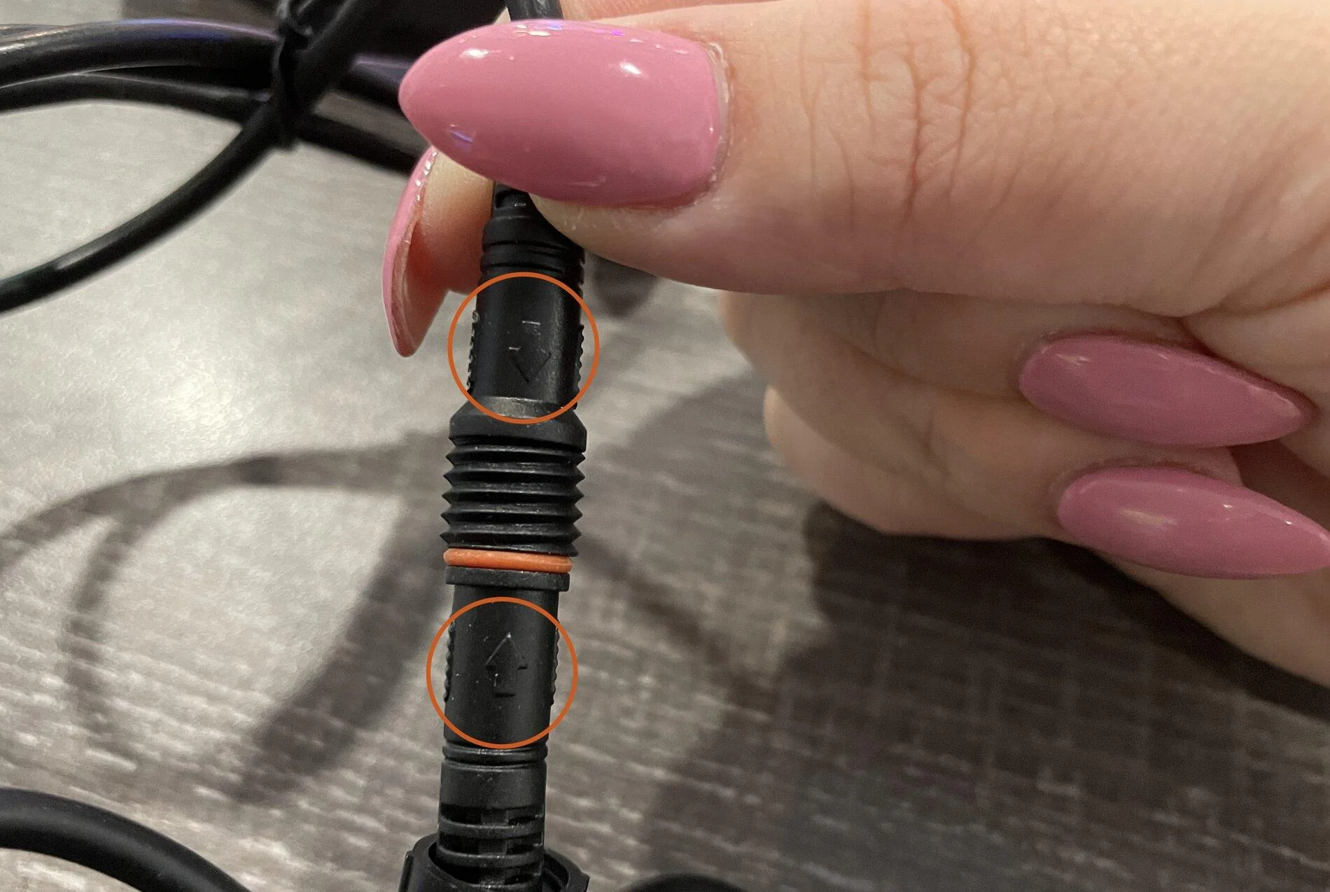

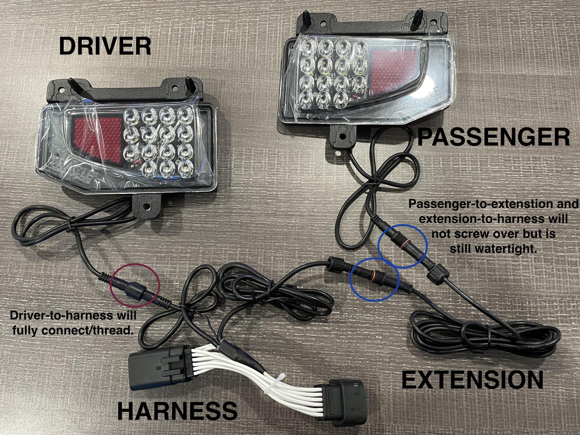

Hello everyone, jumping in here since it looks like some are having trouble with their extensions. The extension should go to the passenger side light.
When installing, be sure to line up the arrows on each side to ensure they fit together. The pin connections are the same. They will come together tightly.
Yes, the extension cable is 6" so it will be longer than needed, as noted in @JP_Oracle's original post quoted below. There will be extra cable to allow you to choose the path you wish. This extra can simply be bundled and secured with zip ties.
Lastly, the caps of the extensions will not fully thread over the connections. The caps are simply additional protection against pull-force, but they are not necessary for function. Please be assured that the connections are still IP68 waterproof. If you are concerned, you can wrap in electrical tape or heat shrink for more reassurance -- but again, the cap is not necessary for waterproofing as the ends fit tightly.
These two-pin cables are used for this so you do not have an additional wait time to complete installation, and they do function as intended.
If you have additional questions or concerns, please PM this account or @JP_Oracle for assistance.
-Rachel
