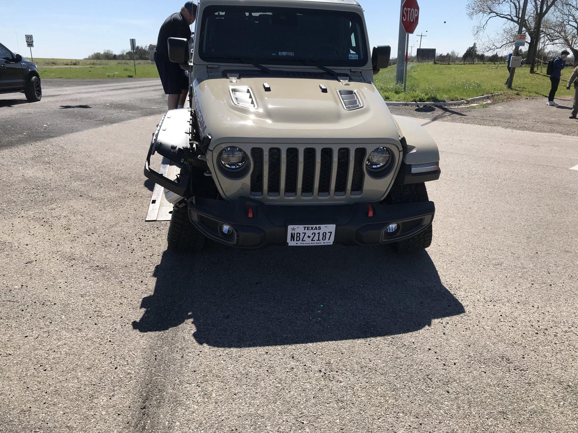

New to the forum and I have been watching the steering issue posts. I purchased my Gladiator in February of this year. I had no idea about this issue, as I had not been watching any of the jeep forums.
I drove an Over Land we picked out on the lot, got it on the Interstate and stayed with traffic for about 5 miles. I noticed right away the jeep would move from left to right continously, like a boat will head hunt at idle speeds. I commented to the salesman but he never answered me.
Long story short, they didn't have what we wanted and was about to leave when a transport pulled in with exactly the color and options we wanted. Made a deal and drove it home.
Two weeks later the wife and I were going to Tyler, Texas to a funeral when a A&M student ran a stop sign and we hit him in right rear quarter panel. Wound up costing $14,000 to get it fixed. Broke the front axle housing and axle half in tow. Shop did a great job on repair and we have been driving it for about 4 weeks.
Our JT steering does wander and is a bear to drive under certain road, wind, etc. conditions. I stopped by the Jeep dealer and talked to the Service Manager about the issue. This is a pretty new dealership. The service manager told me that they have not had anybody complain about the steering, but he also said they don't have many new JT's out there yet. He told me when I bring it in for first free oil change they would make a service write up on it and assign it to their best tech. He also said we could drive any of the new ones on the lot or all of them if we wanted. They have a bunch of them for sale.
Following closely and hoping Jeep steps up and does the right thing. Hope it doesnt have to result in fatality's before the problem is addressed.
Thanks for the opportunity to post.

No, the passenger side, bumper and tire took the hardest blow, broke the passsenger side axle tube and axle in two, bent all of the control arms, track bar, shock, bumper . That was it for the most part. The fender was knocked off, and believe it or not, no sheet metal damage not even a scratch. Crazy.

Sorry I wasn't clear, but I had the problem day one, the wreck was not the root cause. It was not any worse after the accident, about the same. Hope that helps.
