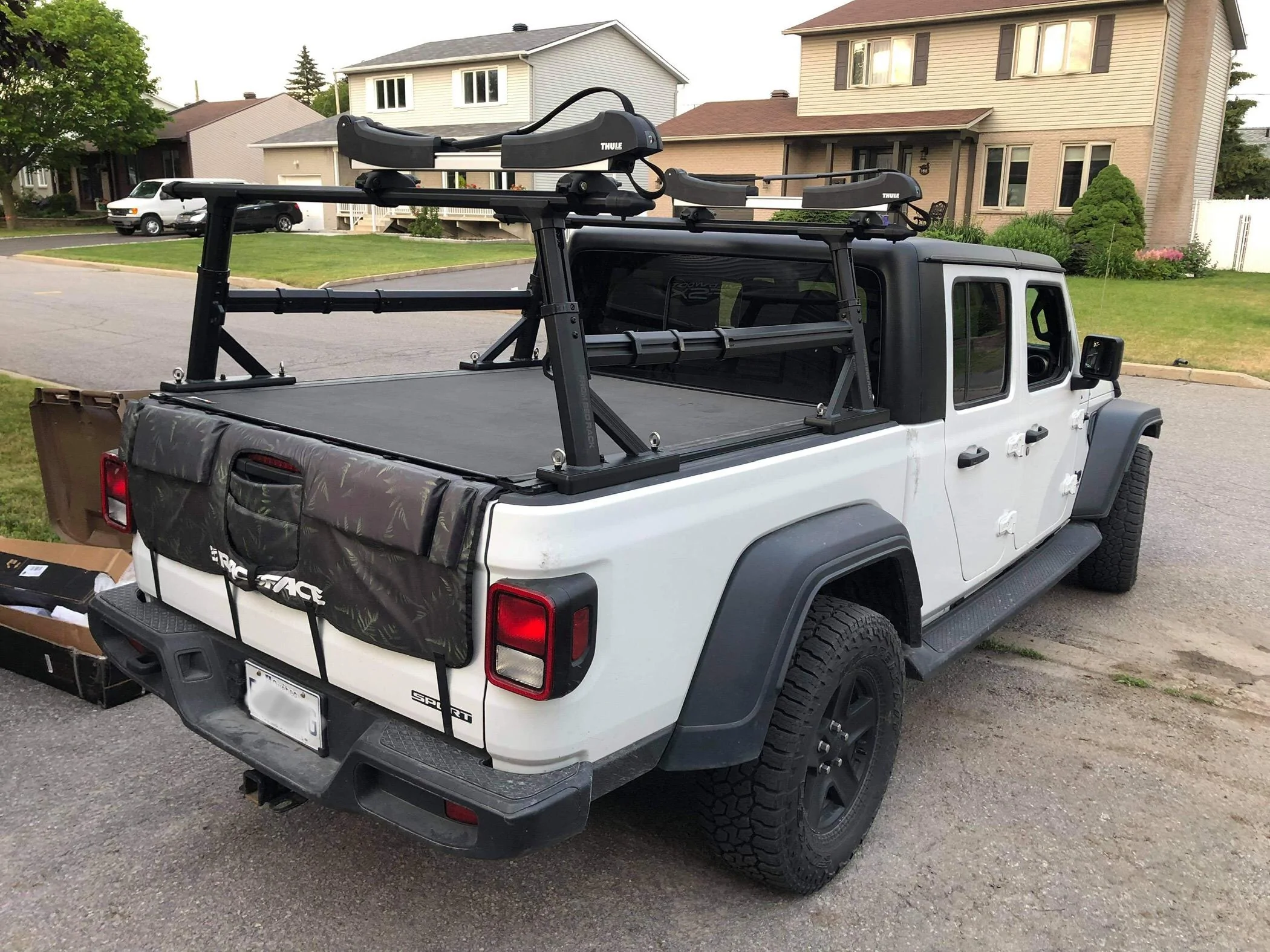

BAK x4 Revolver rolling tonneau Install and review

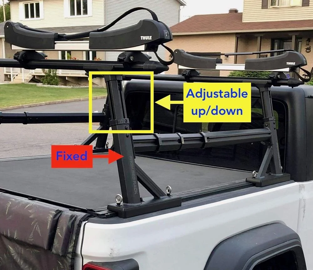

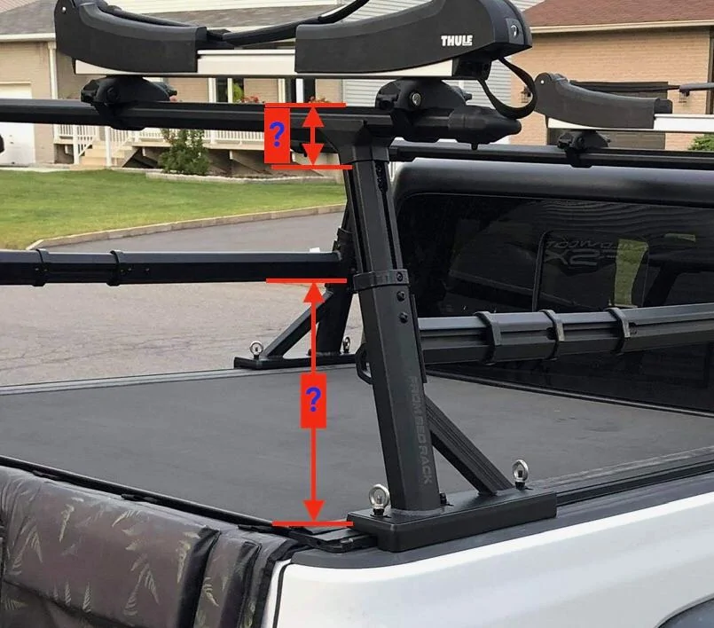

Can it be run in a lower position so a RTT can be level with roofline?
kad's_Glad
Rufus
Jul 19, 2021
212
256
Pacific Northwest
'22 Mojave - Sting Gray

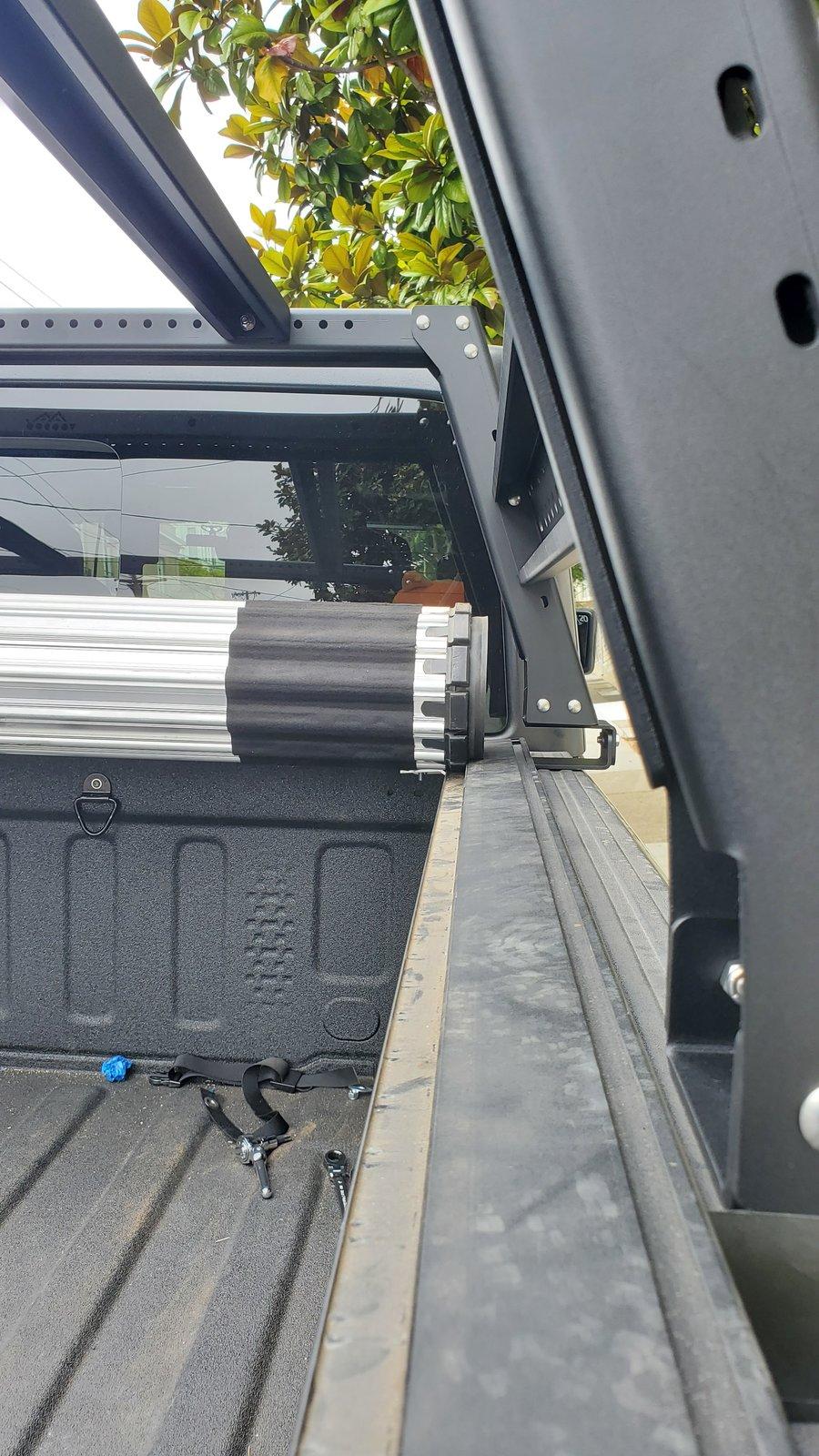

I haven't decided whether to go with this one yet, but from what I've researched the legs are made up of two parts with an upper tube sliding in/out of the lower tube. The website claims 15 inches of adjustability in the upper part. The height adjustment is in the boxed area:
Jeep Gladiator BAK x4 Revolver rolling tonneau Install and review FRDM Rack Adjustability
Just estimating from the picture the crossbar would be below the top of the back window by a couple inches when in the lowest position. Would that be enough for your setup?

what is the functionality of the foam pieces on the underside? just to keep it from touching itself?
Fcmalie
Dec 8, 2018
584
528
Ripon, California
2018 JLU, 2021 Mojave
I think they are supposed to stop it from hitting the rear window, I have a soft top so never worried about it.
arskemp
Andrew
Jan 9, 2022
325
729
Northern CA
22 Sarge Green Mojave
IT
That's what I saw in a BAK install video for this. If you roll it up loosely then it has the potential to bang against the hard top window so they provide foam pieces for that. To be honest though, I had to be real intentional about haphazardly rolling it up to get it to the point where it tapped the window while being strapped down. Personally, I can't see it ever occurring the way I normally roll it up.

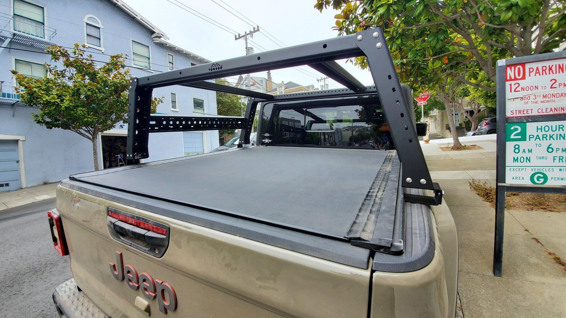

I'm using the Xtrusion-Overland rack with my Revolver X4s. They have brackets specific to the X4s and it allows you to run an 8" longer rack than their standard Gladiator rack. I did lose maybe an inch of roll at the end, but I need to adjust my tonneau to get it centered better too.
@Fcmalie this is exactly the setup I'm looking to switch to...just one question I can't find the answer to...what is the inside bed clearance between the X4S rails? I tend to haul plywood from time to time and want to make sure I have at least 48" between the rails so that I can slide plywood into the bed with the tailgate up.
Also, what height Xtrusion rack did you go with?

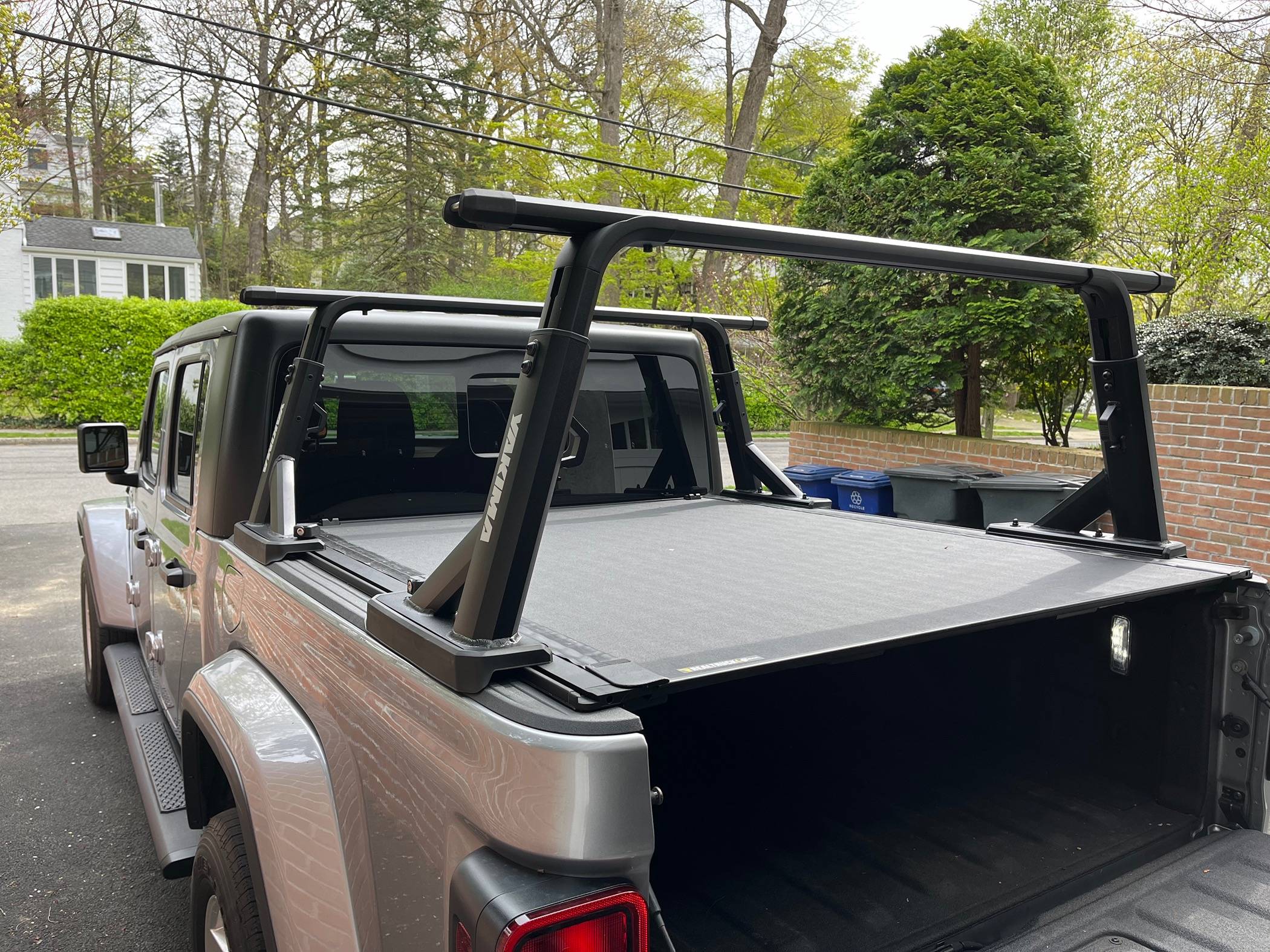

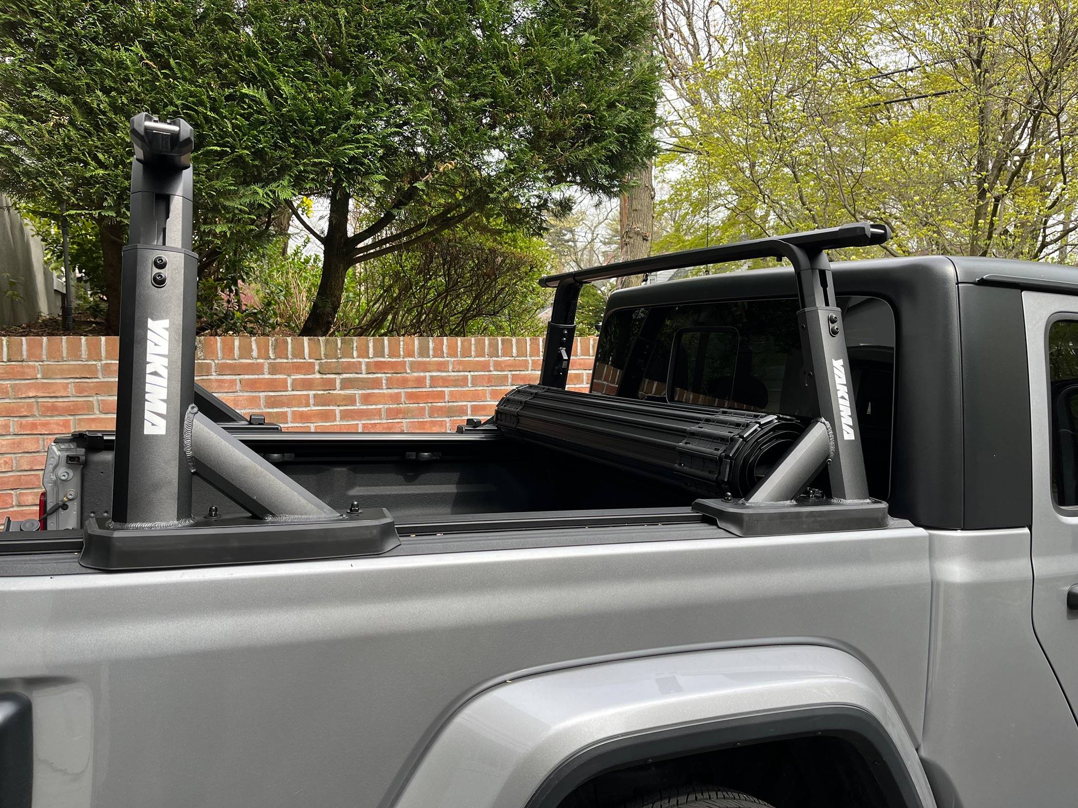

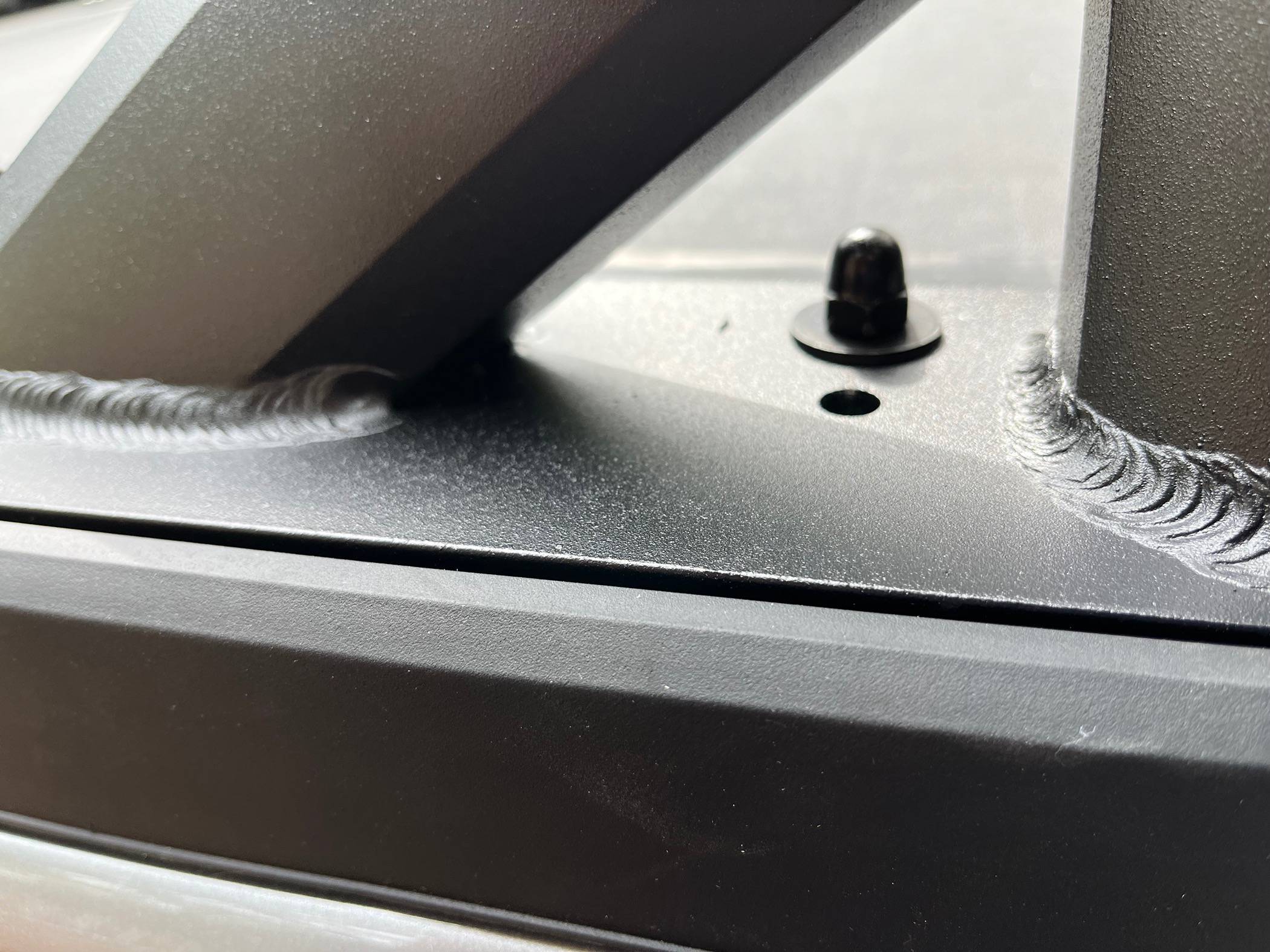

BAK x4s and Yakima Overhaul HD install. Works with new holes drilled (easily) on the tower bases.
Jeep Gladiator BAK x4 Revolver rolling tonneau Install and review IMG_1234
Jeep Gladiator BAK x4 Revolver rolling tonneau Install and review IMG_1231
Jeep Gladiator BAK x4 Revolver rolling tonneau Install and review IMG_1232
Jeep Gladiator BAK x4 Revolver rolling tonneau Install and review IMG_1233

Herkimer - can you verify that you used the Yakima Tonneau kit 1 ? and what was the spacing to drilled holes from the factory hole? Does that seem to have enough support on the outside edge - or with the crossbars in place there is enough structure to the rack to lock it from moving?
Thanks, Timroy.
