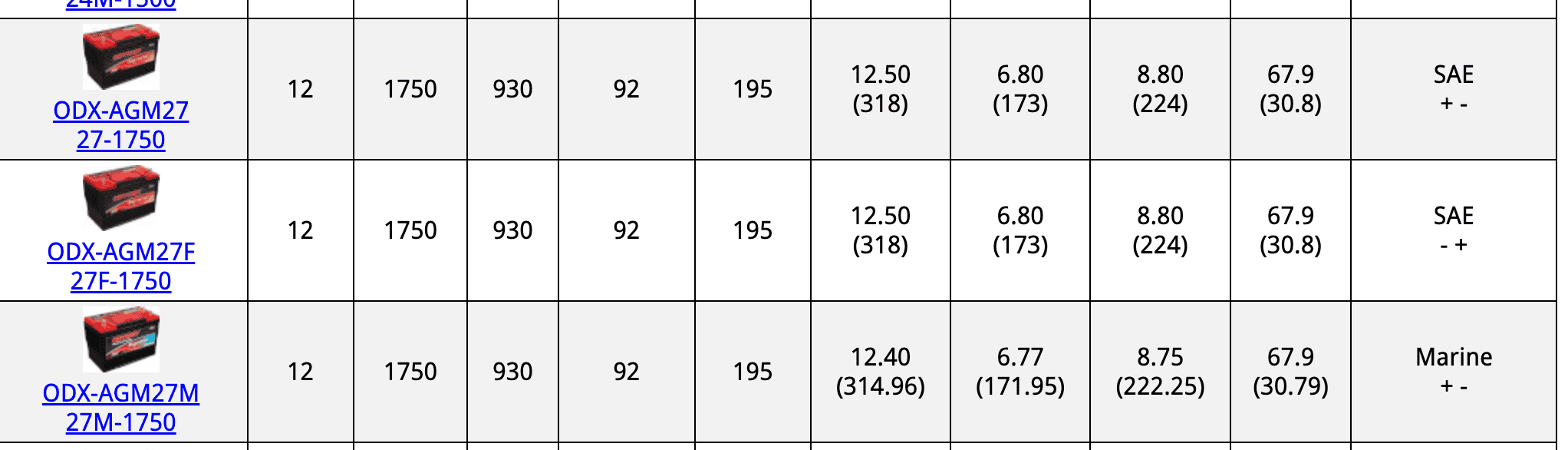

So it looks like H7/94R batteries fit fine, Odyssey doesnt make one in the Extreme line though, only the performance, however dimentionally it looks like these Odyssey Extreme Group 27 batteries should be the same thing? Do those fit?

If the Group 27 fit, there would be a lot of threads about it, and a note in the owners manual. It's not just physical size, but the location of the battery posts. The 94R has the posts reversed, which is why it carries the R designation after the Group Number.
Good info, thanks, didn't realize the posts would be on the wrong sides...
