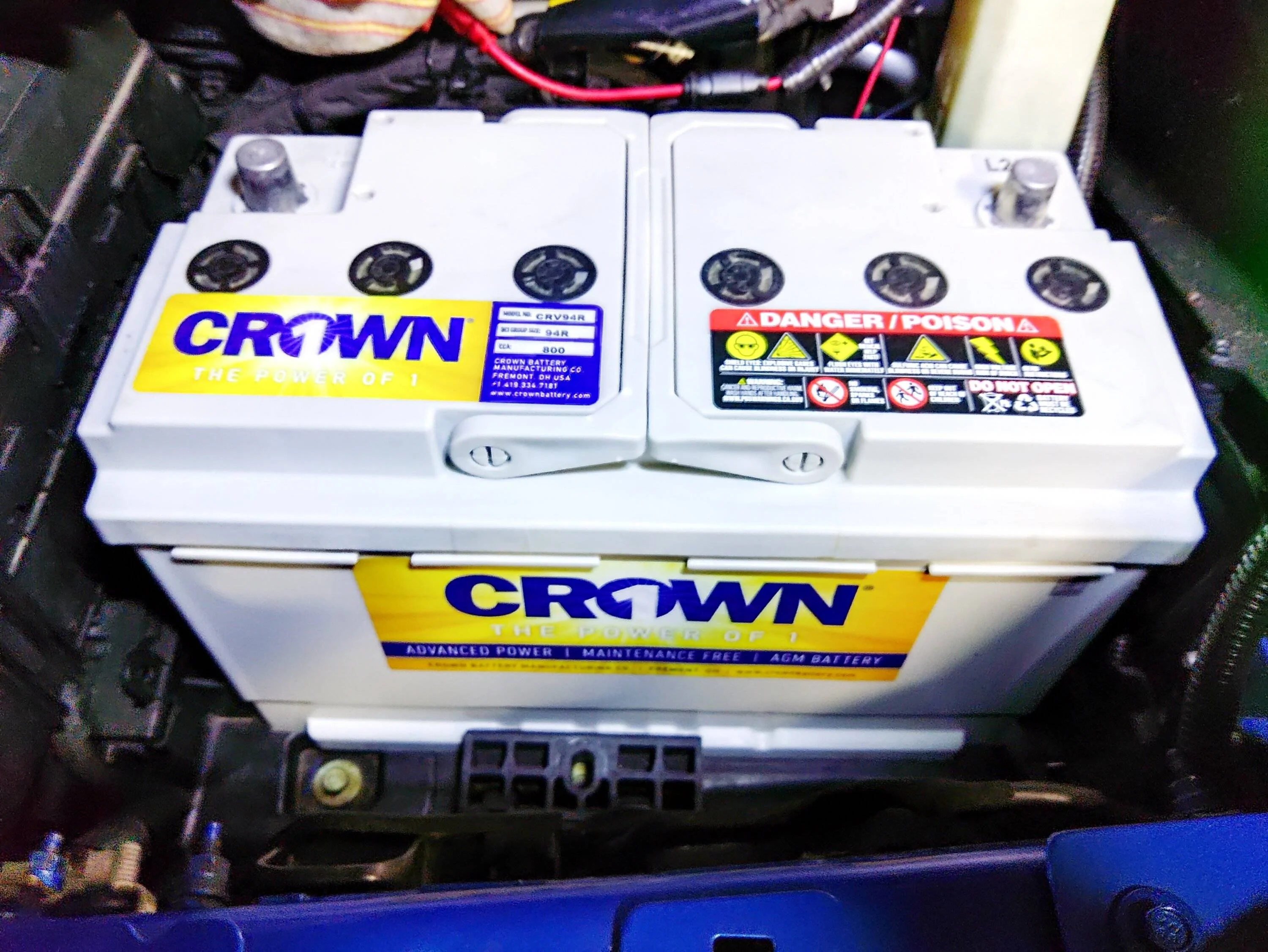

For reference, the original MOPAR battery was rated at 75Ah, 700CCA, and Reserve Capacity of 120 Minutes.
Replaced my original main battery with a Crown CRV94R.
Jeep Gladiator Best / Largest main battery? KIMG0647
The Crown is rated at 80Ah, 800CCA, and Reserve Capacity of 160 Minutes
With the added bonus that it is 100% made at Crown's main manufacturing plant in Fremont, Ohio.
Just as an added note for what it's worth.
Replaced the Auxiliary battery at the same time with a Super Start Platinum AUX14 from O'Reilly Auto Parts.
I know there has been discussion on the battery threads about using the NAPA AUX14 battery.
I found that the NAPA AUX14 only has a 30 day warranty which I think is pretty lousy for a $130 battery.
The Super Start from O'Reilly is made by the same manufacturer as the NAPA battery, and has a 1 year warranty for $119.

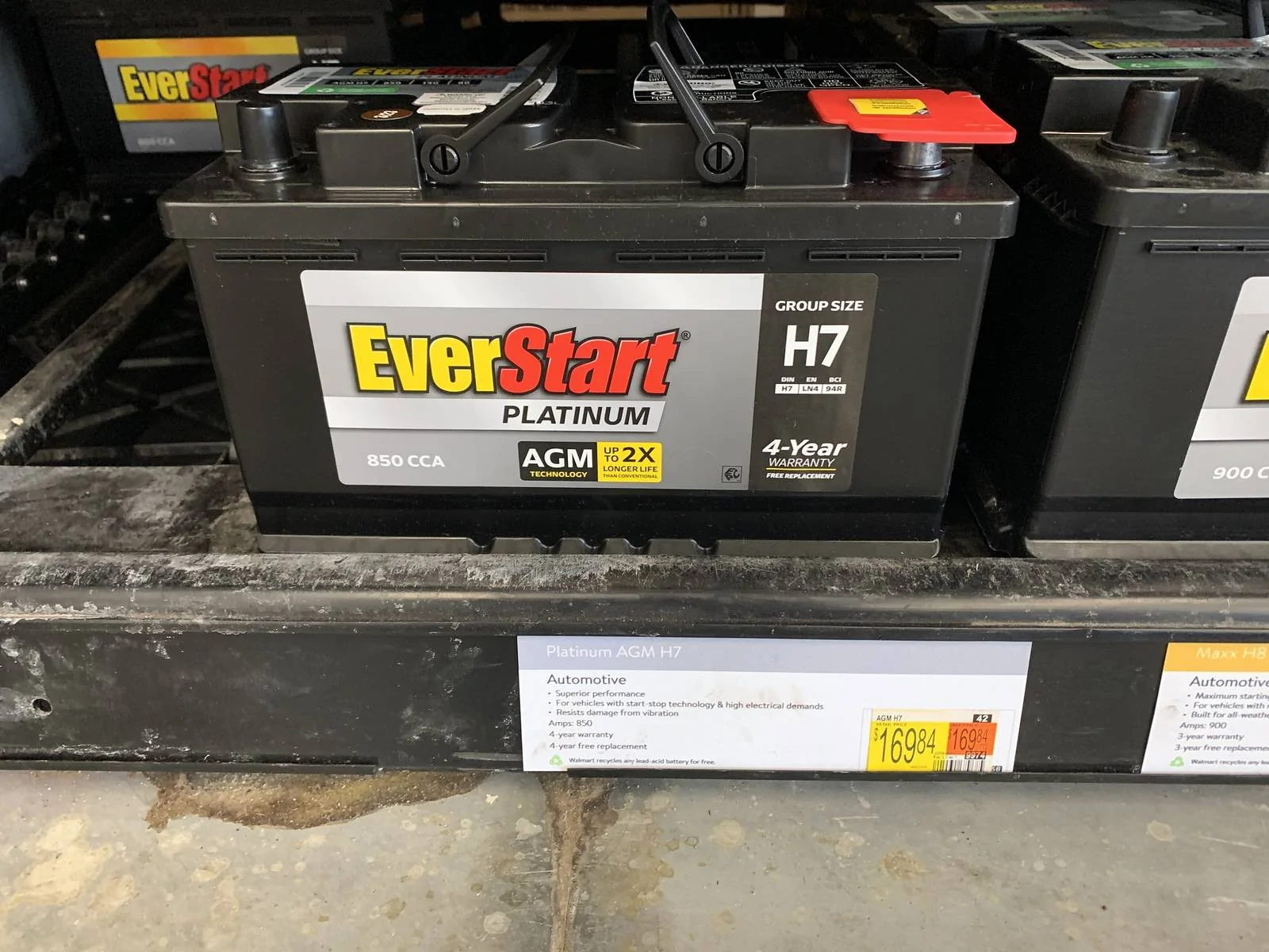

These threads are fun to read. The old wives tales come out so fast. In my experience, my Gladiator works on one battery exactly like it works on 2. The difference is I have gotton rid of a couple of the possible trouble points and now I can look at the dash vooltmeter and the info is menaingful. I haven't had any warning lights or codes.
All the battery recommendation are interesting too. There are just a few things that you can find to make a judgement on battery quality - Warranty, Cold Cranking Amps (CCA), Amp Hours (AH). Amp hours is not worth much because most of the H7 AGM batteries are tested too 80AH.
I am running a Walmart Everstart H7 - 4 years of warranty (good at Walmarts everywhere) and 850 CCA. The single Walmart battery is virtually the equal of the 2 Mopar batteries.

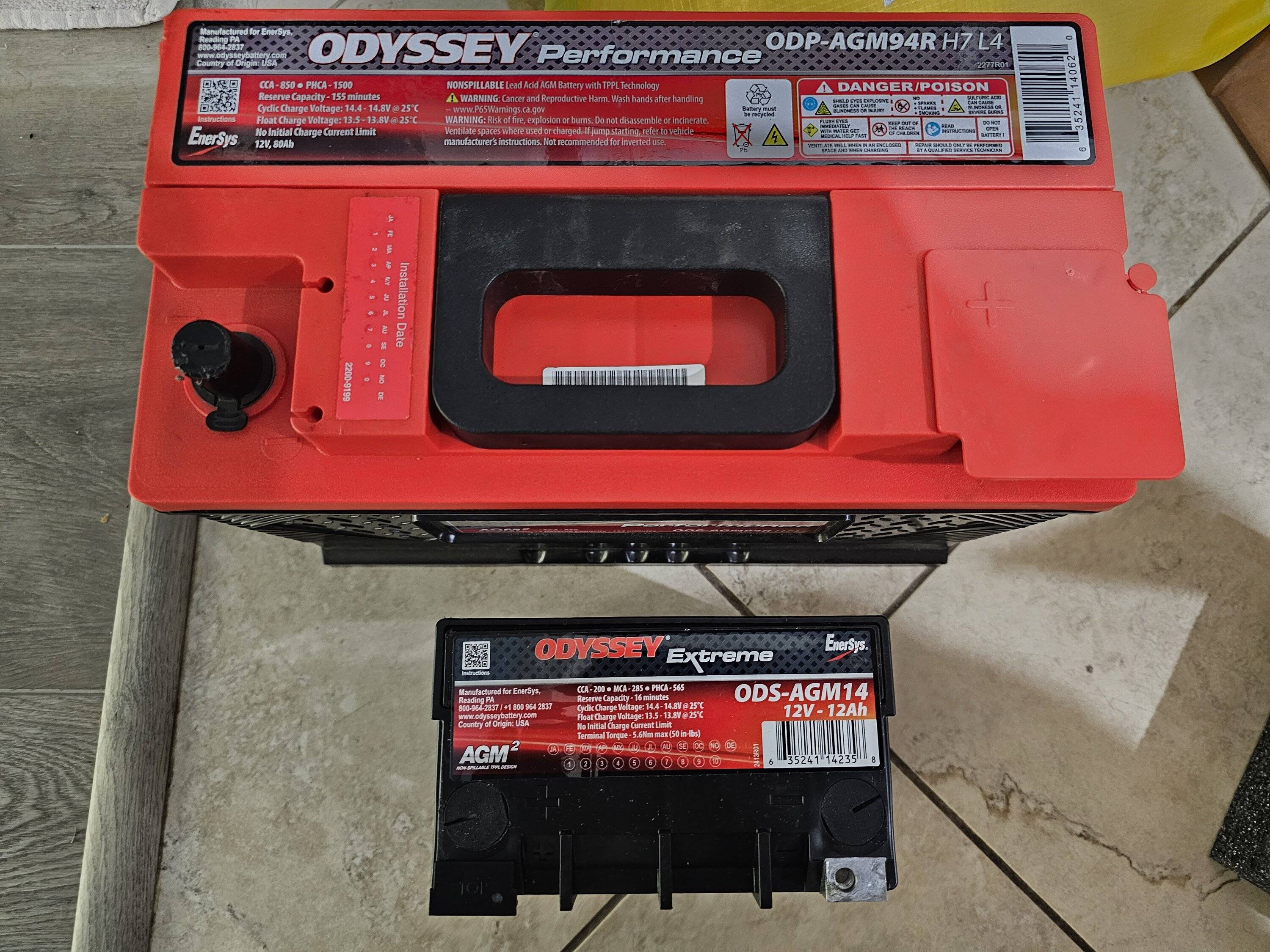

EDIT: DON'T buy the Odyssey AUX 14. Bastard isn't compatible without multiple mods.
Bought a pair of Odyssey today. I will be the first to tell you if they suck. I was happy to see Odyssey now produces a 'performance' motorcycle battery in our form factor for the Aux.
I don't believe the ESS system is the problem, it's the trash OEM batteries. We will see. I'm not going to delete the Aux battery even though I am completely capable of doing so. I installed the OEM trailcam...I can pull a fuse and tape off a cable. ;)

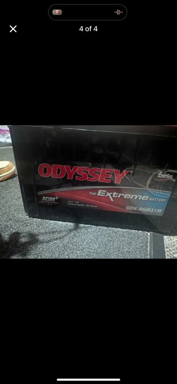

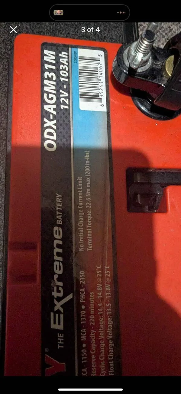

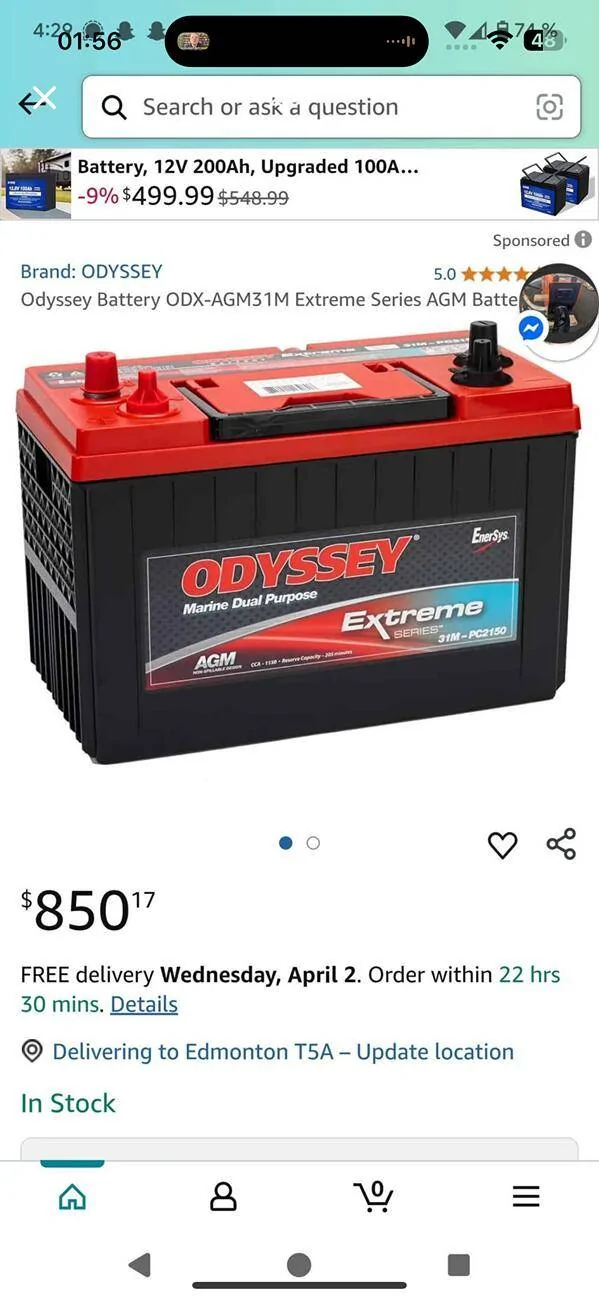

Does anyone know of this battery would work in my gladiator? I am hoping to replace my OEM battery and replace it with a better one because I am using my winch very often.
Jeep Gladiator Best / Largest main battery? IMG_2513
Jeep Gladiator Best / Largest main battery? IMG_2514
Jeep Gladiator Best / Largest main battery? IMG_2512
KevinC
Feb 6, 2021
846
1,620
Central Florida
2023 JT Mojave Sarge
Hard Labor
The largest that will fit without modification is the H7/94R. The photo you posted is a 31M.
