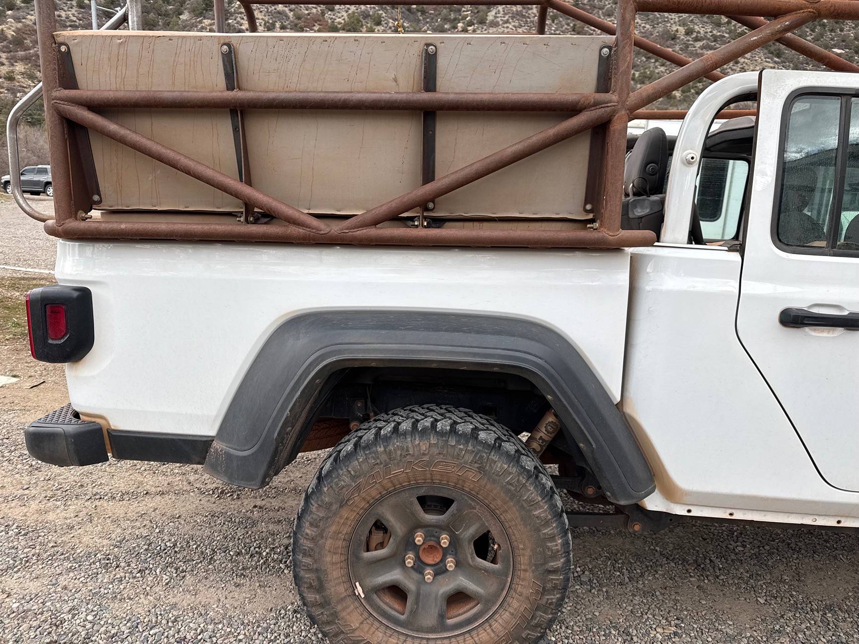

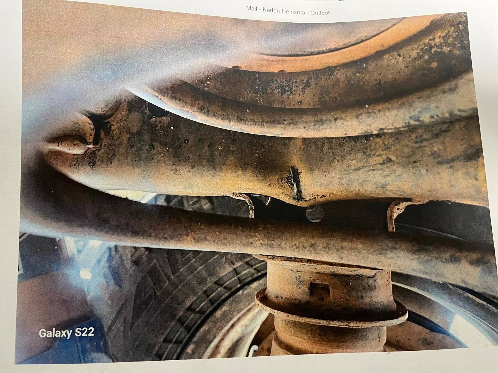

We have five Gladiators in tour service, two in Moab. One of the Moab rigs has a broken frame on both side in a weird spot, right in the center of the upper bump stop cup bracket. You can see the bend by the gap between the bed and the body in the first pic. Second pic shows the crack on the inside of the passenger side of the frame, the cracks are same both sides, but worse on the passenger side outside of the frame.
Obviously the driver/guide hit a ledge or something too hard, bottomed it out with a load of guests in the back. Local shops say most likely we'll have to replace the entire frame. Has anyione else had this happen or heard of this? New one on me.
Find a good welder have him repair it and put in some type of gusset or support to strengthen it I broke my frame on my Lj years ago had a guy in Ft.collins ,Co Repair it been fine every since no issues

We have an ace welding shop here, guy that made our seating setup. He'd eat this up.

Brad at Trailrecon had a video addressing this weak spot in the frame.
There is a guy I believe in the LA area that makes reinforcement brackets for that aria.
It is Shift auto works.

The two options I have found. I'm going with a combo of the two this week.
https://shiftautoandoffroad.com/products/shift-reinforcement-bridge
https://redordeadfab.com/products/gladiator-frame-plates
