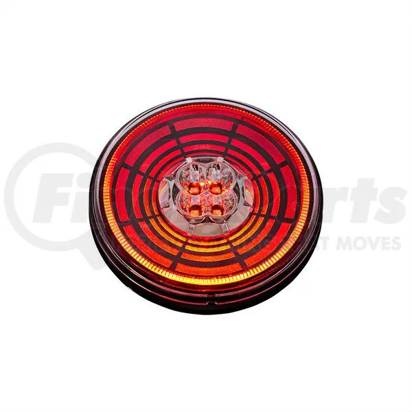

The Max bilt are 5" lights. Don't think I can make them fit... But I didn't realize they can be surface lights with no depth. That might allow me to move them closer to the tail gate and make everything fit.
Maxbilts look a lot like the ORO

I might be able to make the squares work... But we really are mainly limited to a max of 4 inches. The squares are 4.5 inches... But I may be able to fit them.
The first link, lights are 5 inches. There is no way to make them work unfortunately.
That's too bad, I've been thinking along the lines of making something using the Grote 54702 which includes the reverse light, but I hadn't gotten around to measuring anything.
I guess 6" long won't fit? They are only 2.25 wide, so it might be possible..
https://www.grote.com/signal-lighti...il-turn-lights-with-integrated-back-up/54702/
Yes these lights work fine because of the width. These lights are what the combat off-road gunner lights come stock with... So yes these will work with the oval trailer light version no problem.
