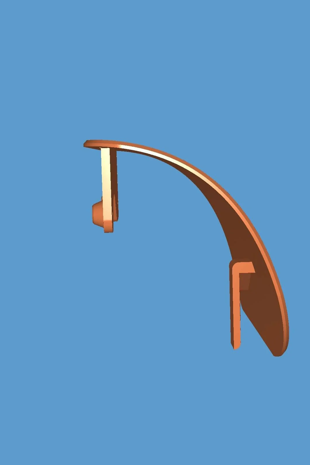

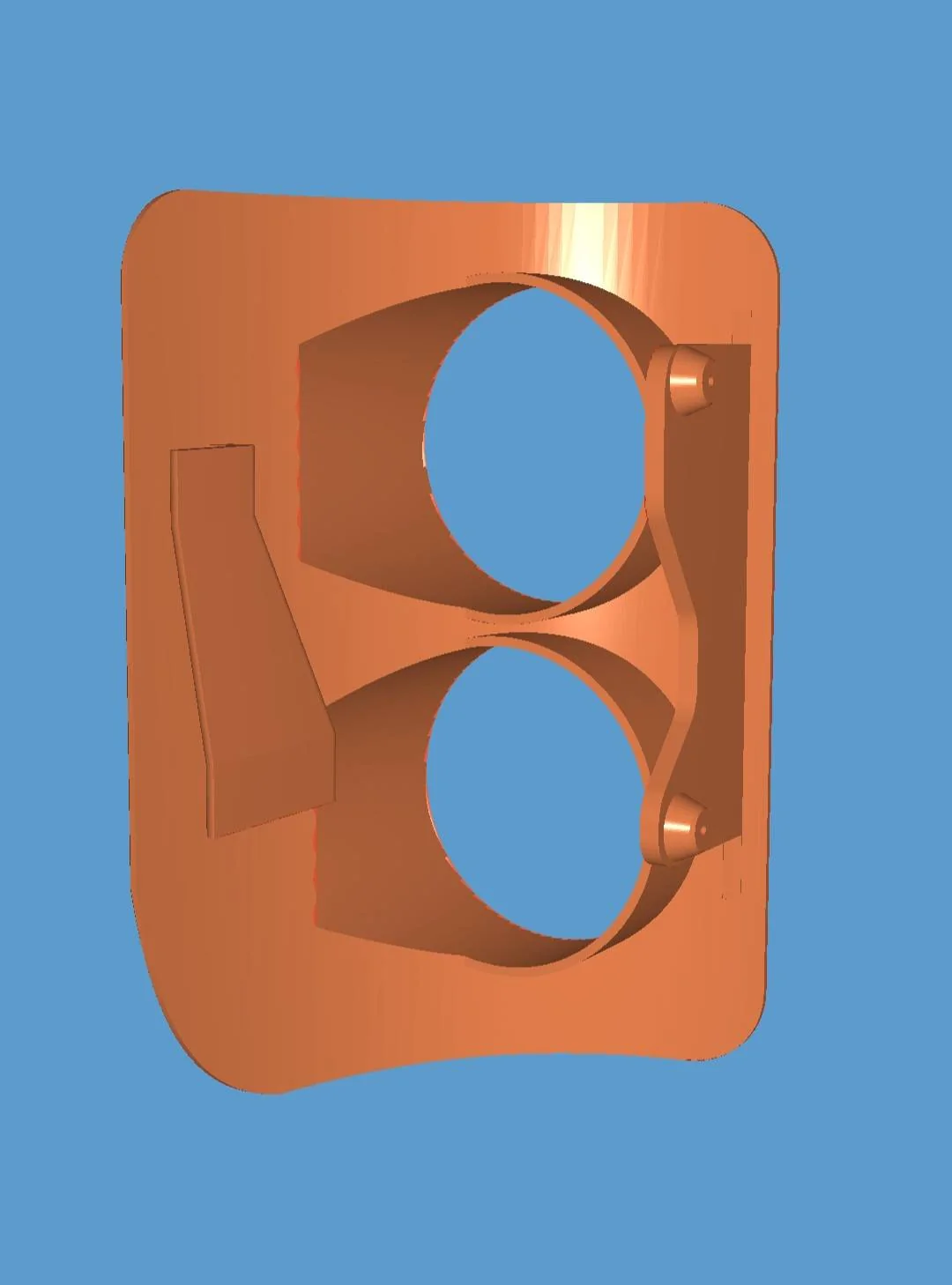

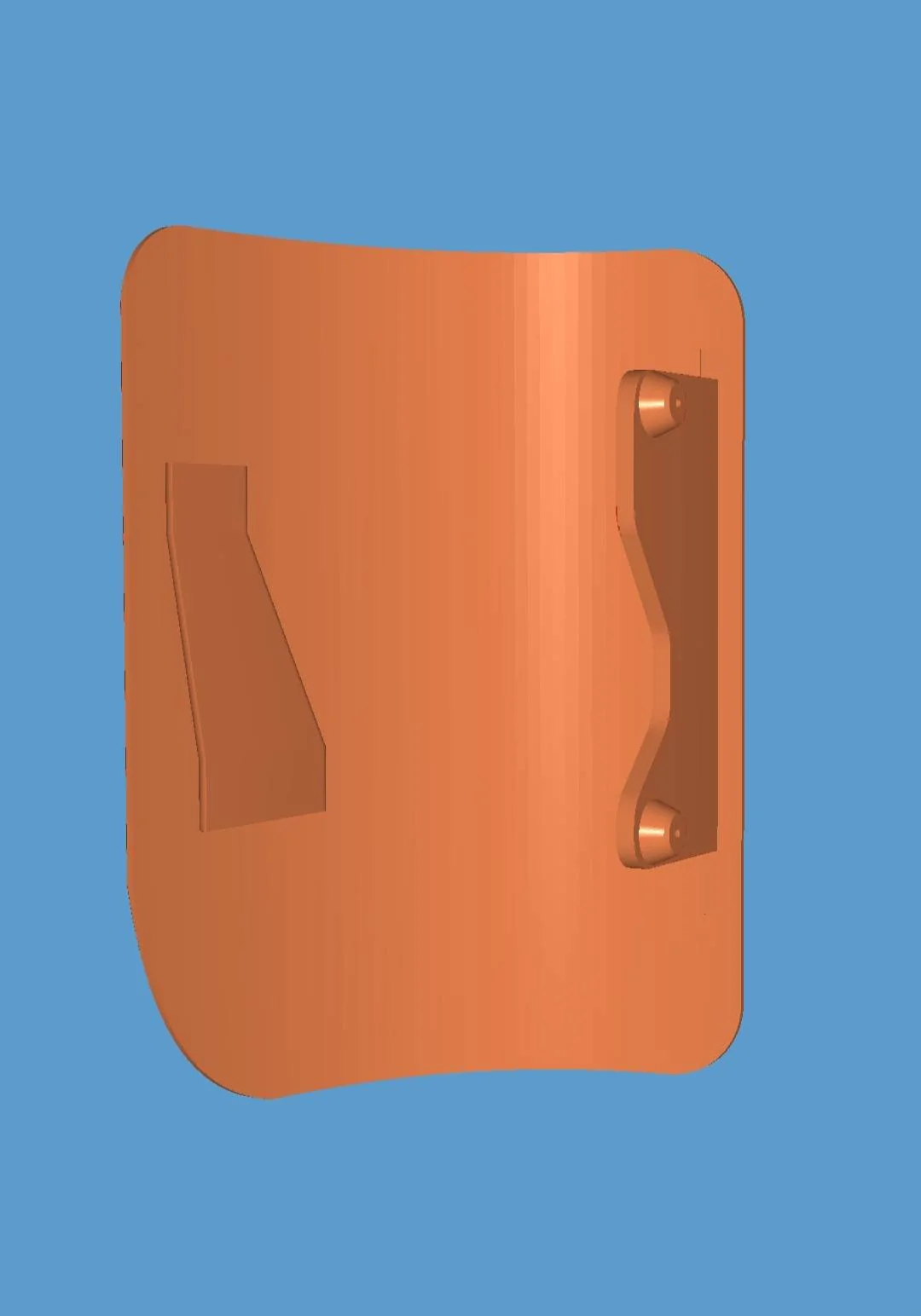

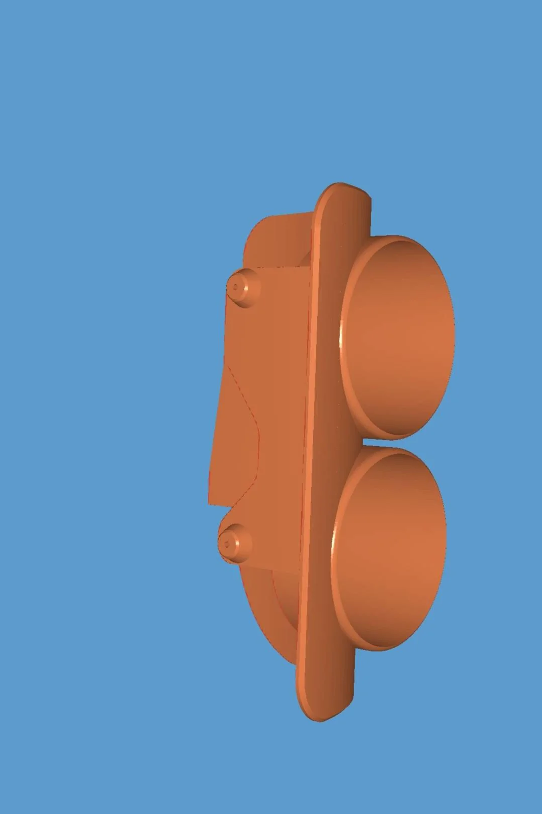

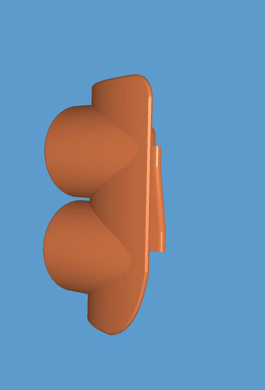

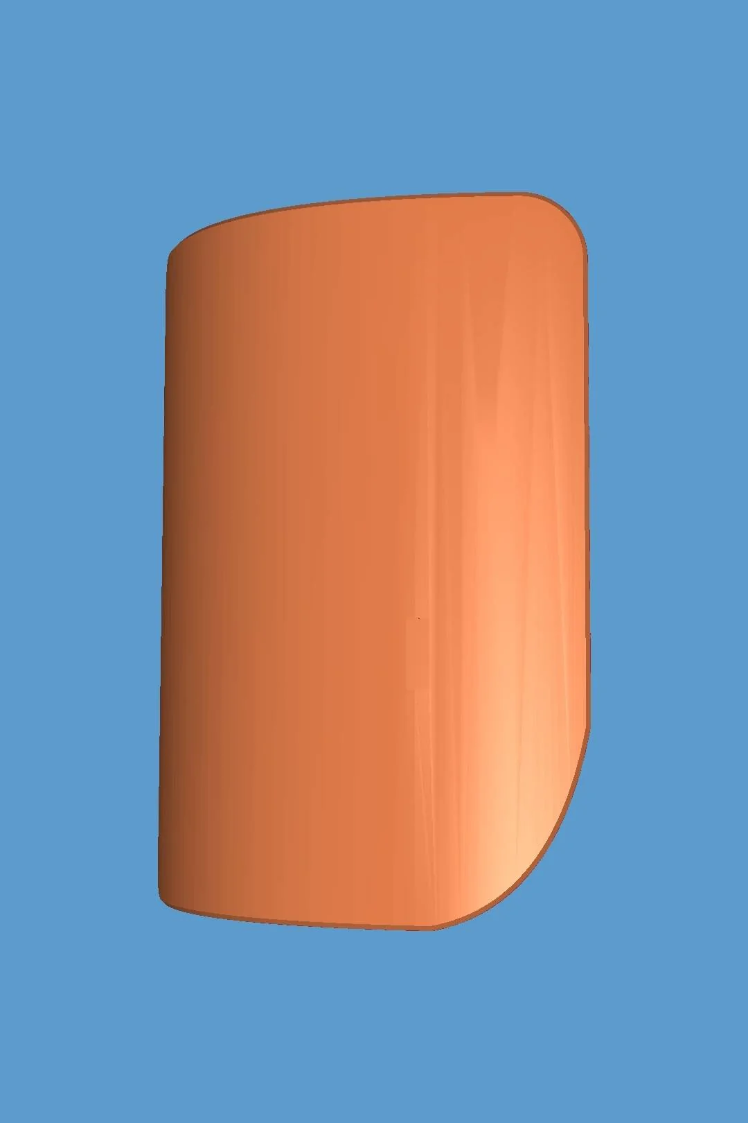

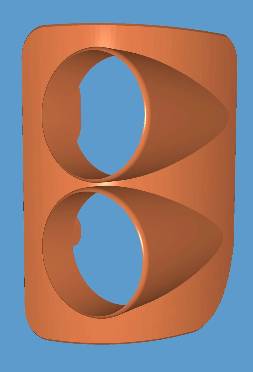

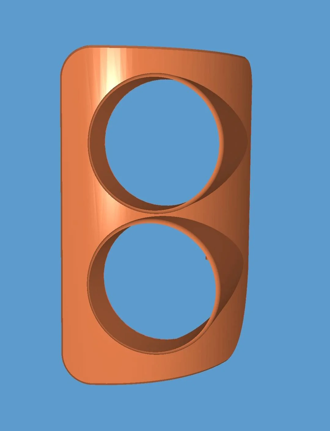

So you would just want this?
Basically. It would be nice to have a blank slate to put whatever light in there we wanted, but, now that I think about it, molding it for the design you have (seems like (2) 2.5-3inch lights) isn’t A bad idea either
Justinswidebody
Dec 21, 2022
463
1,142
Ocala
Jeep gladiator

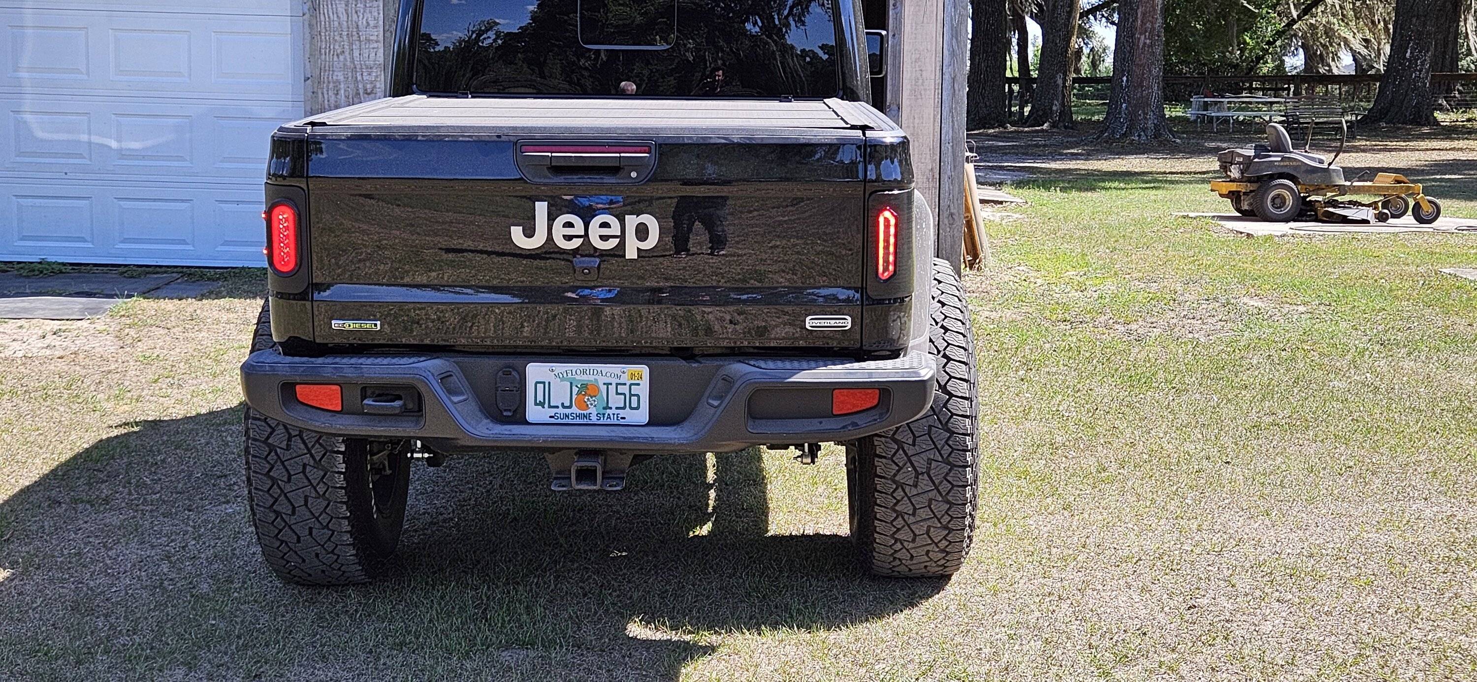

Unfortunately there is no flatness to the blank to be able to put a light. You would literally need a 1 " wide light strip to be completely flush. That's why all my designs have the lights protruding out and not completely flush.
Jeep Gladiator Building my own flush tail lights Screenshot_20230423_191809_Fast STL Viewer

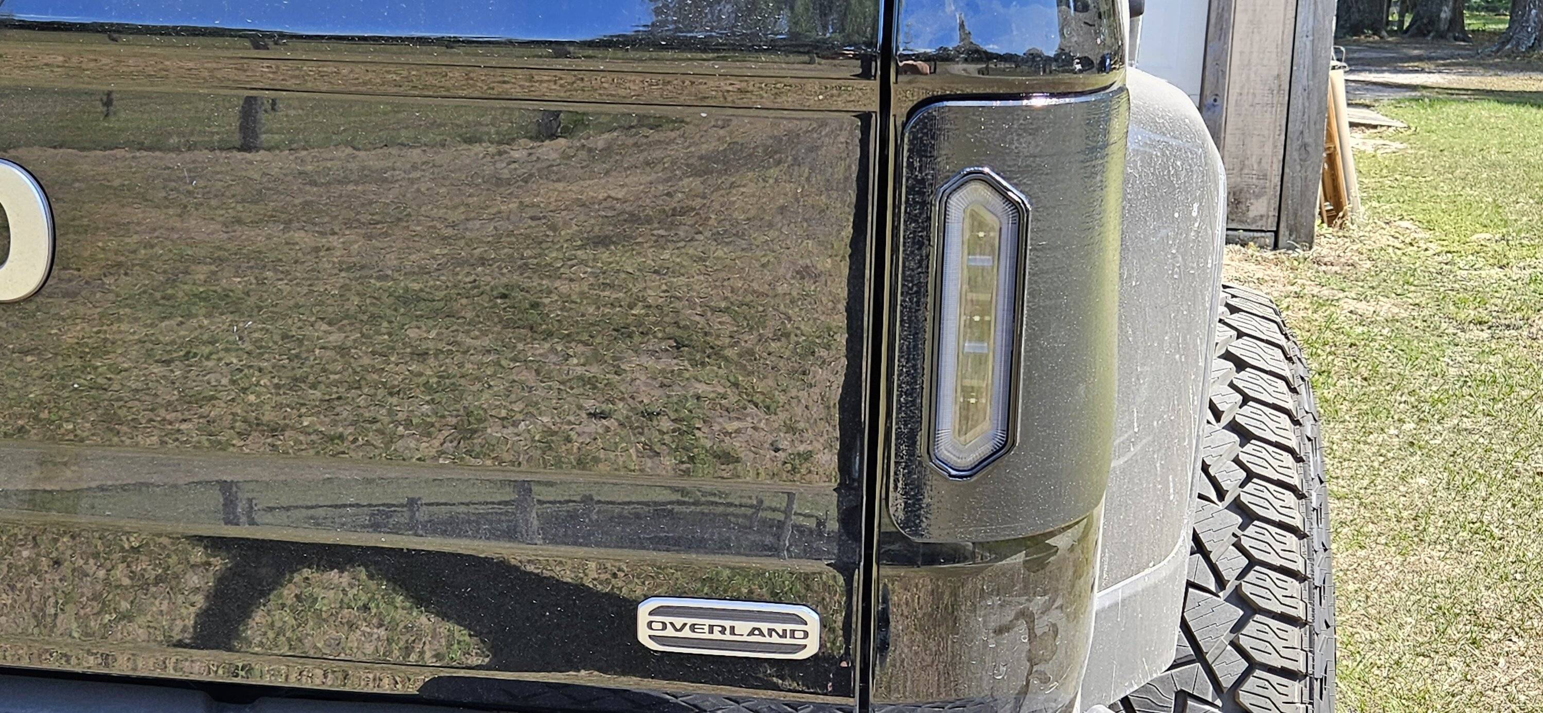

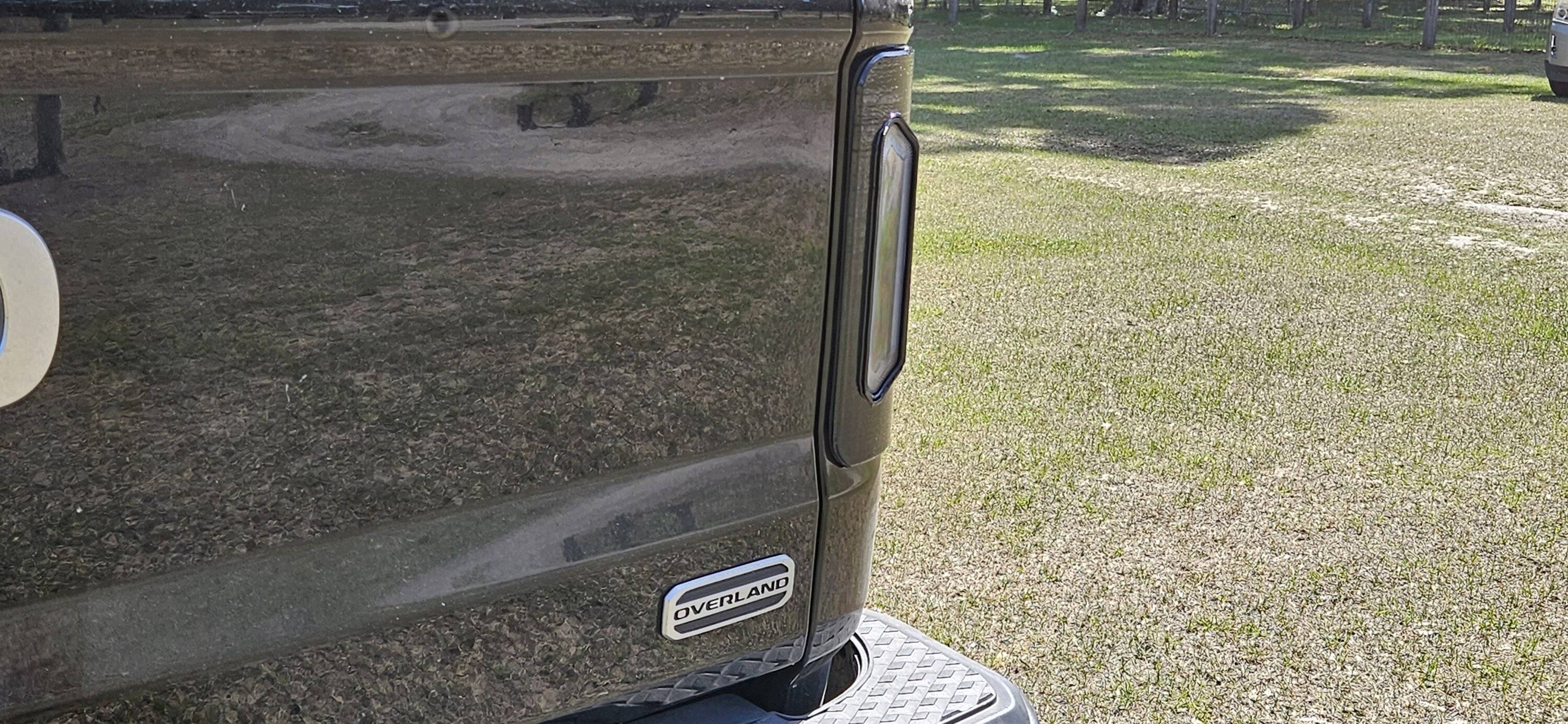

There's a chance I might. Might even give the files away to everyone to print their self. But last time I did that, people started selling them.
At the moment they are bolted in with the two bolts like factory, and I made the rear slip into a grove I designed. Might rework this but I actually like it.

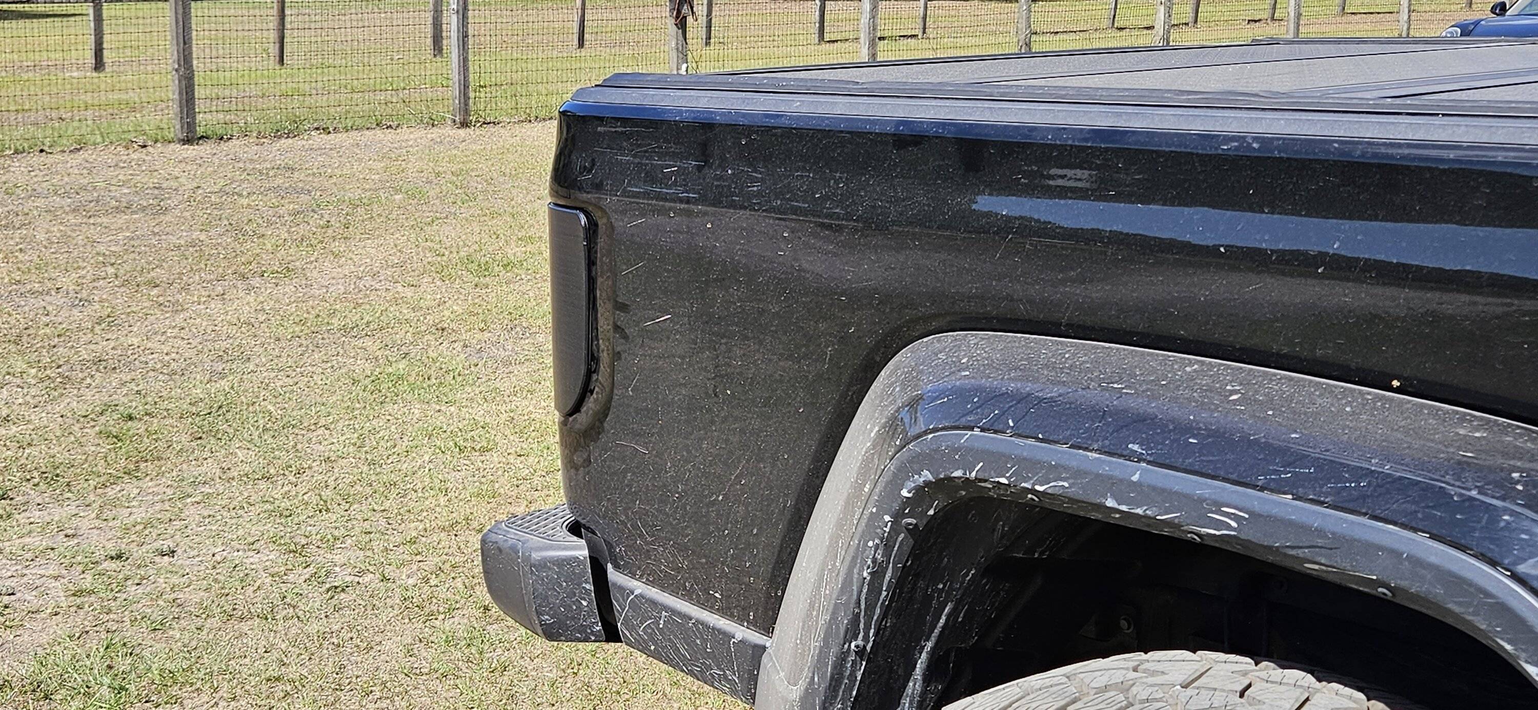

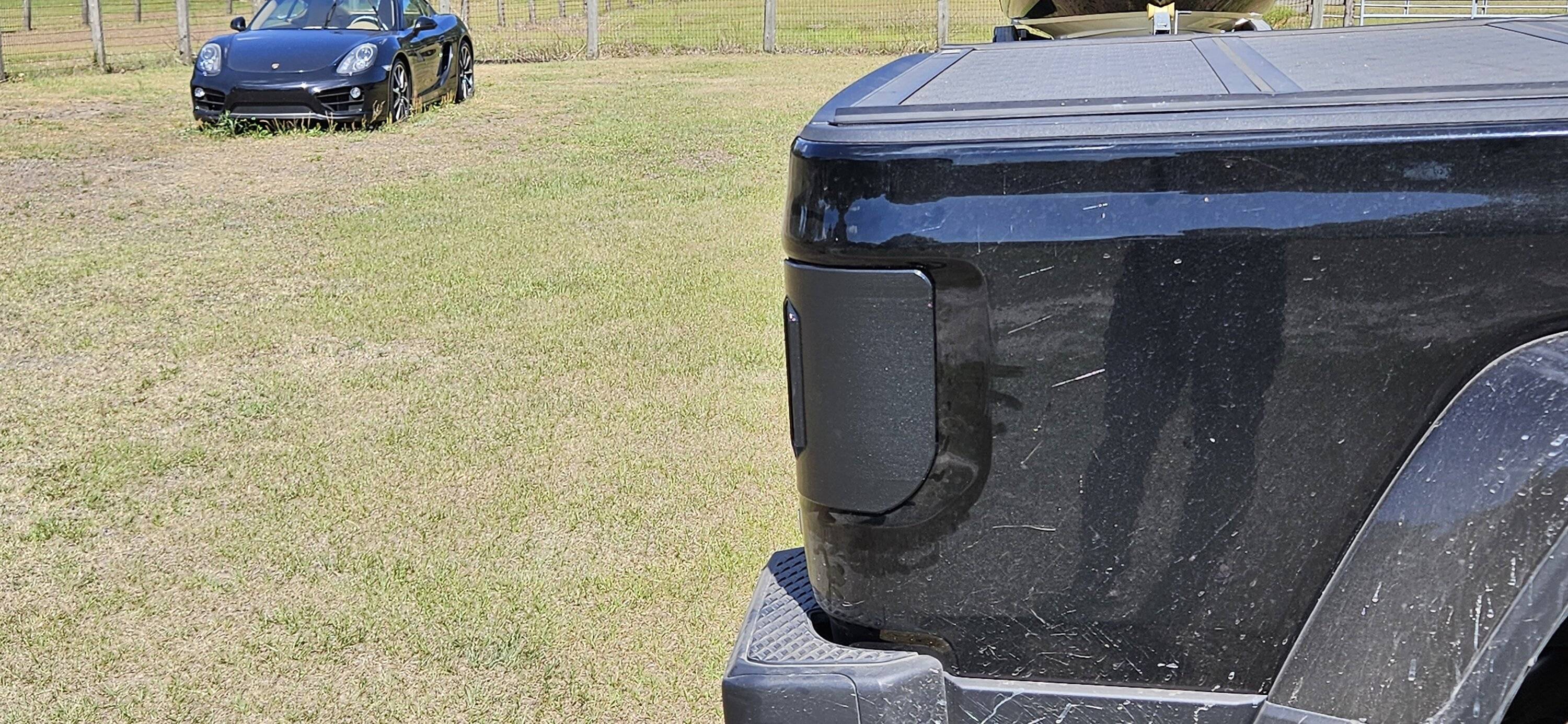

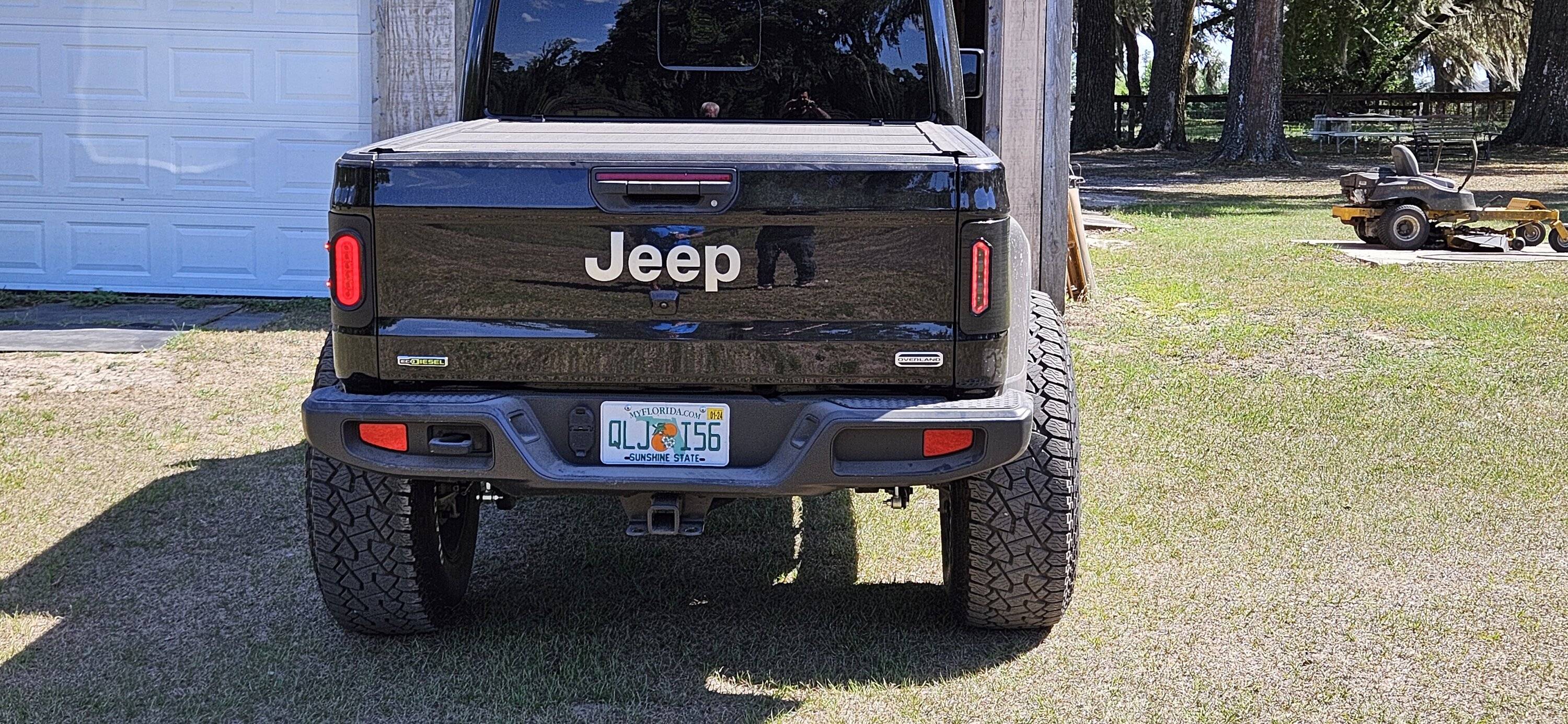

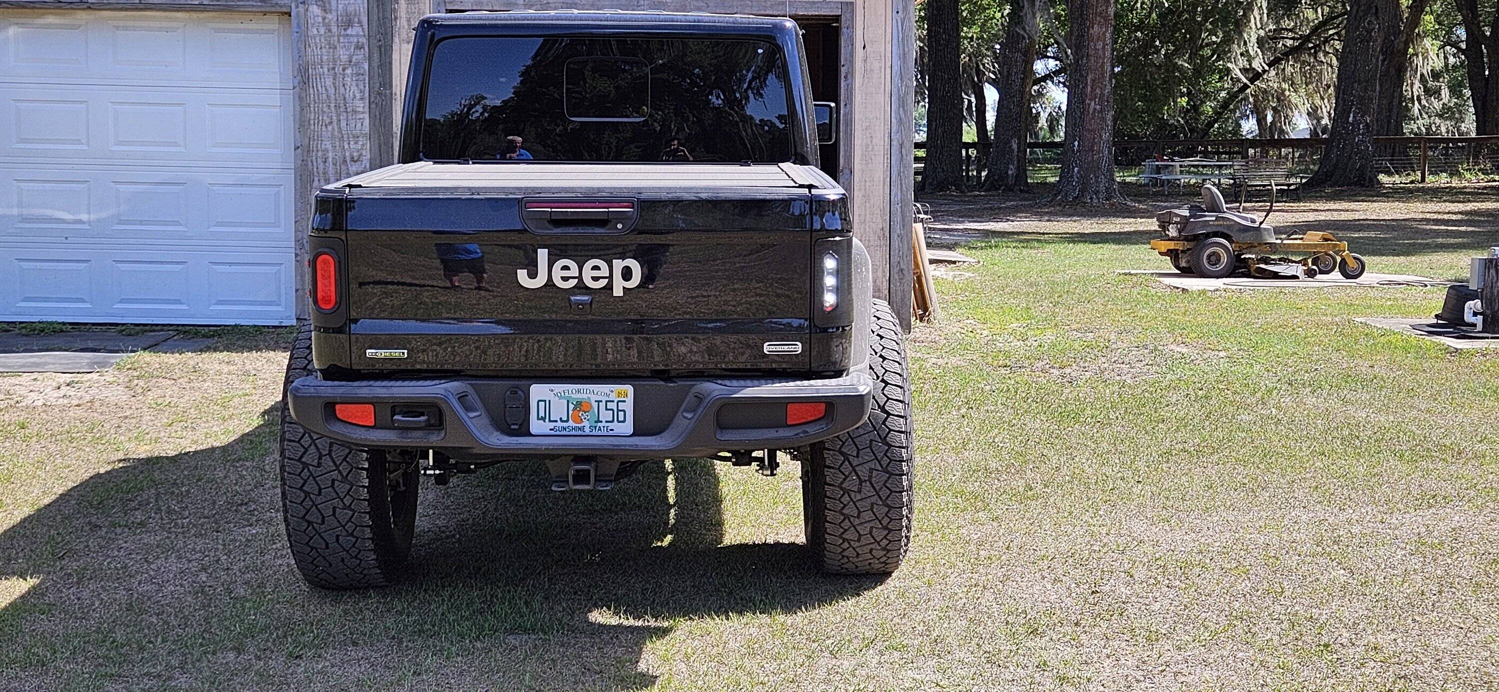

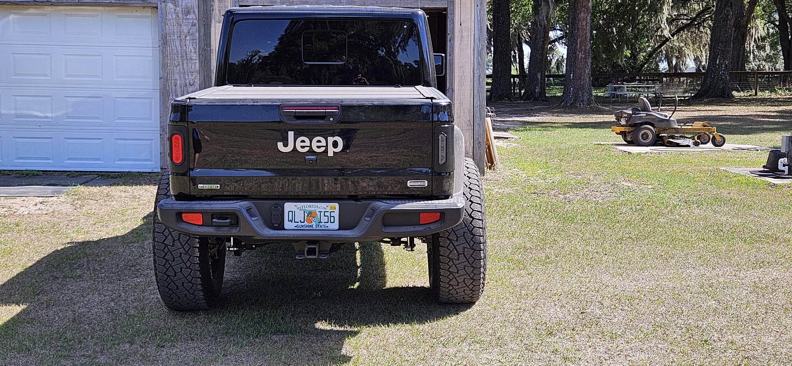

A few pictures for today
The first picture , I didn't realize it but the sun had already began melting my print, so it was warping away from the body of the truck. Have to use a better printing filament like abs, asa , or poly carbonate .
Really like the look on the passenger side. Can't wait to see it come to fruition.
