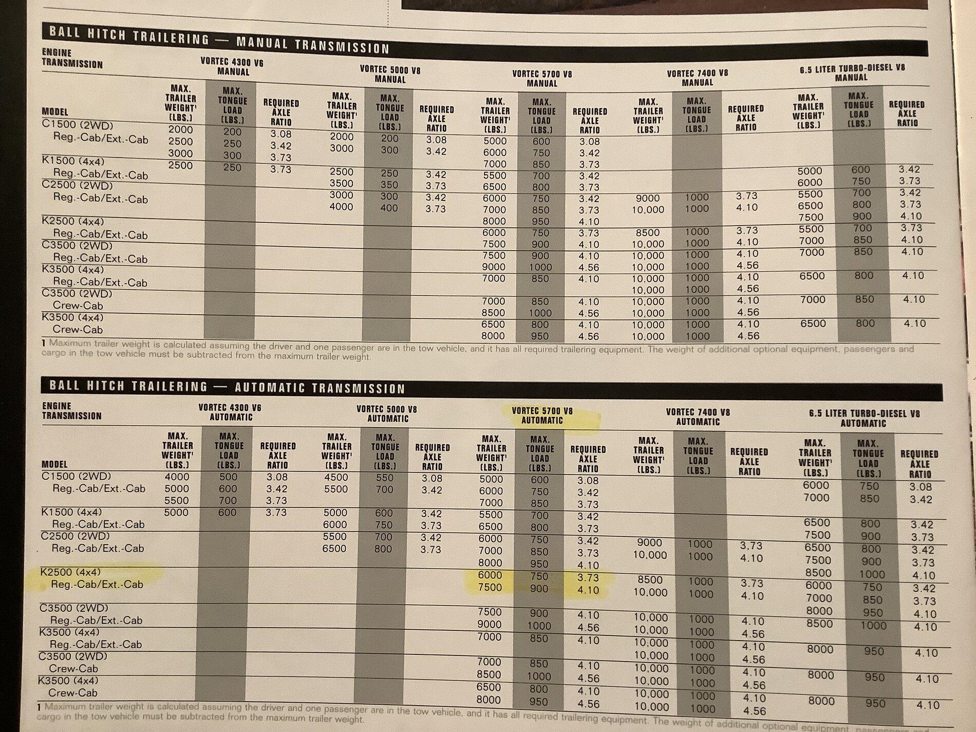

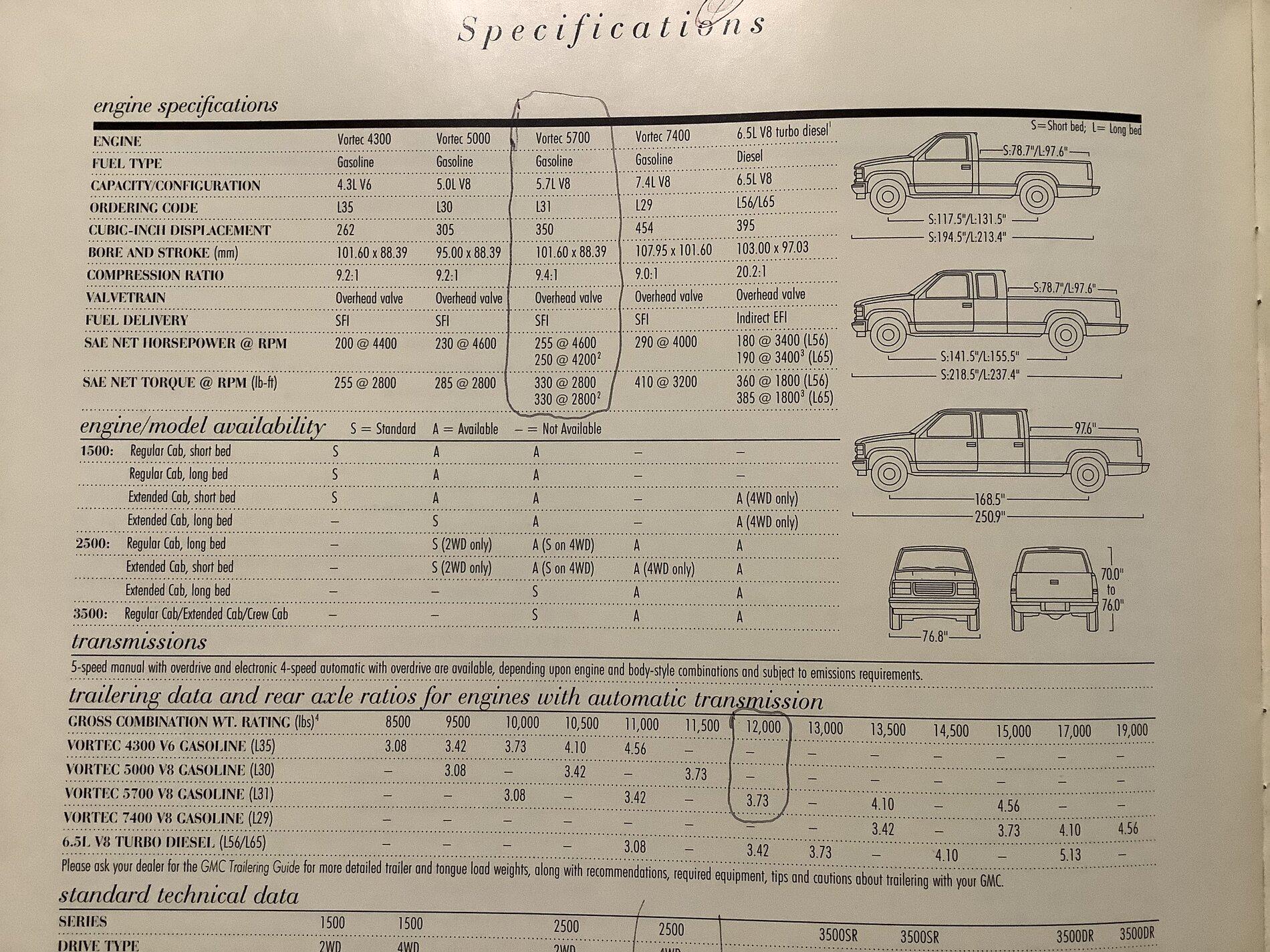

I’ve been following this thread. And I want to share with you guys how far things have progressed since I bought my first tow vehicle. I still have my sales brochure of the 1997 GMC K2500 With a 5.7L V-8.
255 HP and 330 lb/ft of Torque.
6,000 pounds tow rating with the 3.73 axle ratio,
7,500 pounds towing with the 4.10 gears.
