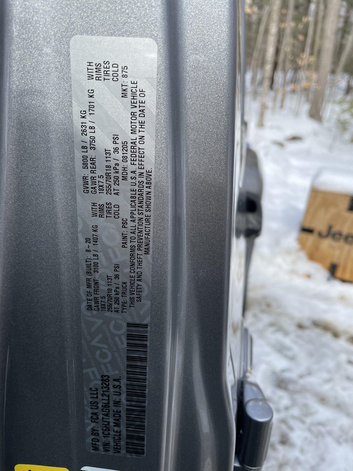

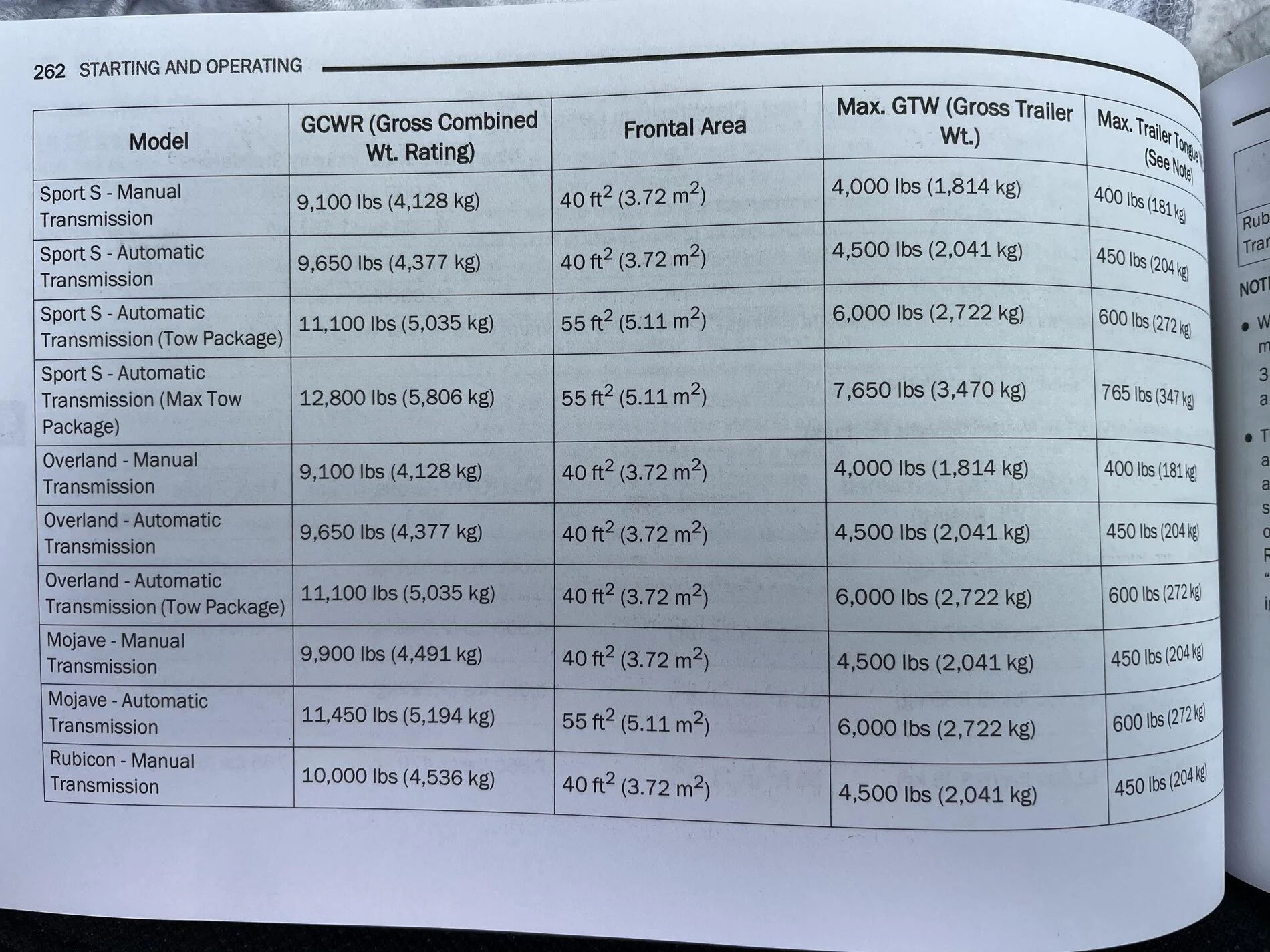

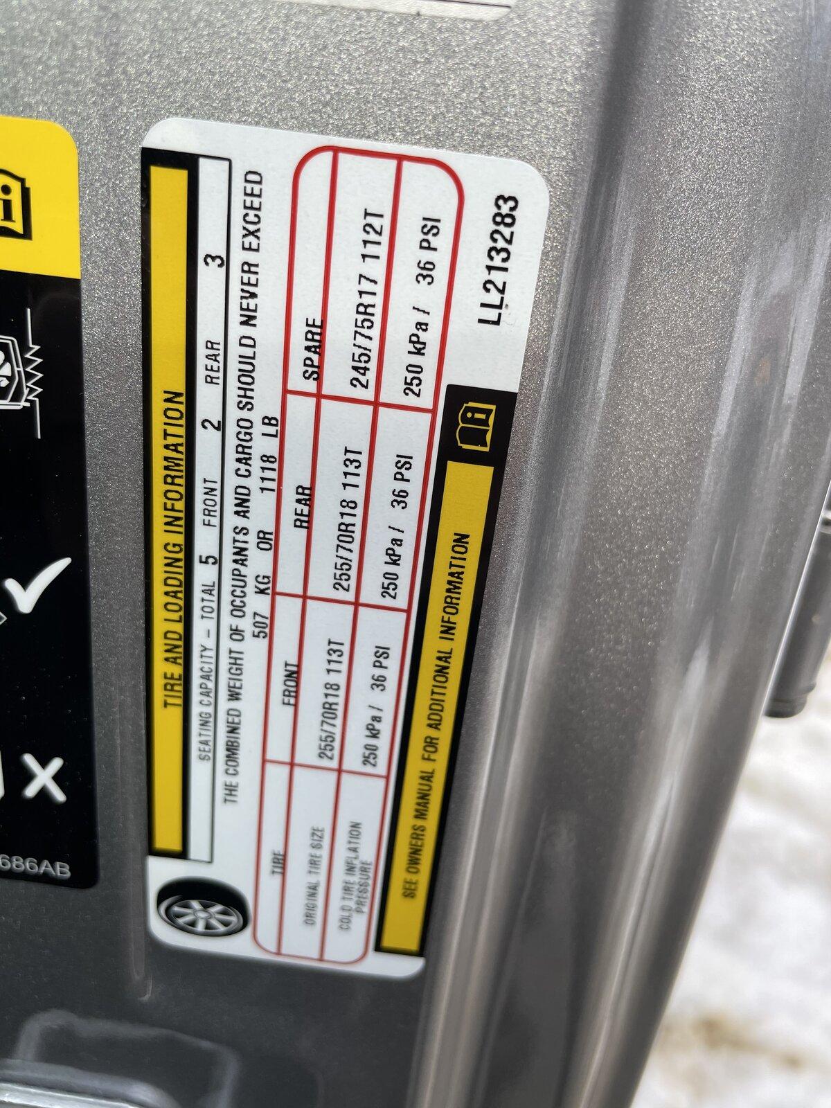

So...in addition to this I called Jeep directly. Right on, with the trailer tow package it is 6k with a tongue weight of 600lbs. I couldn’t get an answer on what the trailer tow package adds to the rating but naturally one can deduce 1500 lbs. the salesman said it had to do with brakes etc but Jeep told me that any warranty repair would be based on the manual which does clearly say 6K and yes the authority is the book. Thanks for the help all, I’m anal about my vehicles and I do not plan on using this to trailer all the time but hauling a two bay horse trailer with a big animal in the back is a feat I would like to do on occasion in addition to getting hay as well as hauling my light duty covered 6x12 with my CanAm and want this beast to last. Also having the 10yr warranty will help.
