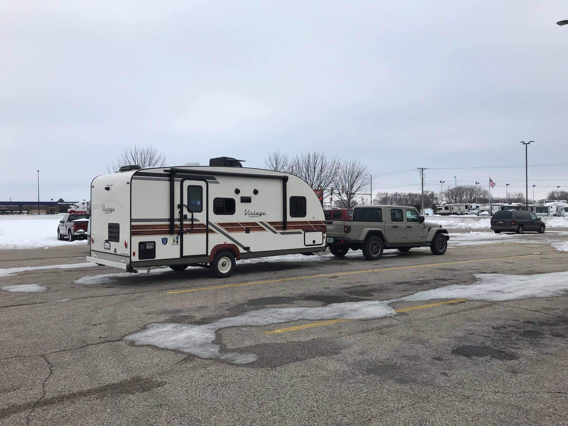

Last fall we ordered a a Gulfstream Vintage Cruiser 19CSK. 3,400 pound trailer (23’ including the trailer tounge). Our Jeep dealer installed the MOPAR trailer brake controller. The RV dealer installed the Equalizer weight distribution/sway control hitch and set it up for us. Mid January towed it home dry 600+miles at 60 to 65 mph with no control problems. Gas powered Overland with a tow package. Loaded we will still be well within the towing capacity of the Jeep.
Jeep Gladiator Can we talk JT Normal Tow? 275272C9-F9FE-456C-BF17-1EB6BC13A672

That’s a great looking trailer!

Just bought a 3452lb Jayco Jayflight184bs Baja. This was helpful, thank you.

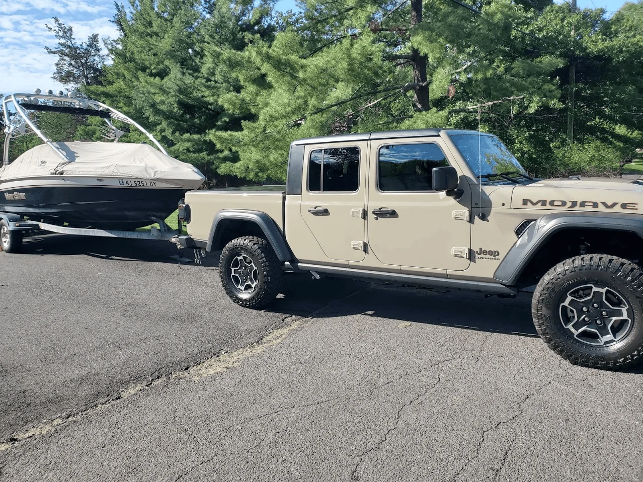

I tow my 5000 lb boat with my Mojave and it does just fine. It's not going to win any races, but it gets us where we are going! Take your time and accept that you're hanging out in the right lane. Way less stressful that way!
Jeep Gladiator Can we talk JT Normal Tow? 1614020054028
