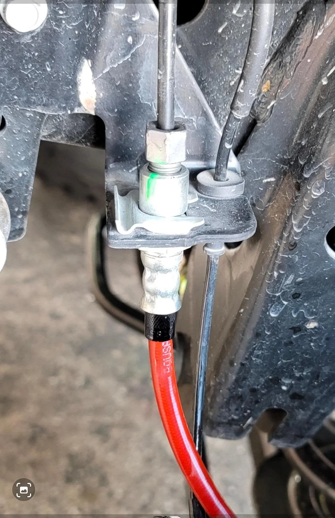

So of course I go to pull out and start working on the tires and I see a "brake" light up on the dash, which i assumed was just the assist turned on from my taser; Nope it looks like my brake line broke?... I look under the truck and just see fluid everywhere. I didn't notice any tears in the line so not sure how to go about diagnosing it and of course its 5pm on a Friday now so I can't take it to any shops. Any ideas on what could cause the leak? Something loose or over tightened? It looks like it lines up with the paint mark they made...
Where is it leaking at? At where the metal tube screws into the fitting? Or where the hose goes into the crimp? Fill the brake reservoir up and and have a friend press on the brake pedal and you watching that area for leaks. If it's leaking where the metal tube goes into the fitting. You can tighten that up yourself. If it's leaking at the hose/crimp area. you need a new hose. Either way. The brakes will need to be bled after the fix.
Thanks for the advice. It was definitely coming from the hose; I know hard to tell from that picture. I was able to take it somewhere this morning and they confirmed it's a leak and it needs to be replaced. I just went and ordered a new one from Clayton's site, but I have to say it's a bit unnerving knowing the line didn't even hold up for 500 on road miles... @Clayton Off Road Is this a common problem you've heard of with the brake lines?

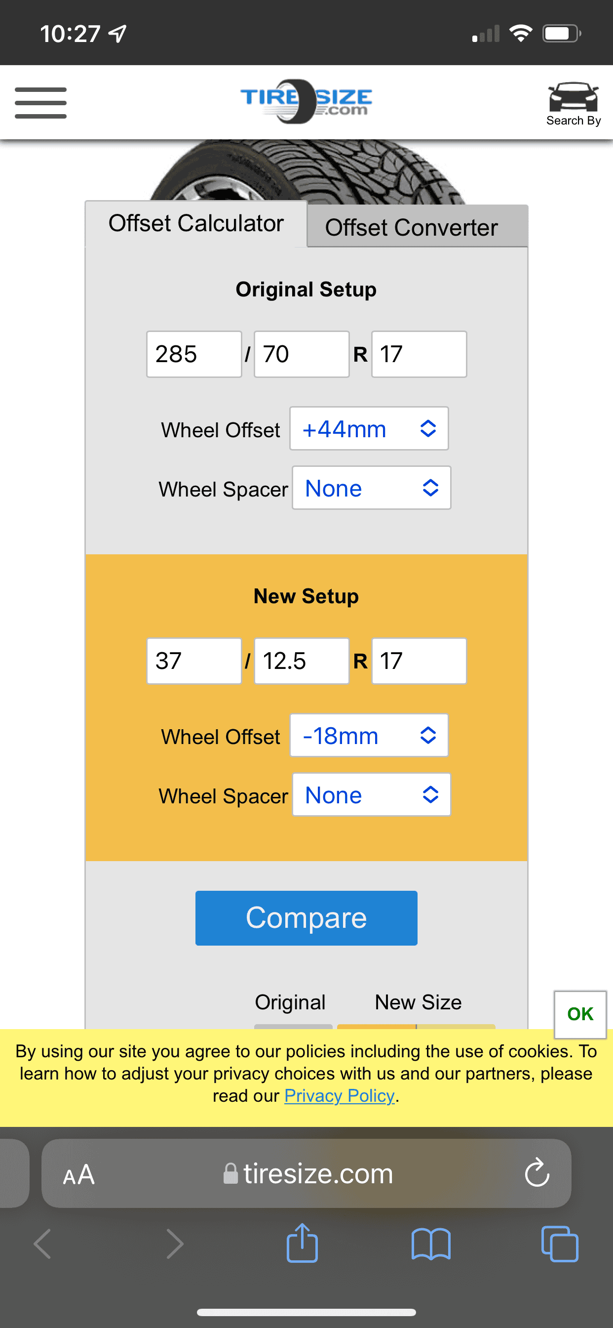

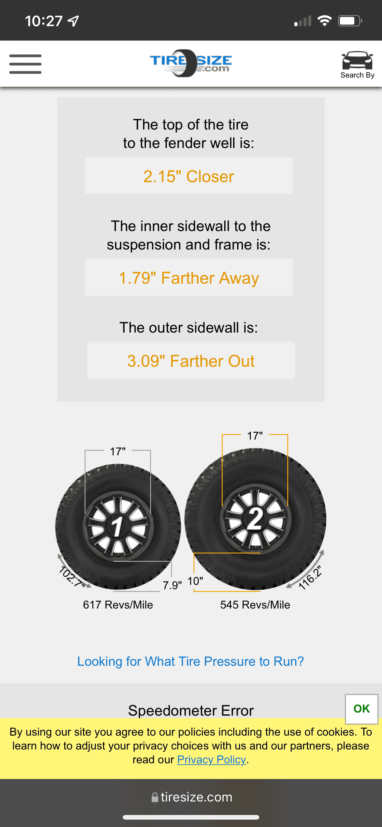

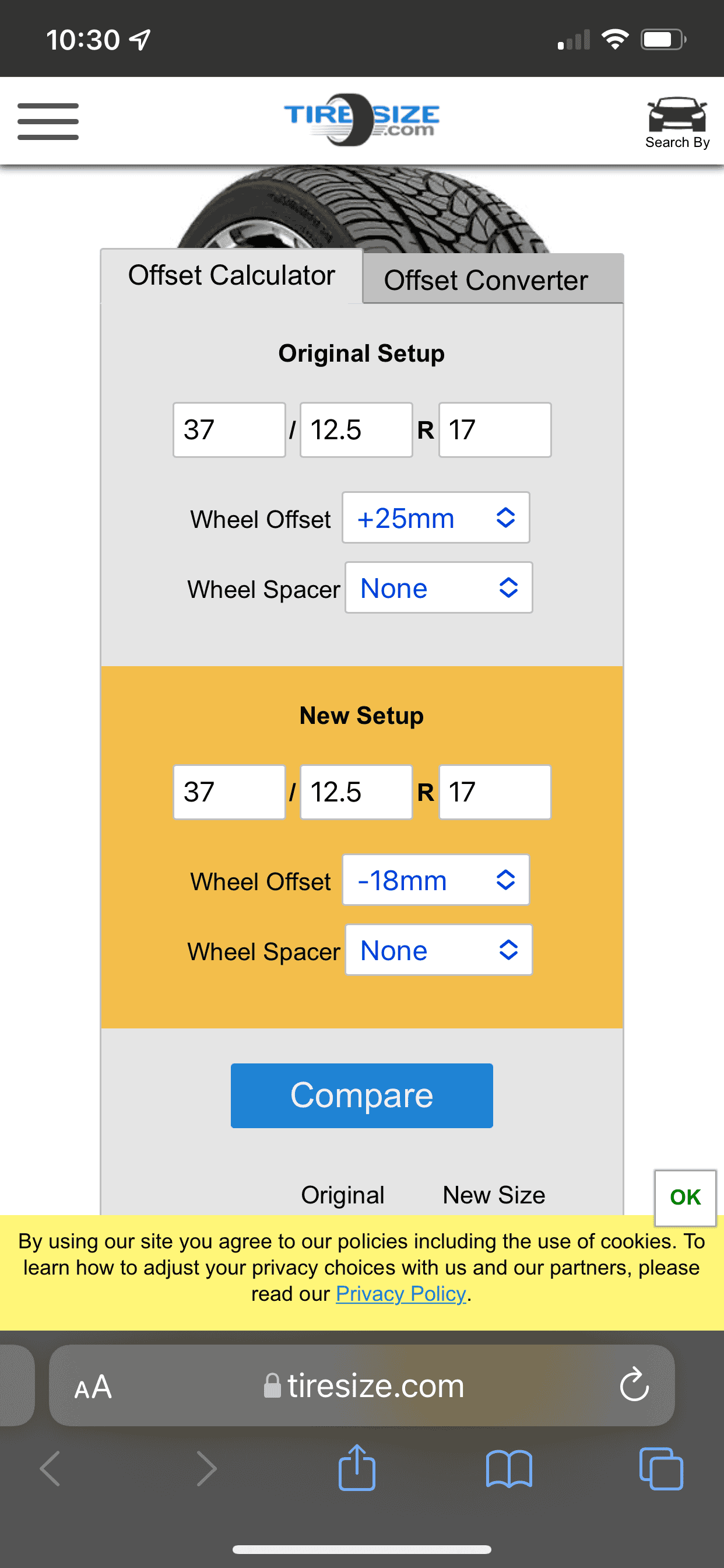

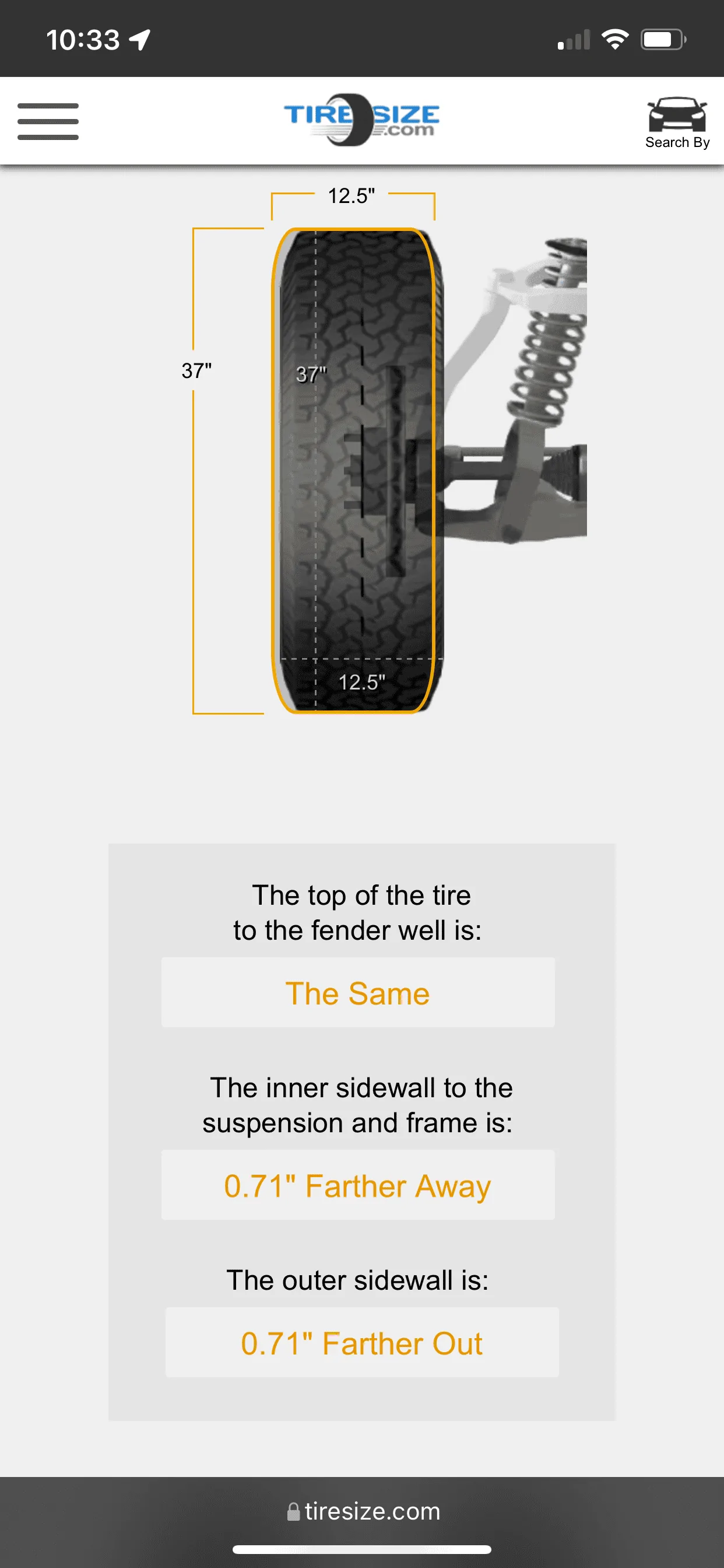

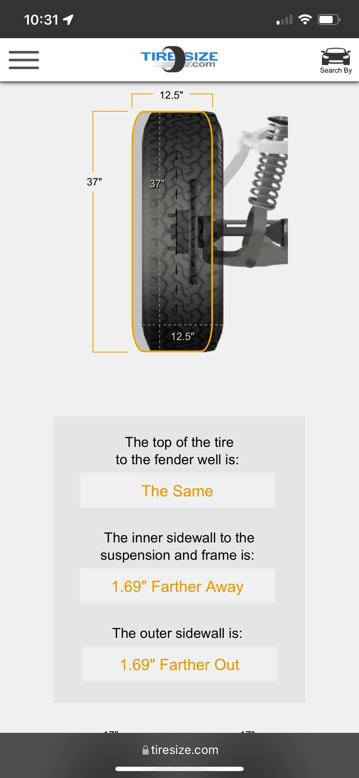

My money is on the negative offset wheels. Keep this in mind. Nothing good happens if your offset is too wide.
1. Wear out ball joints quicker due to increased leverage. With the stock joints it’s only a question of when, not if. With -18, you’ll visit that expense quicker.
2. Increase your scrub radius
3. At highway speeds the drag from your tires can cause a toe out condition. Dynatrac or Eddie with [Banned Site] has a great video on this.

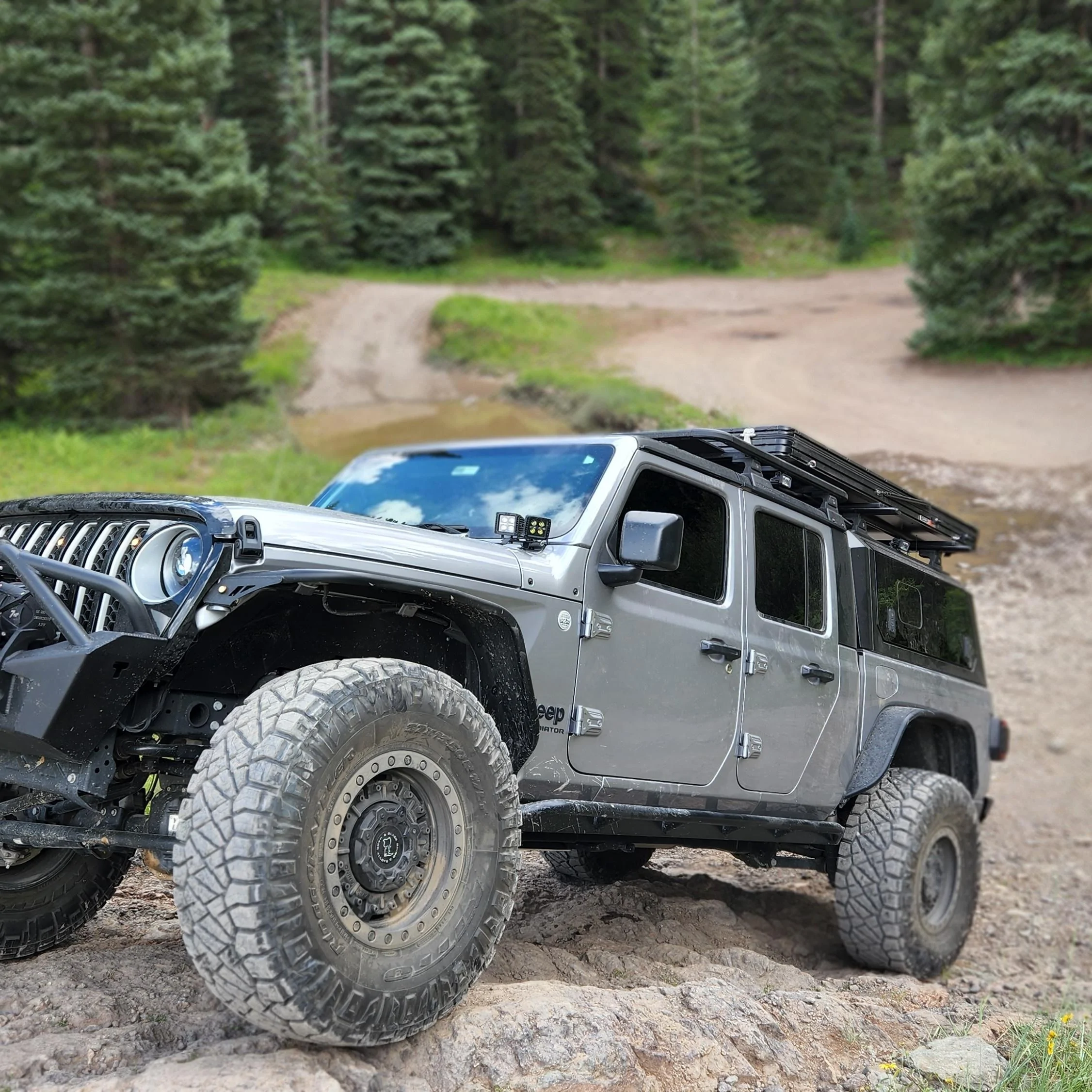

Same backspacing only they are abrahms. I have run 38s patagonia and now 37x13 nitto. Never had an issue that he described and I'm only on the mopar 2 inch lift.
