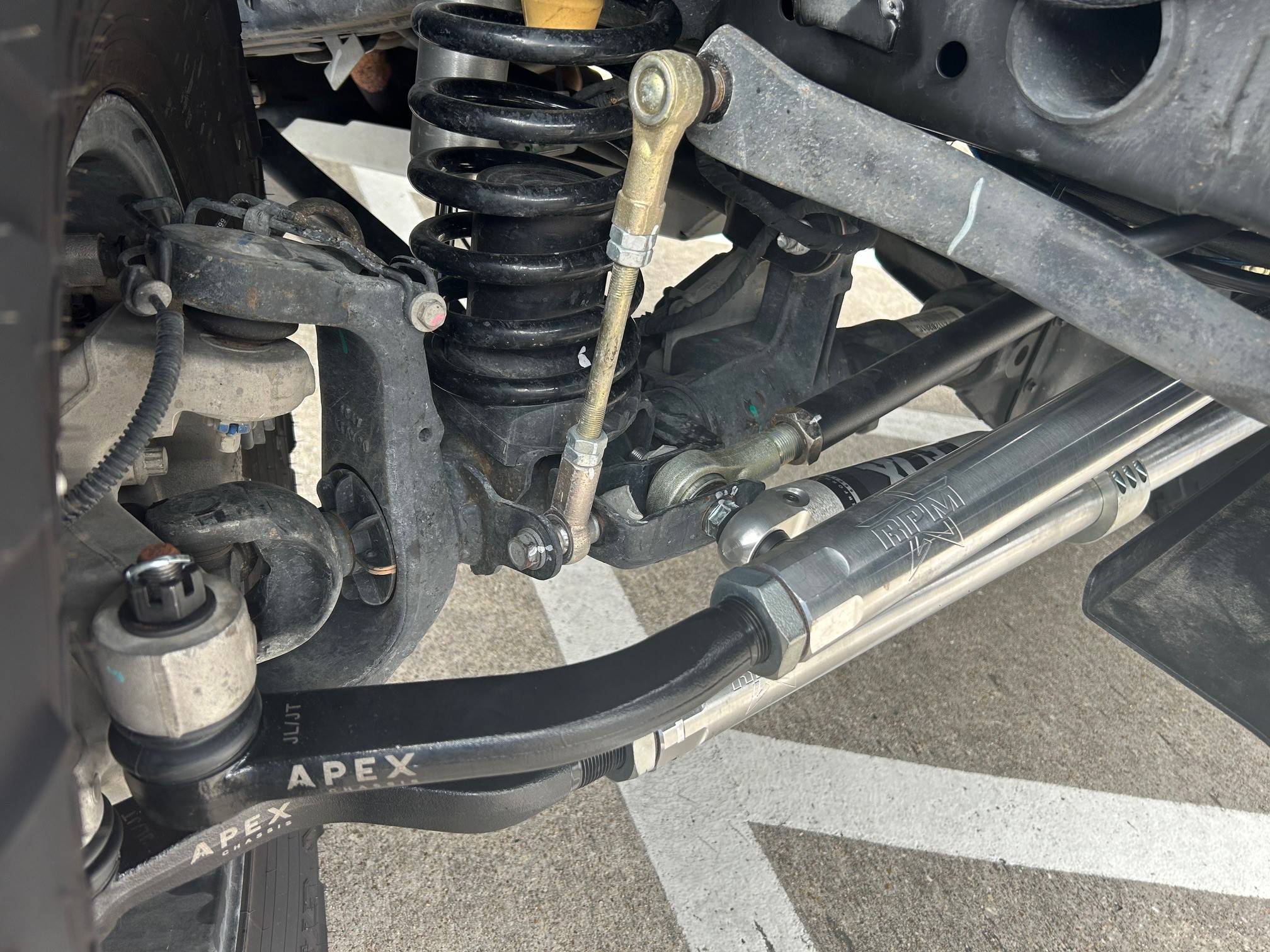

A bit of a resurrection here, but maybe it can help. See my sig for my setup and it is very similar to yours. I would not say it was a 'problem' but on a rough road, it was two hands firmly on the steering wheel for sure. On the highway, at 80mph, it took some effort to keep the Jeep inline, which I expected with about 5" of lift and 37s.
Two weeks ago I installed the Apex 2.5 ton steering kit and Fox stabilizer with the power steering booster pump. Talk about a night and day difference in drivability and serious beef. 80 mph with one hand on the steering wheel, parking lots are much easier, backing my trailer and maneuvering is much better and the Jeep is noticeably more stable in all driving situations. Overall, I would stack it against a stock JT"s driveability or better.

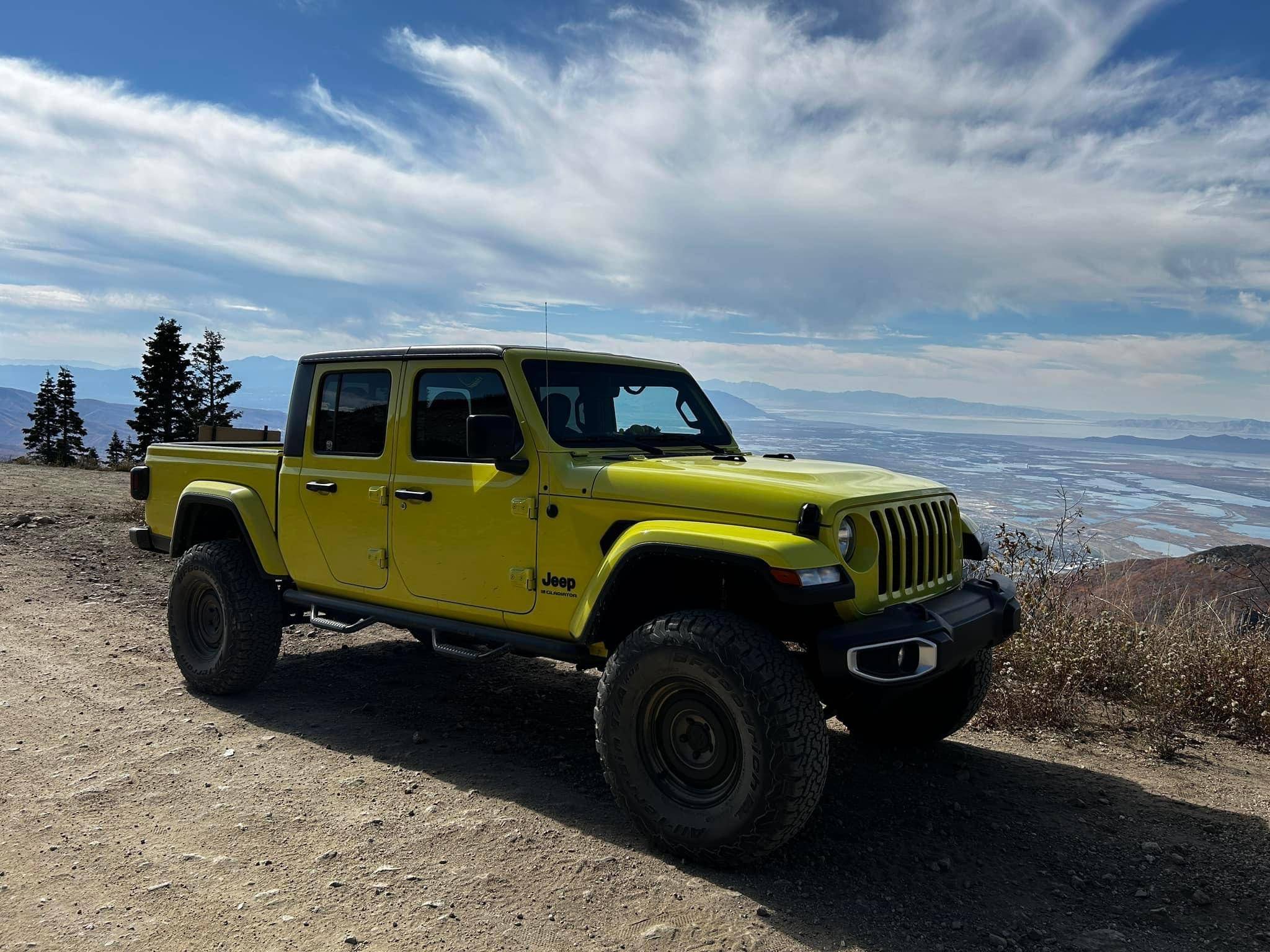

I am running the same Clayton combo with 37’s. I did not upgrade my tie rod or drag link, wheeled a JL for 70,000 miles on 37‘s with stock parts and no issues, the issue is most likely something is over inflated under inflated, not torqued correctly, not aligned? I can do 80 mph no problem with mine.

I know this an old resurrected thread and I hope the OP has resolved his issues.
The one thing I'd add for others that stumble onto this thread with a similar issue, and I don't believe it was ever mentioned in this thread, is to check the angle of the draglink. When you start getting into those bigger lifts, it can really mess with the steering geometry. And while I know this thread talked about beefier steering components several times, it may be that a draglink flip is in order to bring the draglink back to more parallel with the tie rod.
If the OP @jwoz is still watching this thread, maybe you could post a pic of that angle...
