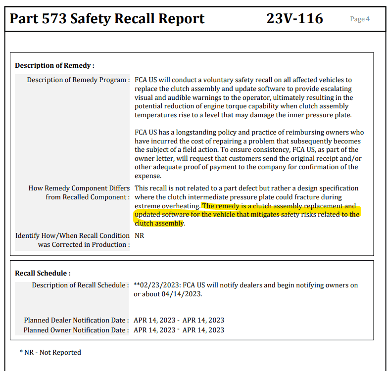

Really curious to hear what the actual "fix" is
Yea good point. My "new clutch" talk was really speculation based on wording in the recall but there is no remedy listed and there is no evidence that from the produced vehicles that they actually changed any hardware before making them. The only thing we can say is that there is likely another software change at the very least and we have to hope that they did more than that because that has only been a nuisance in the past and never a remedy. The software evidence is this 2023 Orders - Check in here | Page 985 | Jeep Wrangler Forums (JL / JLU) For Rubicon, 4xe, 392, Sahara, Sport - JLwranglerforums.com
Edit: I seem to have missed the last updated recall notification which states the clutch and software are both updated
Jeep Gladiator Clutch Recall (2/23/23): Clutch Pressure Plate May Overheat -- Affecting 70,000 Manual Jeep Wranglers and Gladiators 1689276736619
RCLRPT-23V116-8530.PDF (nhtsa.gov)

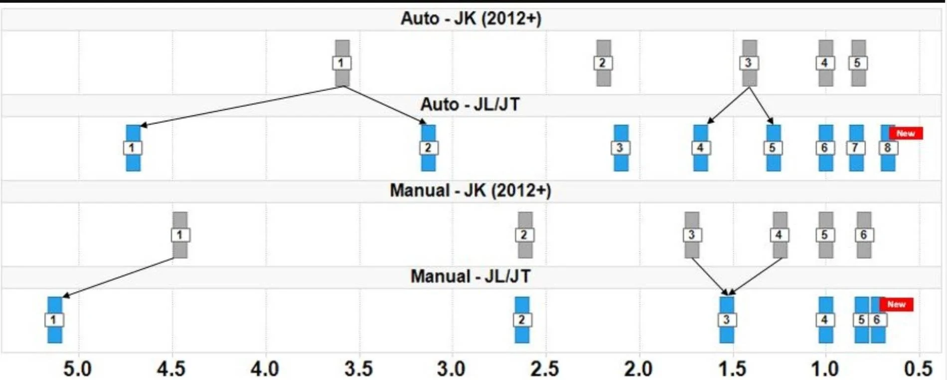

What i find interesting is the position that 4.10 would make things easier when one of the most common complaints of the gearbox (not the clutch) is that 1st gear is too short.
Simply stated, double disc setups don't allow for feathering. Either the clutch is engaged fully or it's not engaged at all. Smooth take-offs from a stoplight? Nearly impossible. Stop and go? Towing in reverse? Be ready to hate driving
I agree a traditional clutch would be better. But the idea that this clutch is on or off and cannot be feathered is just wrong. Sure, the JT clutch has a smaller window, but it's nothing a little experience doesn't fix. Smooth take-offs are no issue. Stop and go? I work in Philadelphia. Stop and go was my life. Dont even ask about those 12 days where 95 collapsed.
Towing in reverse? Okay yea, that would be a nightmare. Reversing up a gravel incline sure is. Reverse is way too tall.

4.10 is easier than 3.73 from a stop. Torque as the axle is going to be higher all else being equal. That's what I was referring to mainly. The first gear thing is preference I suppose. I've always had close ratio sports cars before the JT so I only used 1st to get moving from a dead stop. I once had a car buddy, after having ridden with another friend and then with me, ask "why do you and Chris shift out of 1st so early"? Preference I guess. 1st isn't so short, 2 and 3 are just tall as crap comparatively. Edit: see chart.
Jeep Gladiator Clutch Recall (2/23/23): Clutch Pressure Plate May Overheat -- Affecting 70,000 Manual Jeep Wranglers and Gladiators 20191009_224034
And the contention isn't necessarily the clutch is impossible to modulate or feather, it just requires a lot more of my attention than any other car I've owned by a LONG shot. I'm used to starting in 1st with clutch only so the JT requiring 1000+ rpm during clutch pedal release is just annoying as hell. I think this is where most of us complainers are coming from. It could easily be just a standard clutch that we're all used to but for some reason, FCA decided to go with a full on moron design in 2018 thats on recall #3 now.
