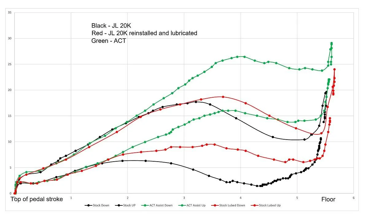

Let's see if this graph answers that for you. These are actual pedal tests done at ACT.

I think it does? At least show it stays nominal after the actuation point which is good and predictable. Personally I don't fully understand this graph. How is pressure (I think we are measuring pressure) measured. Both up and down. it the left measurements PSI, or ft/lbs, in/lbs? is the bottom inches of travel, mm, cm, just placeholder numbers? I can gather, stock is very soft, I cant tell what up from down stroke is though. I can also gather ACT is linear in force with a nearly flat plateau after grab point compared to more exponential of a wave with stock and drop off after grab. Maybe you could explain better?
The travel is measured in inches from left to right. The scale top to bottom is the effort (load) it takes to press the pedal measured in pounds. The higher curves are when you are pushing down on the pedal, the lower curves are the return force against your foot as the pedal comes up. Can you see where the stock (black line) pushes less that 2lbs on the return stroke? That is what I mean by awful.
Okay so I did understand it. Pressure going back is a good way to explain and I get it now fully. ~2 lbs on return is actually horrible, totally get why my wife thinks its "sticking to the floor" compared to the JK
