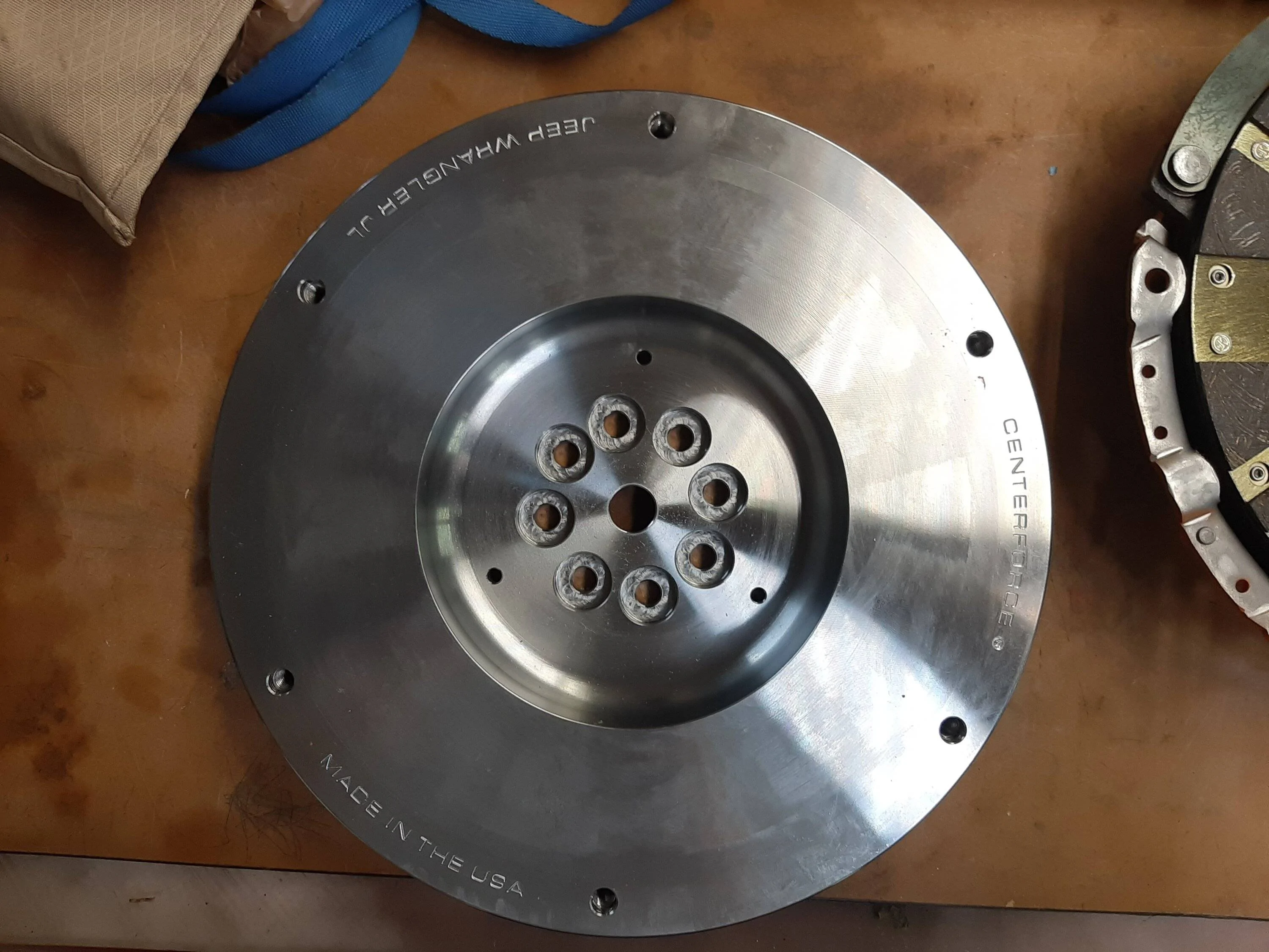

So people with the centerforce, single mass one preferably but either way. Does their clutch have like 5-10 degrees of rotarional play like the OEM one does, or is it a solid unit?
the CenterForce Flywheel is a one piece solid flywheel. I added a picture of the flywheel.
LOL. I literally just laughed physically out loud with how much better that looks. Im thinking I'm gonna save for the CF single, and if the recall is a new clutch but its trash, I'll just put that in instead. No one tell FCA:LOL:
