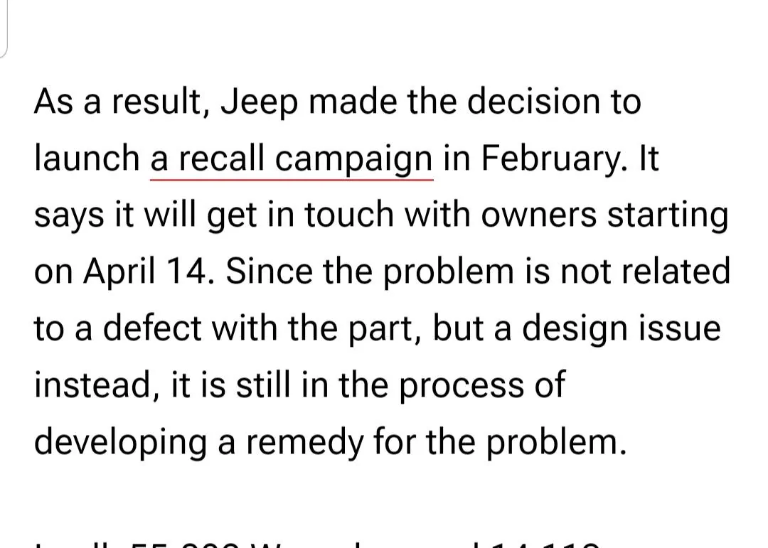

Wow, they admitted it's not the clutch part itself but a design flaw. Wonder how they're going to fix the issue now.
That's almost a contradiction. Maybe they are saying the part was made correctly and there isn't a manufacturing defect, but Jeep designed it all wrong.
To me the remedy is to replace the whole clutch with something that will handle the torque.
The design of the stock clutch is the problem, not a manufacturing defect!
Replacing the clutch with aftermarket certainly solved my overheating issues.
That's the way the text quoted above reads - the part is fine, it just won't work for the intended use.
I've recently seen images of two Jeeps that have had both recalls have mega problems. One busted the bell housing, the other caught fire and burned to the ground.
It's made correctly, they just made it too small and light?
To elaborate (it's what I do...), the OE JL/JT clutch is a dual disk design. It's supposed to have some advantages in terms of feel, holding power, and required pedal pressure, but doesn't dissipate heat as well. In a Jeep, it just isn't the best choice. The "aftermarket replacement" changes the whole package to a conventional, single disk unit with a heavier flywheel. It is much better suited to off-road operation. Shame on Jeep for clinging to this poor choice, and shame on them for not offering the 4.88 option on the JT.
I think you walked your self through it. This means that replacing them with the same design will not fix the issue. There was a recall on some cherokees last year, Trans cooling line rubber section was recalled due to a bad batch from goodyear. This would be an example of the design being fine but a defect casuing the recall. An example of design being the problem not the manufacturing defect would be the first recall in Model T's. The stuffing in the seats that they where designed with was the defect, not just a batch of the material.
