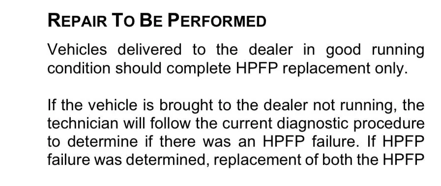

Well, part of my question is that for them to determine if it is contaminated will that involve looking at the oil filter? Is so, that gets the water drained for me free. I'm also wondering if they will pull the filter to look for metal, or if they'll have a different method? If they pull the filter, if they cut it open then that means a free filter as well. I was just hoping to hear from someone that had their pump replaced under the recall where their vehicle was still running. It'd be good to know what all they did in the course of just doing the pump replacement.
Jeep Gladiator CP4 Fuel Pump EcoDiesel Recall IMG_2307
If you drive into the dealership, you get the pump. If you’re towed in, they do the existing diagnostics then you maybe get everything. I don’t know if this implies that the engineers believe that a pump that has begun shedding material will immediately cause symptoms or Stellantis doesn’t care. Like you I’m concerned that there could be contamination in the fuel system from the existing pump that hasn’t reached some critical mass but it’s just supposition that this situation can happen. Maybe they only fail fast and hard. I plan on having my dealer go ahead and replace filters even if it’s on my dime. I’m hoping the tech can look at the outlet of the pump for signs of metal buildup. If it can fail slowly, it might be obvious that there’s light metal dust on surfaces.
