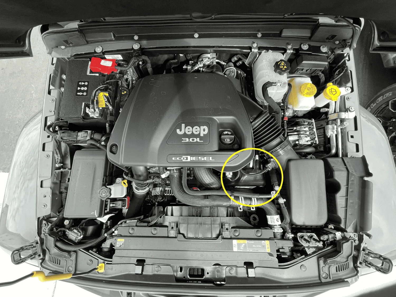

The area circled in Yellow is where the HPFP is located on this diesel :). the filter is involved because the system recirculates fuel back to the filter/water separator during its normal operation(the diesel fuel is the lubricant for the HPFP) and can introduce metal parts into the fuel tank and lines if the HPFP is failing.
Thanks for that info!

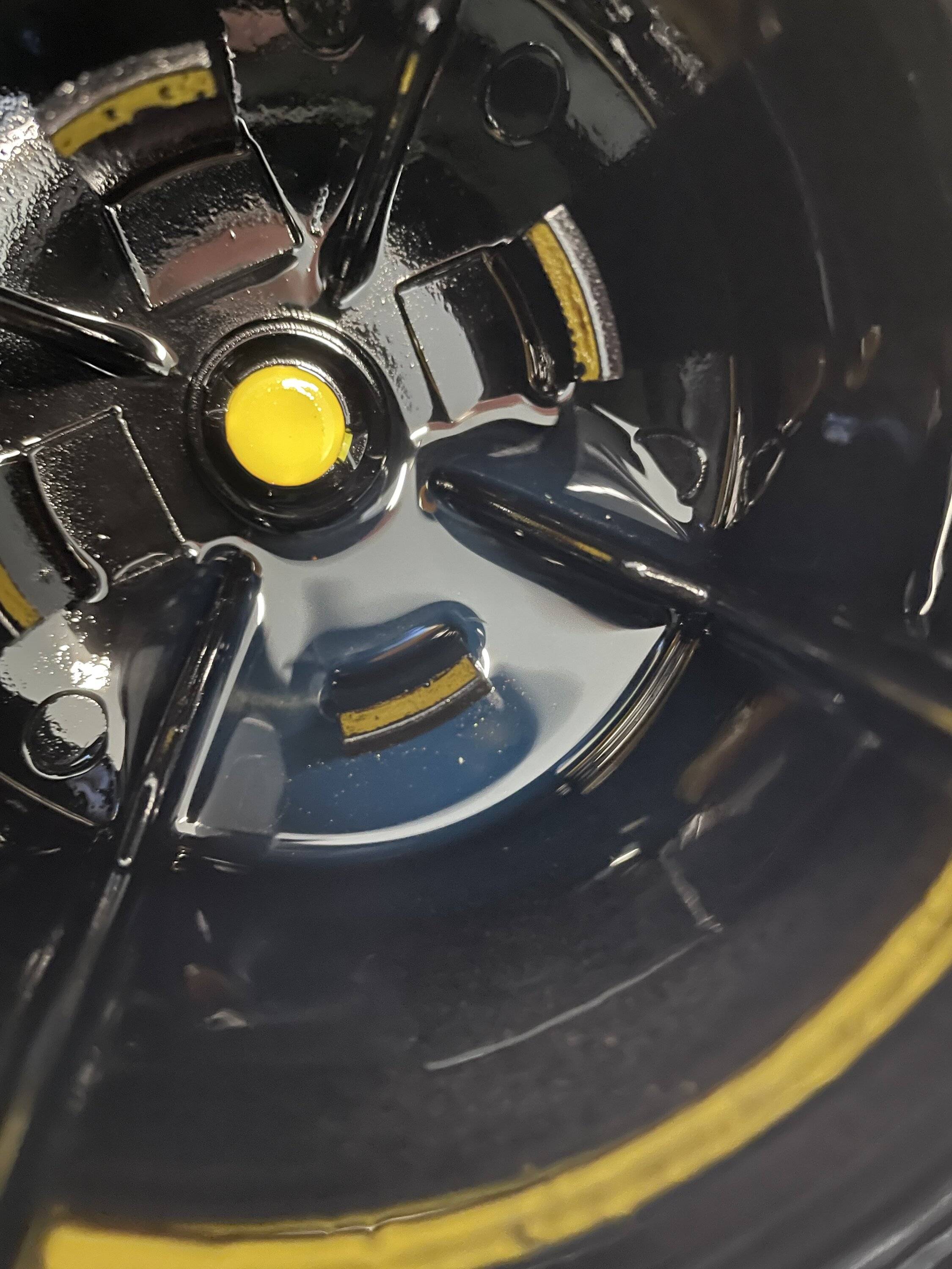

Spot on. This is what my filter housing looked like and an easy way for all to check the current health state of your CP4. Engine still runs fine, but the pump is defiantly louder (growl). Mine is in a Ram so I'm stuck running it the way it is until parts are released.

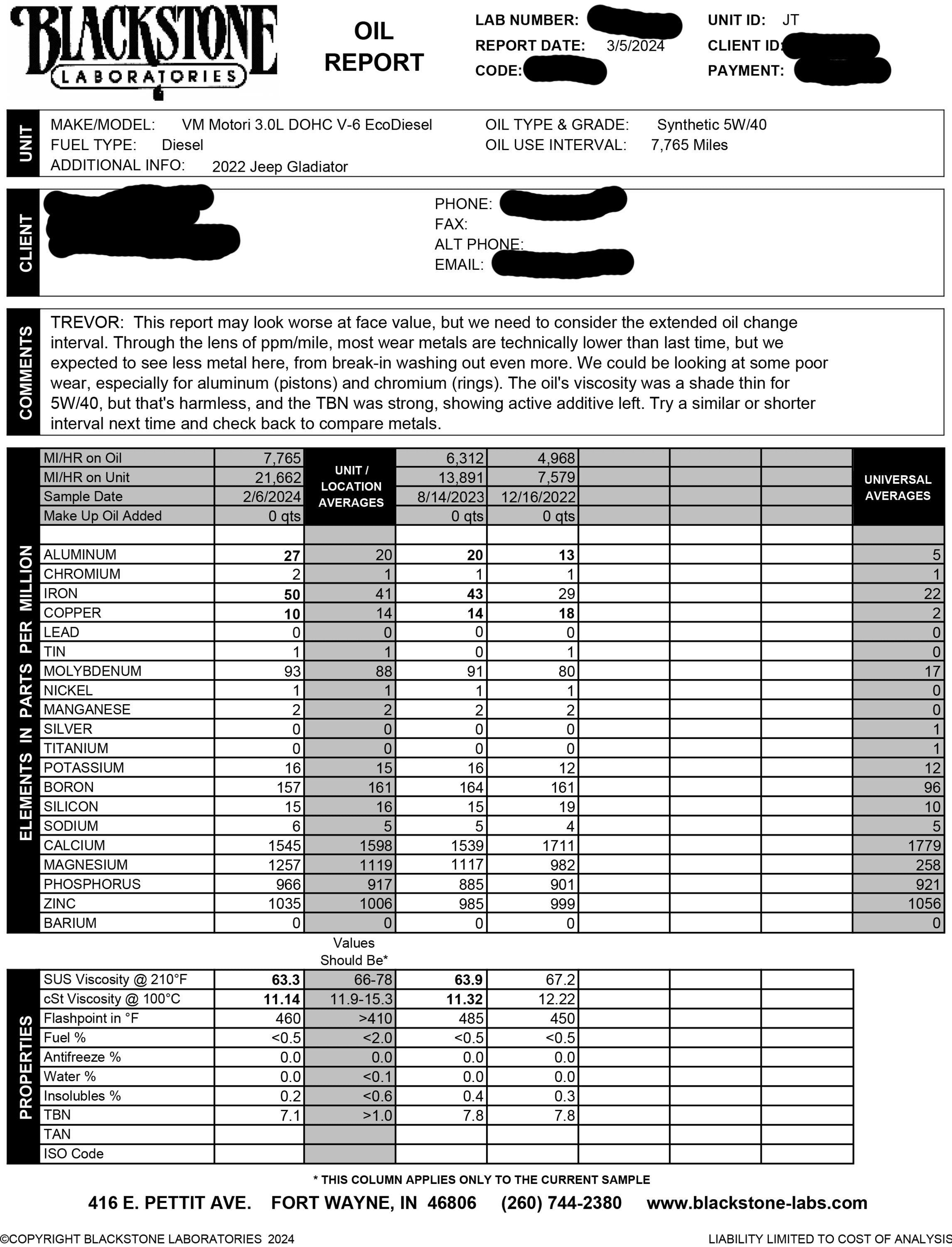

Scheduled my truck for the HPFP later this month. Going to tune that sucker immediately after I get it back.
Blackstone oil analysis has been looking like poor wear is possible.
I just want this thing to last

What did it say on the report?
Nothing crazy. I tend to let it warm up a bit longer than I probably should in the winter, although I do plug it in. I suspect that could cause the additional wear, yet they're showing minimal fuel in the oil. So either way, going to stop warming it up as long as I do, or at all.
I run EDT in the fuel and Quaker State Euro 5w40 Synthetic with Mopar filters. I also did a break in oil change at about 2600 miles but I didn't send that in for analysis. All these other changes are on the sheet.
