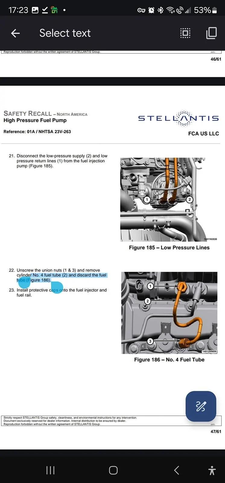

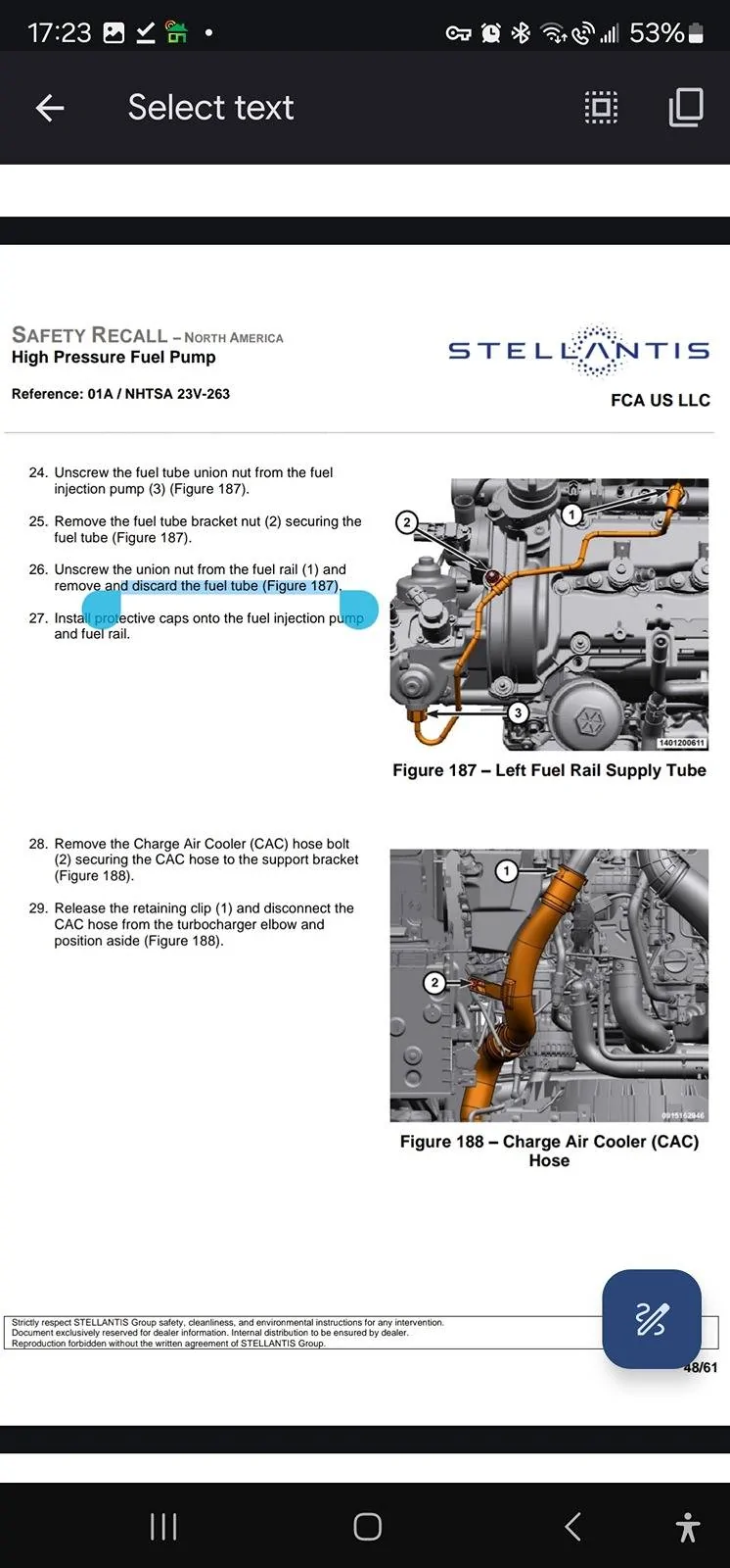

Anyone have a work order with the parts list for a non-contaminated HPFP replacement. I just got mine done and it doesn't look like they replaced the supply lines, I want to confirm the part numbers for them.
They only replace one line on the non contaminated replacement.
From the install guide it says to discard 2 lines in the steps for an uncontaminated replacement. Doesn't look like the tube part numbers are listed, possibly they are included with the pump kit??
Talked to a tech he said "sometimes" they reuse them. I can understand why as it's a bunch more to dissassemble if you replace them. But I'm out of warranty this month and it would be shitty if they start leaking a month or two down the road because they didn't replace them. There must be a reason they are one time use items.
